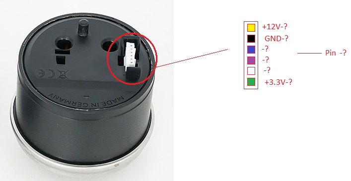

My D5 next pump controller has stopped working (died). How can I connect the D5 pump plug to Aquaero 6 lt

Its better to ask aquacomputer support for replacement controller unit.

I wrote in support. I can’t send the
controller.
I need your
help. Please describe what contacts are on the D5 pump?

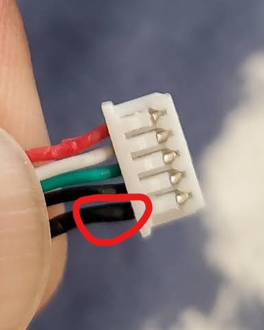

Thank you for the quick response. Are the wires really 28AWG as it says on the cable, because the last black wire is thicker than the other 4? Pictures attached for reference. My setup will include the pump and radiator away from my pc and will be less than 3m as suggested earlier by a different person. I'm just making sure of the cable requirements before I start the custom cable work.

Dont bother too much about the wires, currents are not that big. I bought JST 1,25 pre-crimpled from aliexpress (like these 5-pin ). Cut it in two, and you have two pre-crimped headers ready to solder to your USB wire extension.
