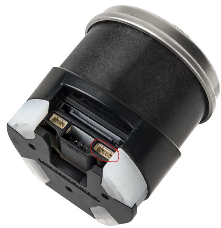

3. If I need to create a custom length cable for the USB connection, please clarify the type of connector used on the D5 Pump side. I would like to make my own custom cable. D5-Next-Rear.jpg

This is the correct USB cable for the D5 Next.
The connector on the Pump is called "Molex PicoBlade"

Also this connector may be called JST 1,25mm 5-pin (especially on aliexpress). There are pre-crimpled available, so a custom cable can be made, it should run fine being <3m long.
Yes, you can setup curves via aquasuite and then disconnect the cable. But, if doing so, remember that any controller data sources besides D5 NEXT's own water temp sensor would be unavailable that way.

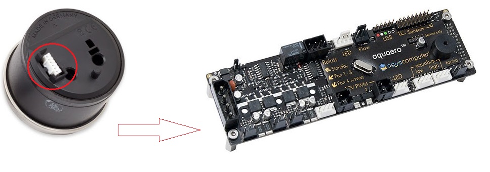

Hi! I have a question.
My D5 next pump controller has stopped working (died). How can I connect the D5 pump plug to Aquaero 6 lt

Its better to ask aquacomputer support for replacement controller unit.
Bovertru
Freitag, 22. Januar 2021, 16:24
Thank you!
I wrote in support. I can’t send the
controller.
I need your
help. Please describe what contacts are on the D5 pump?

Thank you for the quick response. Are the wires really 28AWG as it says on the cable, because the last black wire is thicker than the other 4? Pictures attached for reference. My setup will include the pump and radiator away from my pc and will be less than 3m as suggested earlier by a different person. I'm just making sure of the cable requirements before I start the custom cable work.

Dont bother too much about the wires, currents are not that big. I bought JST 1,25 pre-crimpled from aliexpress (like these 5-pin ). Cut it in two, and you have two pre-crimped headers ready to solder to your USB wire extension.
