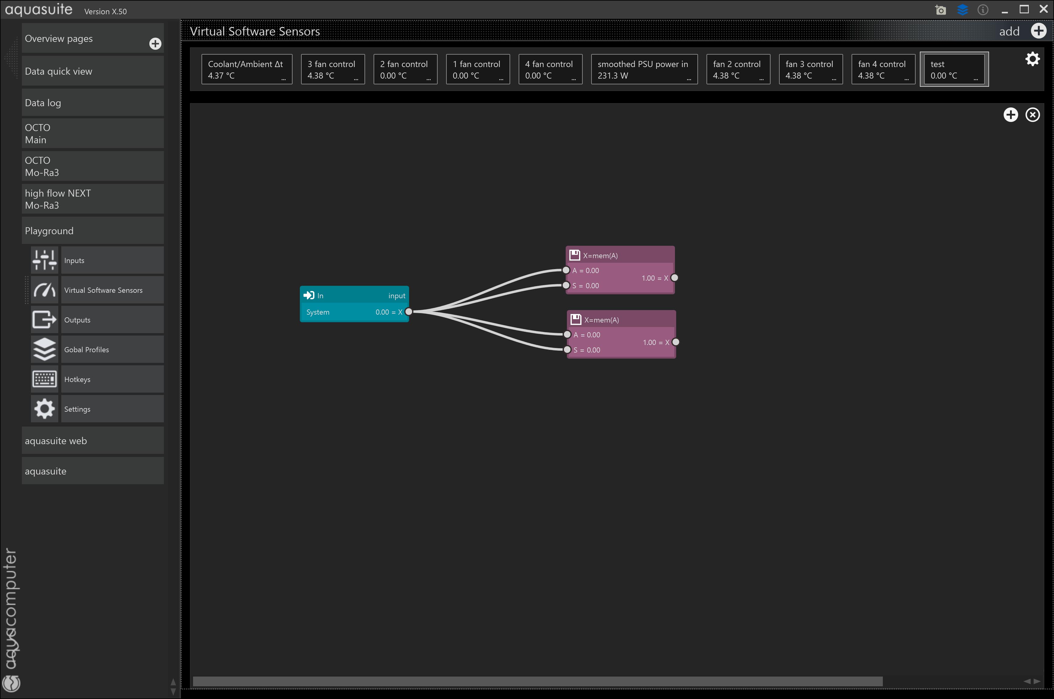

  • one input at 1 to two X=mem(A) = result as anticipated (input1-to-2xmem.jpg)
  • one input at 0 to two X=mem(A) = result as anticipated (input0_to+2xmem.jpg)
  • leave input at zero and delete one X=mem(A) = unexpected result (leave_input0_delete_1_xmem.jpg)
    the moment the 2nd X=mem(A) is deleted, the remaning X=mem(A) X value drops to 0

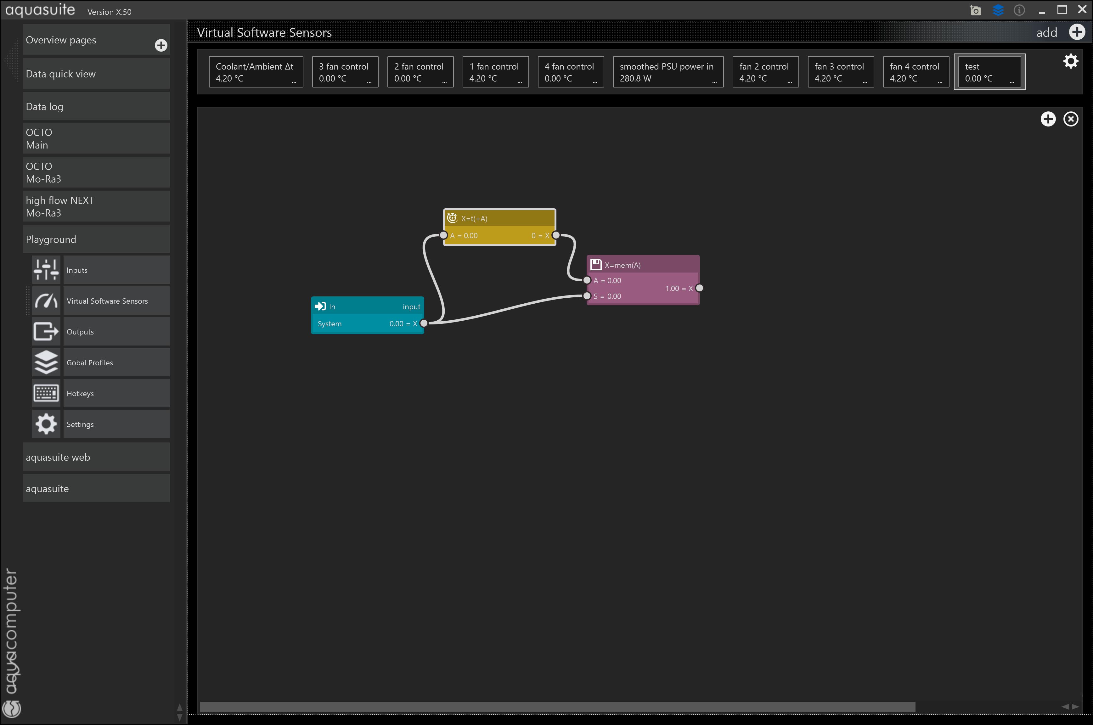

  • solution, add X=t(+A) to spoof the X=mem(A) to function as desired (delay_spoof.jpg)

i really feel the output dropping is just from altering the virtual sensor, as if AS would reset everything when a change to the layout is made.
But in normal use, nothing would have dropped.
At least that's what i saw when i was tinkering with it.

Something else I am misunderstanding: how the X=t(+A) Logic Function works.
The cheat says "Output switches off delayed if input <= to 0". Having a 7 sec delay dialed in, I expect the following:
  • (input1.jpg)
  • input is dropped from 1 to 0
  • S on function X=mem(+A) goes to 0
  • A on function X=t(+A) goes to 0, this starts a 7 second countdown
  • at the end of the 7 second countdown, A on function X=mem(A) drops to zero
  • (input0.jpg)
But what I see is S & A on the function X=mem(A), both dropping to 0 immediately

Donnerstag, 10. März 2022, 07:27
When you change somthing in your flow, everything in the flow restart.
You cant test it in this way with using constants and changing it. you have to use data sources / sensor values / input values.
