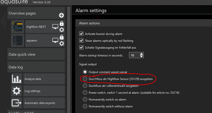

Hi i have a high flow next that i plugged both on usb and a flow input of a quadro (my quadro is plugged both in usb and aquabus to an aquaero 5)
on aquasuite while the hgighflow indicates 106l/h on the quadro (and then on the aquaero) it indicates 1775l/h
on the quadro when i go to the sensor i cannot change to the correct value, i have the choice for older aquacomputer flowmeters not the next.
i checked on the doc again and there is no limitation about that.

Please check if you have selected the right option.

thanks that was that.

You don't need to connect high flow to aquaero with aquabus that would result in a detection error,
Use aquaero's information pages to select the correct signal high flow number :)
