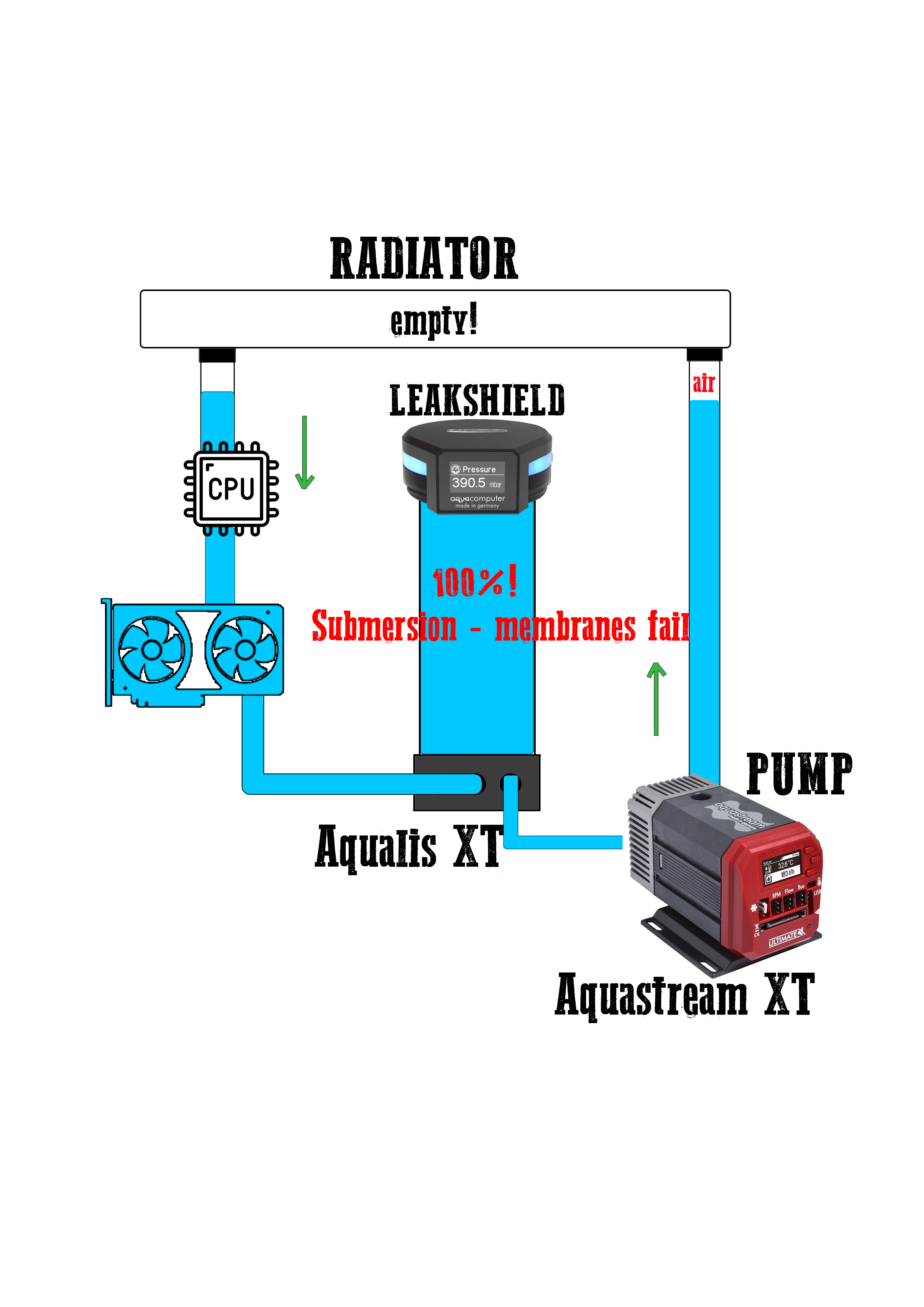

After 3 months of using Leakshield and 2 months of using the Aquastream pump, I want to complain about a problem that I can’t solve.
I want to say right away that I use Leakshield installed on the Aqualis XT 450 ml with fill level sensor. (bought long ago). Simplified flow chart in attached files.
During computer non-working hours, at night, the Aquastream XT pump can pass one small air bubble every 2-10 minutes. This is only observed in SHIELD mode. And only when computer turned off.
I thought the fittings were the problem, but air is leaking through at the connection to the pump cover (article 41032).

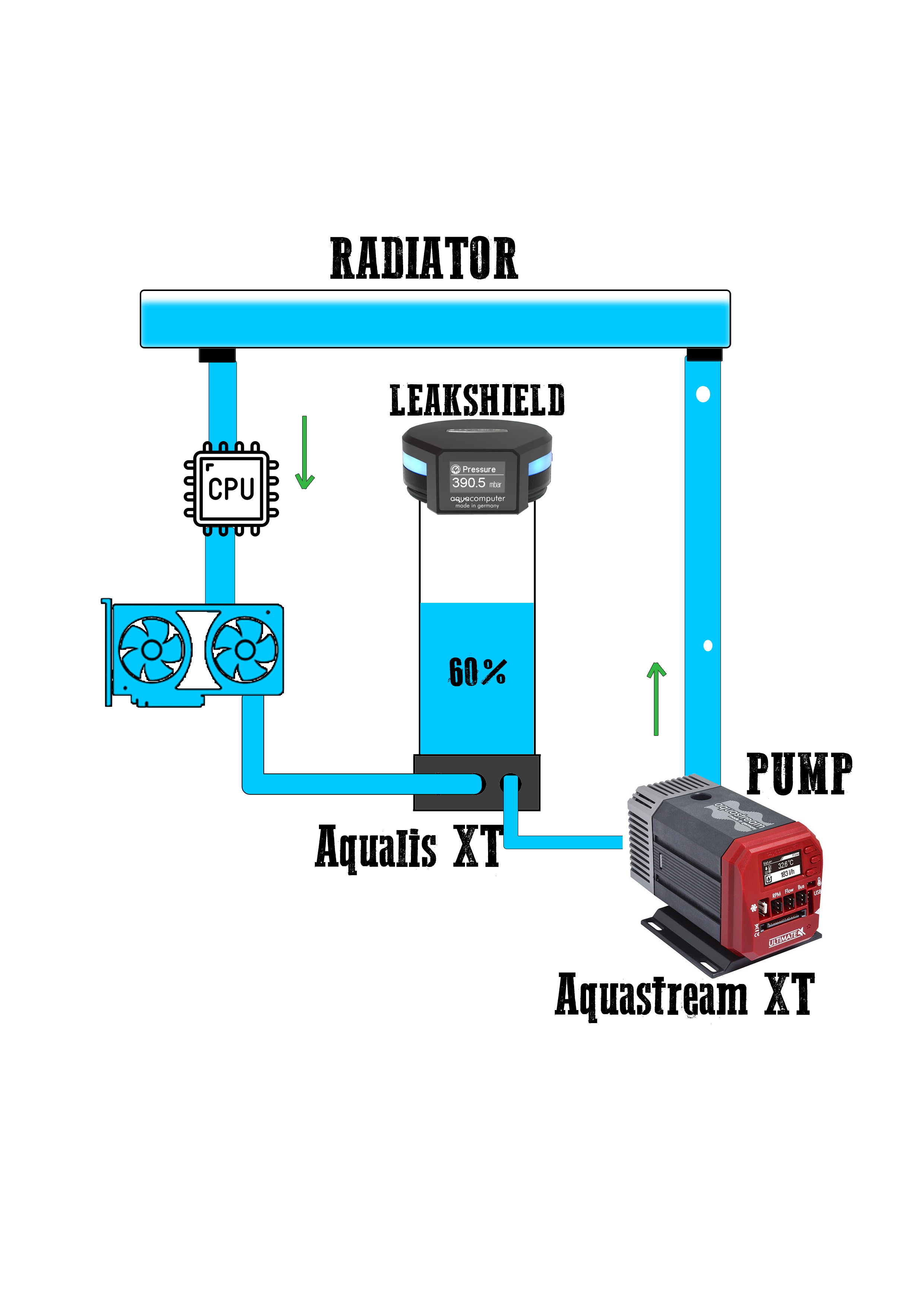

On normal days this is not a problem, rare bubbles from the pump rise into the radiator (Scheme 2) and raise the water level in the Aqualis reservoir overnight from 40% to 50-60%. Turning on the computer fixes the problem.
BUT, if I do not turn on the computer for several days, for example, a weekend, a little bit, one bubble at a time, the air pushes water out of the radiator, which is screwed to the top of the case and raises the water level in the tank to a critical level.
Which ends with an alarm in the Leakshield and then the flooding of the compensation membrane of the leeshield air pump, rendering it inoperable even after turning on the computer.
Alarm: Air volume in reservoir too low or pressure compensation membrane impermeable.
After each such incident, I have to drain the liquid, twist the Leakkshield and dry it for several days! As a result, Leakshield does not work more often than it works.
Please help, do not know what to do.

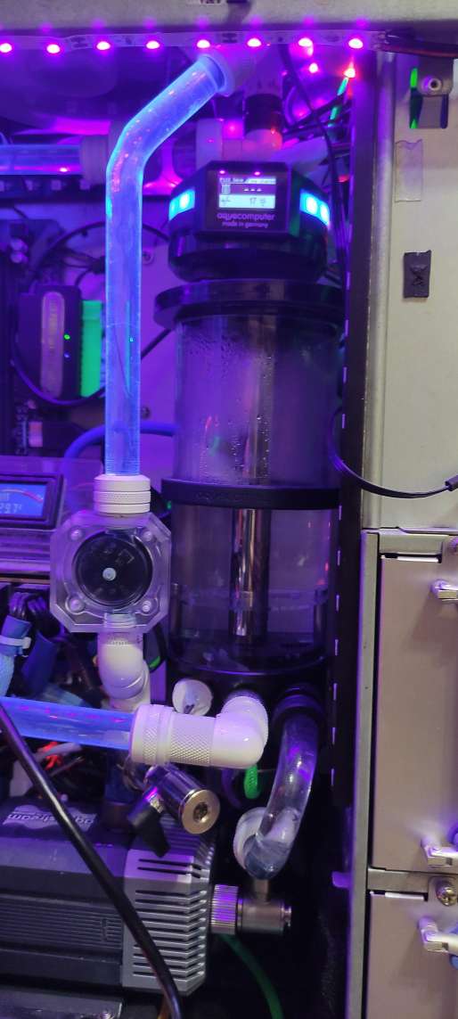

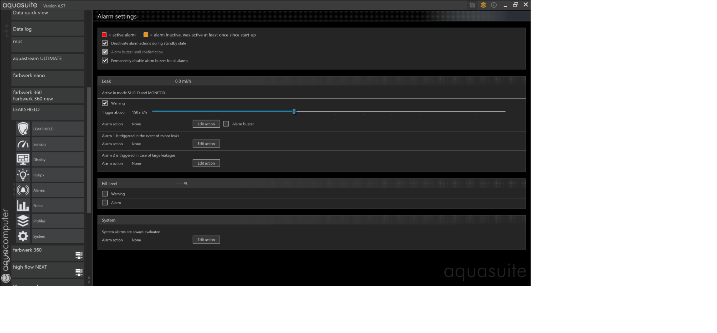

H!, Actually my sytem shema was added in files, but it is Ok to add real picture and screenshots.
On second screenshot hgeneral settings, you can notice that fill level is empty.
On third error after compensation membrane becomes wet. Measure Fill level button pressed.
In other files i have added ALL current leakshield settings.
Sound Allarms turned off, because i want to sleep during night..

As a temporary solution, after the computer is shut off, you can manually reduce the vacuum of the leakshield to 150mbar.
Lower pressure means less air is pulled into your system, reducing the flooding rate. You have to increase the pressure again before you start your computer.
Another temporary solution is to place a valve between the pump and the radiator. When you close the valve, the air cannot reach the Radiator and that will prevent the flooding.
