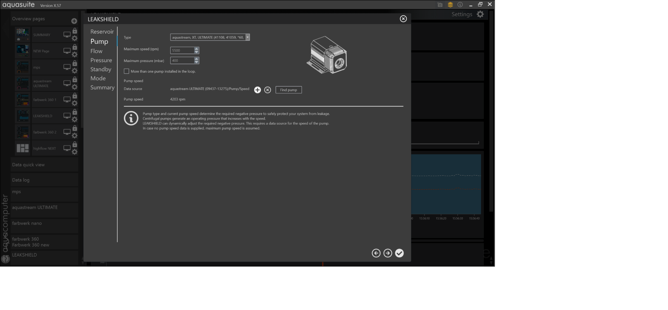

H!, Actually my sytem shema was added in files, but it is Ok to add real picture and screenshots.
On second screenshot hgeneral settings, you can notice that fill level is empty.
On third error after compensation membrane becomes wet. Measure Fill level button pressed.
In other files i have added ALL current leakshield settings.
Sound Allarms turned off, because i want to sleep during night..
