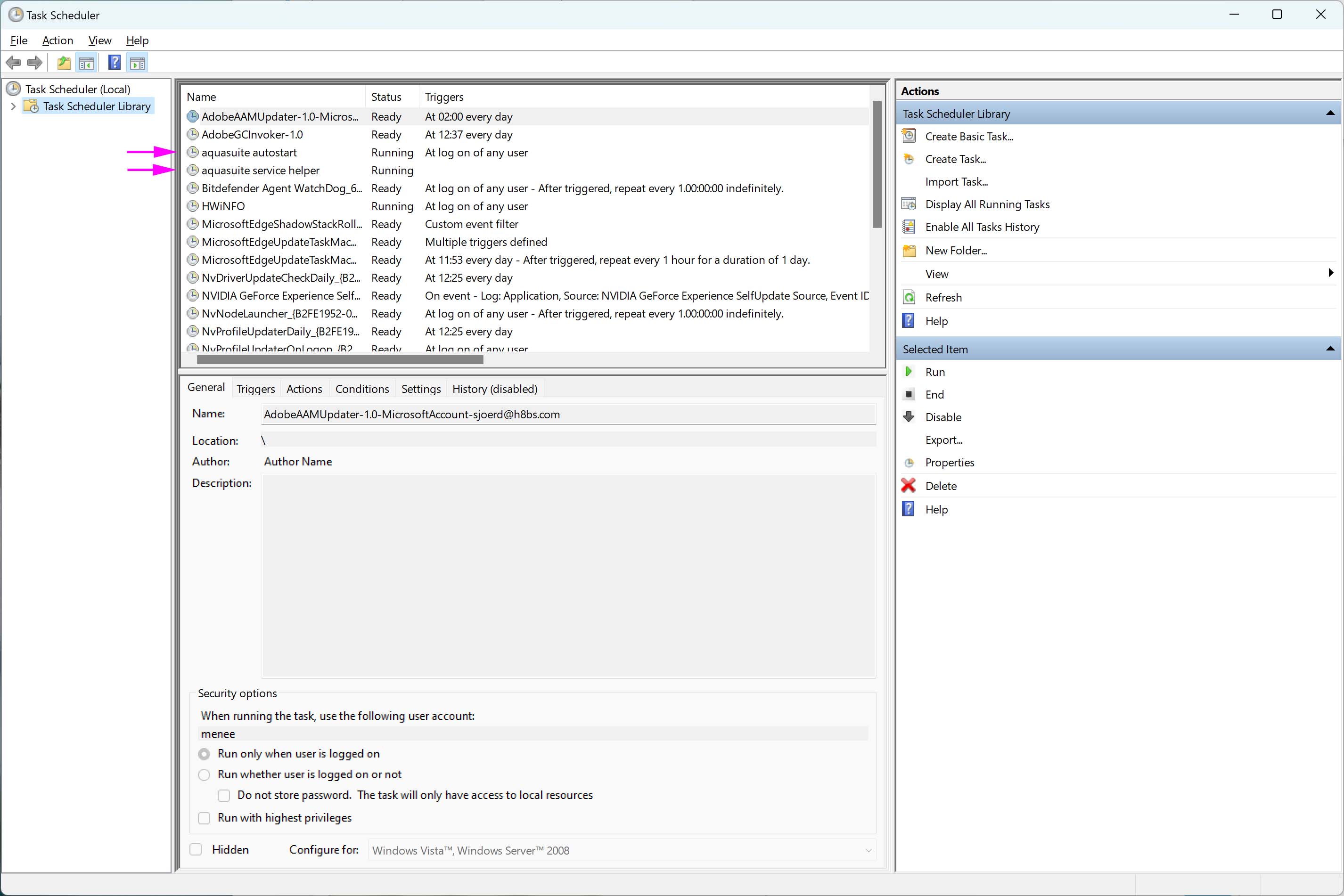

The best place to see if aquasuite is set to auto-start at system start up, is the Task Scheduler.
In Windows Search type 'task scheduler' and see if two aquasuite files are listed in the Task Scheduler Library (tasks.jpg)
In Windows Search type 'task scheduler' and see if two aquasuite files are listed in the Task Scheduler Library ([attach]9680[/attach])
Good golly! I would never have thought to use windows Task Scheduler.
I have set "run as adminstrator" everywhere I could find and nothing was working.
I was ready to reinstall windows after reinstalling aqua suite did not work.
I went to the Task Scheduler Library and was able to select "Run with highest privaleges" and NOW it works.
THANK YOU!
