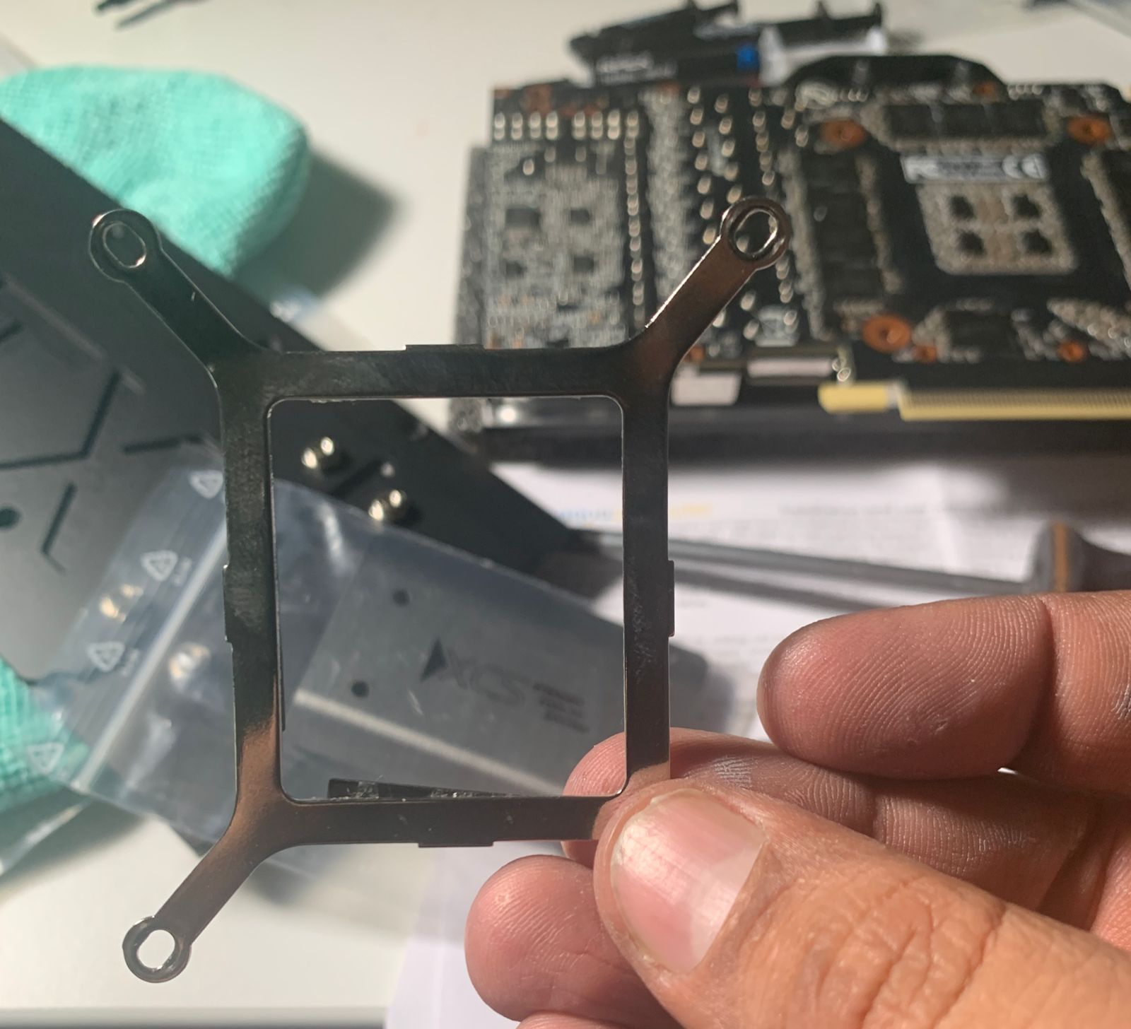

New here, I recently bought waterblock for my GPU (PNY RTX 3090 REVEL) which is a reference design. I also bought its active XCS backplate.
I am having an issue right now while installing, I completed front side and i wanted to put the screws for the main front side but I am confused do i also need to put the old gpu bracket on the back as well or no? (see in pic)
Or should i tighten this small bracket on backside first and then install active xcs backplate? pls help!

No, the original bracket is not used with watercoolers.
Just screw it on your aircooler and put it back into the box :)

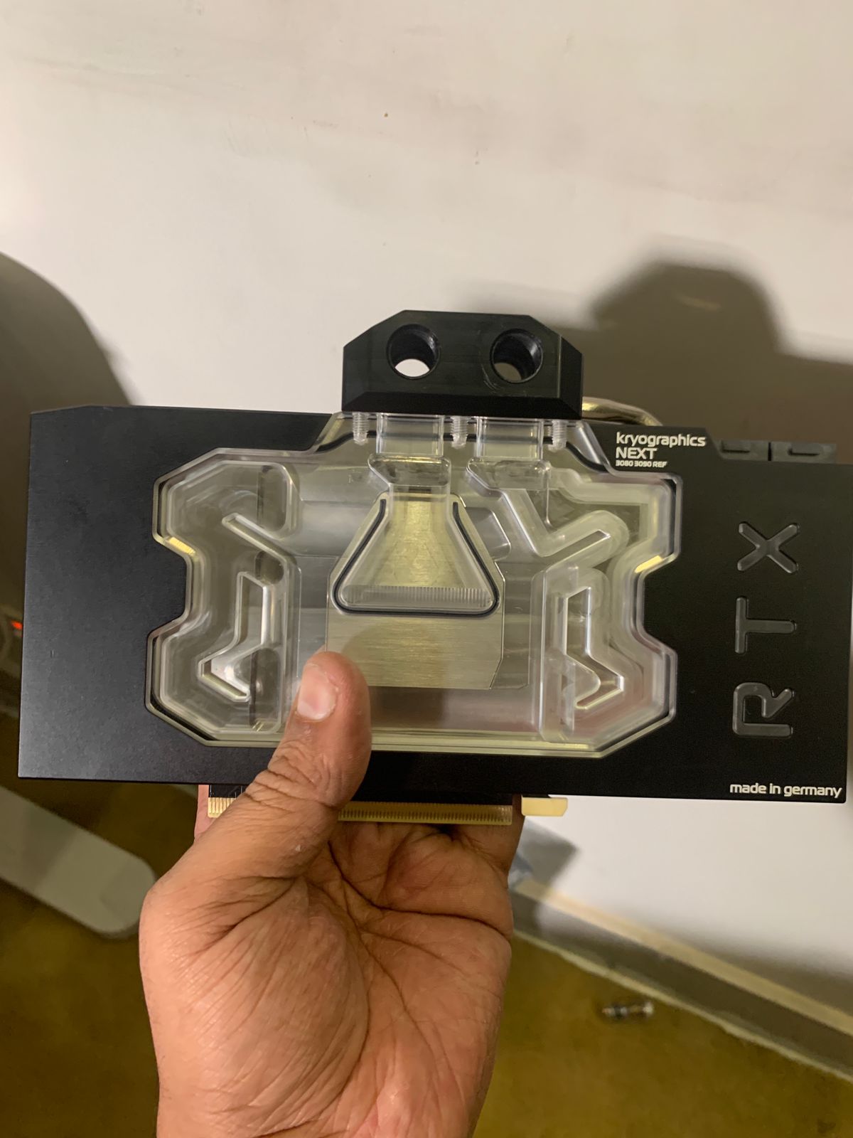

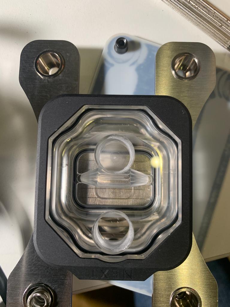

Another question which side is IN and OUT on waterblock with heat pipe(backplate)?
and also which one is IN and OUT on cuplex kryos??

In the picture of the CPU cooler, the upper one is the IN, then when installed, this one is usually at the bottom.
For the GPU cooler, the left one is seen from the front.
The inlet of the cooler is generally the one that leads directly to the jetplate or sits closer to it.
Montag, 7. November 2022, 20:40
These are theoretically the best inputs/outputs.
In reality it doesn't make a huge difference using it the way it best fits your plumbing
