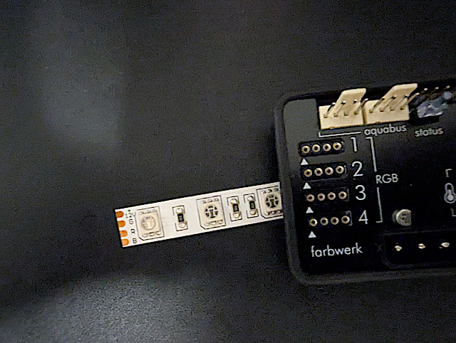

Hi everyone,
I apologize if this is a silly question, but I have never done anything with RGB strips before (I have long tried to resist that trend) but I needed o grab a Farbwerk (art no 53170) and two short white RGB strips (art no 52189) which are listed in the AquaComputer shop as being compatible with the Farbwerk for a project.
Upon opening the package I noticed that I am missing something rather crucial. A way of connecting the RGB light strip to the Faarbwerk. There are conductors on the strip, but no connector, so I can't plug them in.
See attachment:
Are my parts defective? Or do they ship this way, and I need to add a connector myself?
If the latter is the case, can anyone tell me which connector I need?
Also, so I need to solder the connector onto the conductors, or is there some sort of compression or otherwise fit?
Appreciate any assistance.
Thanks,
Matt
Bartdude
Freitag, 16. Mai 2025, 07:22
Looks like you need something like THIS
mattlach
Freitag, 16. Mai 2025, 21:11
Thank you.
It helps a lot to know what to search for.
I really kind of wish they had referenced these by part number somewhere in the documentation or store for the strips and/or Farbwerk.
These projects take so much longer time when you have to order something, wait for it to arrive, and only then find out what you are missing and then need to order something else and wait again...
