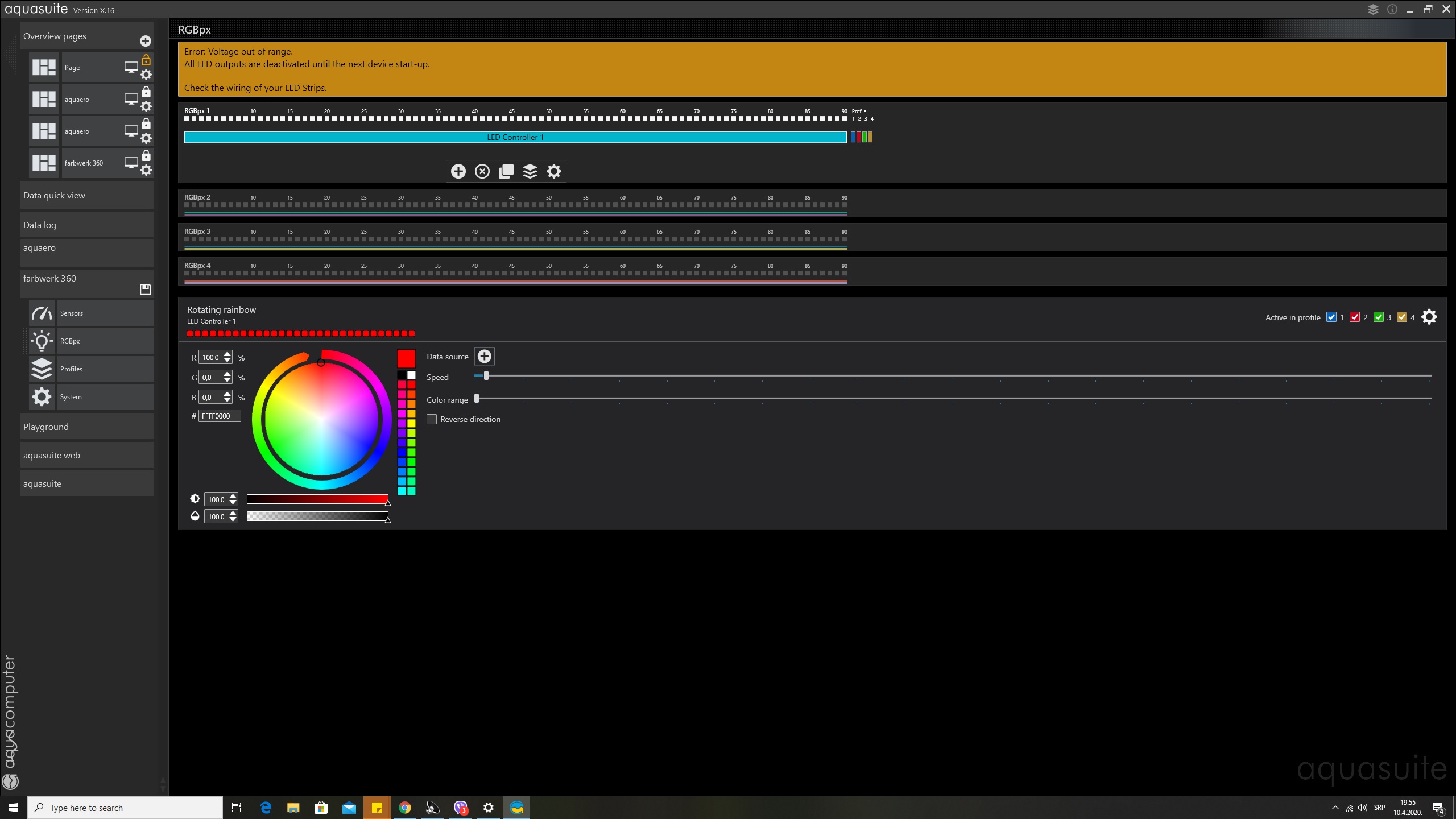

Yesterday I received almost all AC shipment and today I ve stared unpacking and connecting everything, so I decided to start with Farbwerk 360, out of 4 LED strips two wont light up and one have defective last LED light (its just blinking),when I tried to change colors, it gave mi this error... Nothing seams broken of flimsy on the connectors... Does anyone have any idea on what to do? try? ?(

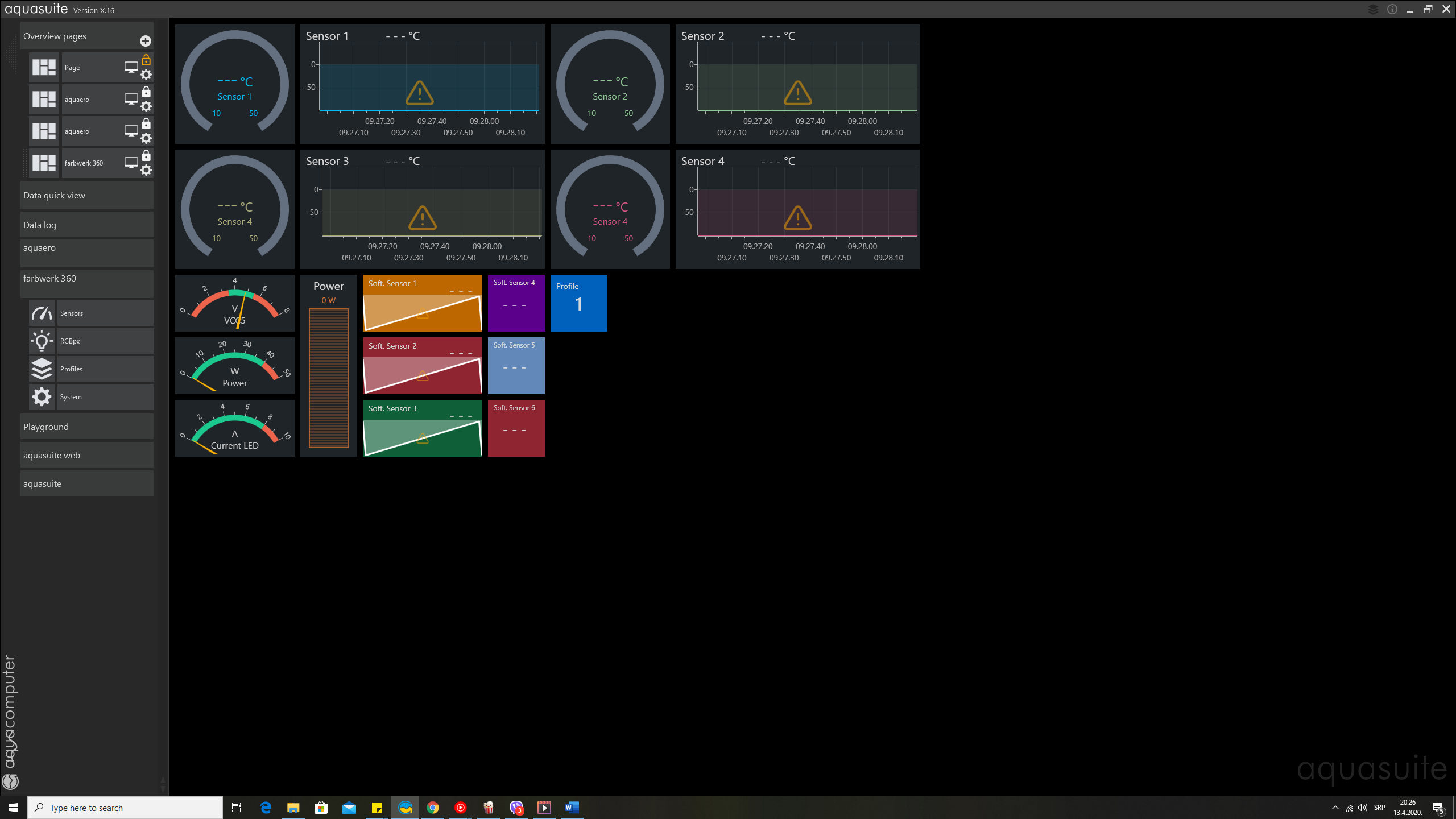

Please see attached pictures and post same ones.
I think that best way is to connect only one strip and test each channel separate.
BR
George

Can you please post same images as me. Important is 5V voltage.
There was an error message- voltage out of range, visible on your post.

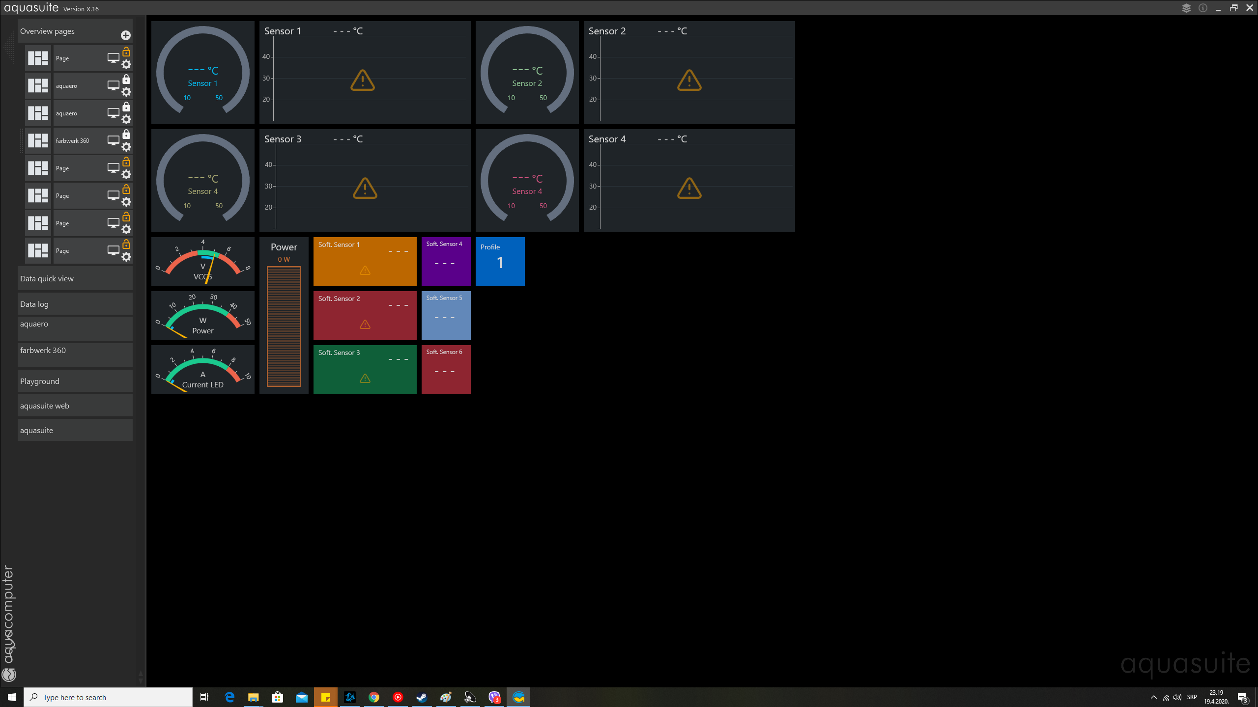

Sorry, I totally forgot to take a screenshot....

It seems that posted page is with farbwerk 360 without load. Voltage is OK. If you light up all strips (1 per chanell) what is visual of this page of farbwerk 360?
Please post photo of connection strip to strip, important is that strip has IN and OUT and connection cable between strips is twisted, not in the line.

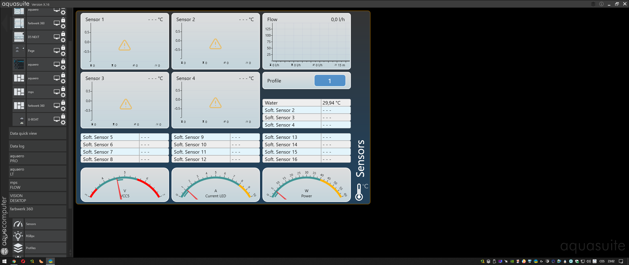

Tried again, one strip per channel, it worked until it flashed again the same error (Voltage out of range) and started red light blinking on the farbwerk 360...
From your posted picture is vissible that your voltage is under 4 Volts only on 60 LEDs !
What do you have for power supply unit (PSU)?
Do you not use some nice non-brand extension cable for PSU with bad crimp?
I have on full load = Brightness - 100% on 99 LEDs stable voltage 4,6 V.
Please post same picture as I in the bottom.
Definitely I think that problem is in the weak PSU or bad PSU cables, molex male or connector to PSU if you have modular PSU (especialy bad crimp).

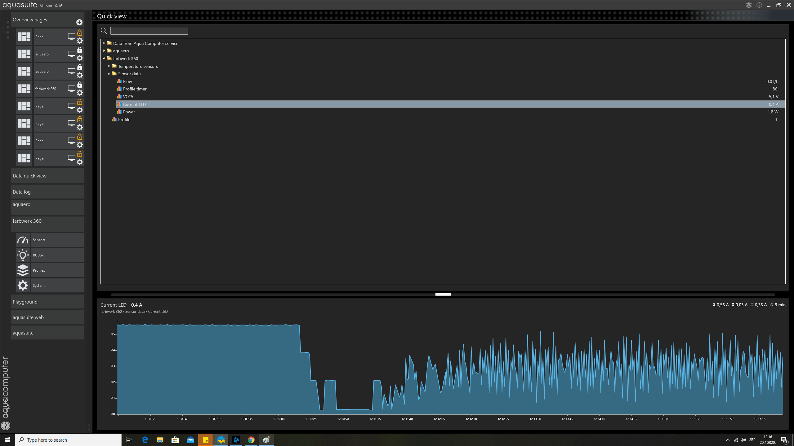

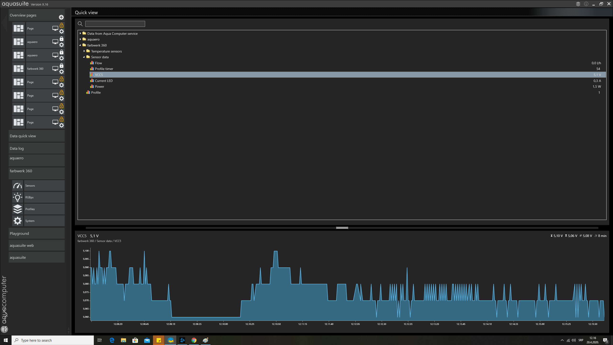

I use Corsair RMi 1000, with custom cables but I did connect Farbwerk on separate PSU that I jump started.... 8| Here are the screenshoots you asked, is that good/bad?
This is what I get with Corasir PSU. :thumbup: 8o 3 connected strips work separately, I will try connecting them in one line to see if it will work...

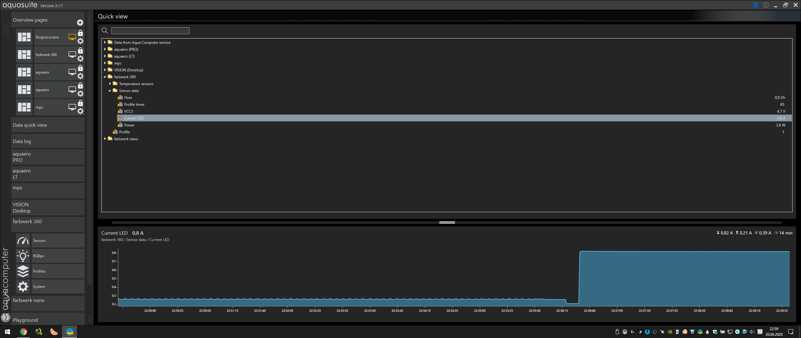

This is after connecting all 4 LED strips on one RGBpx channel. Is that ok value?
I cant change controllers(like just to have ambientPx-which doesnt work at all...) without auto -turning off LED strips 2-3-4, then just the first one works. After factory reset , it works again, all 4 strips on 1 channel.

Thats mean, everything work and you are RGBpx happy?
See my values in the bottom. I think that values depend on LED mode (only solid colour or effect). I think that values are OK, important is there is no error message. :)
