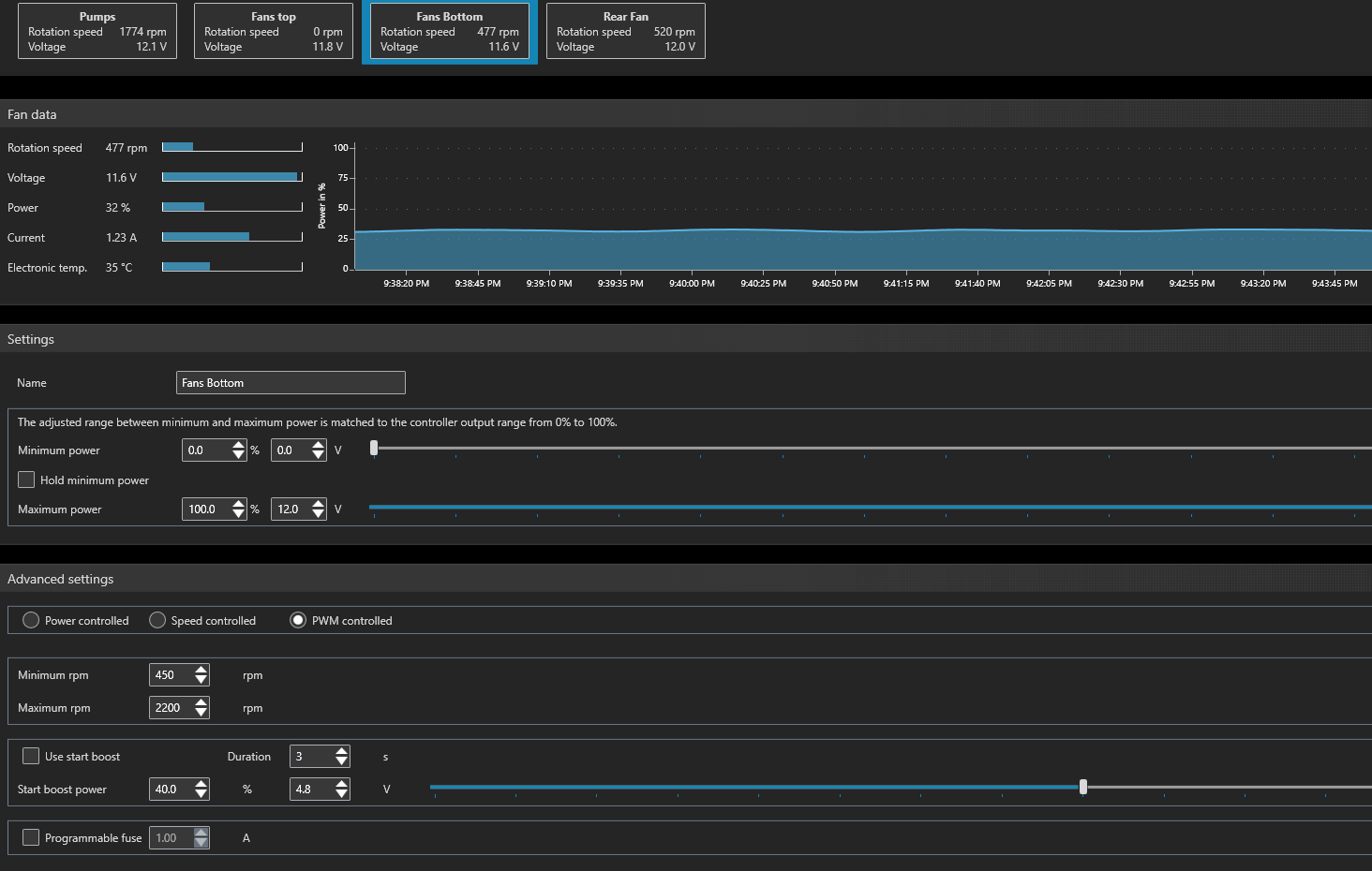

New to aquacomputer products and am not sure if I am setting something up incorrectly or if something is not working correctly. I have a pretty large loop with 18 fans and 2 pumps. I've used 2 splitty9's with 8 fans on 1 and 9 on another (17 fans are all ekwb pwm vardar 2200rpm). 2 pumps are on fan 1 and they are working as expected on my curve controller. and I have 1 140mm ek fan as an exhaust on fan 4 and it is working as expected.
So I seem to just have a problem with the 2 channels that have splitty9's. rpms are not reading correctly and the fans keep going from like 20% to full speed then back to 20 and it repeats about every 10 seconds. They are controlled from a coolant temp sensor so the temp is not swinging quickly.
I've setup the fans with the listed rpm ranges and min-max power from 0-100 (tried playing with these numbers but with no success). The website shows each channel can handle 30 watts. fans are 2.18 watts max so I am well below 30. When my fans are running at 100% aquasuite is still showing ~500rpm.
Since my channels that have 1 or 2 things on them are working, I assume I have an issue with the splitty's or fans but I believe they are hooked up correctly. Got tired of buggy asus software and heard good things about these products but I'm not sure what to do to fix this.
Any help would be appreciated as I'm learning the new software and hardware.

[attach]7747[/attach]
I do have it set correctly and not in aquabus mode.
