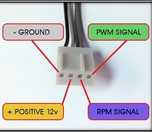

So I just have to remove the rpm wire from all but one on each channel.
Is this diagram correct? (Diagram is not my fan wires but used only for illustration)
Thanks
mandrix
Monday, December 16th 2013, 1:07am
That's it. :thumbup:
