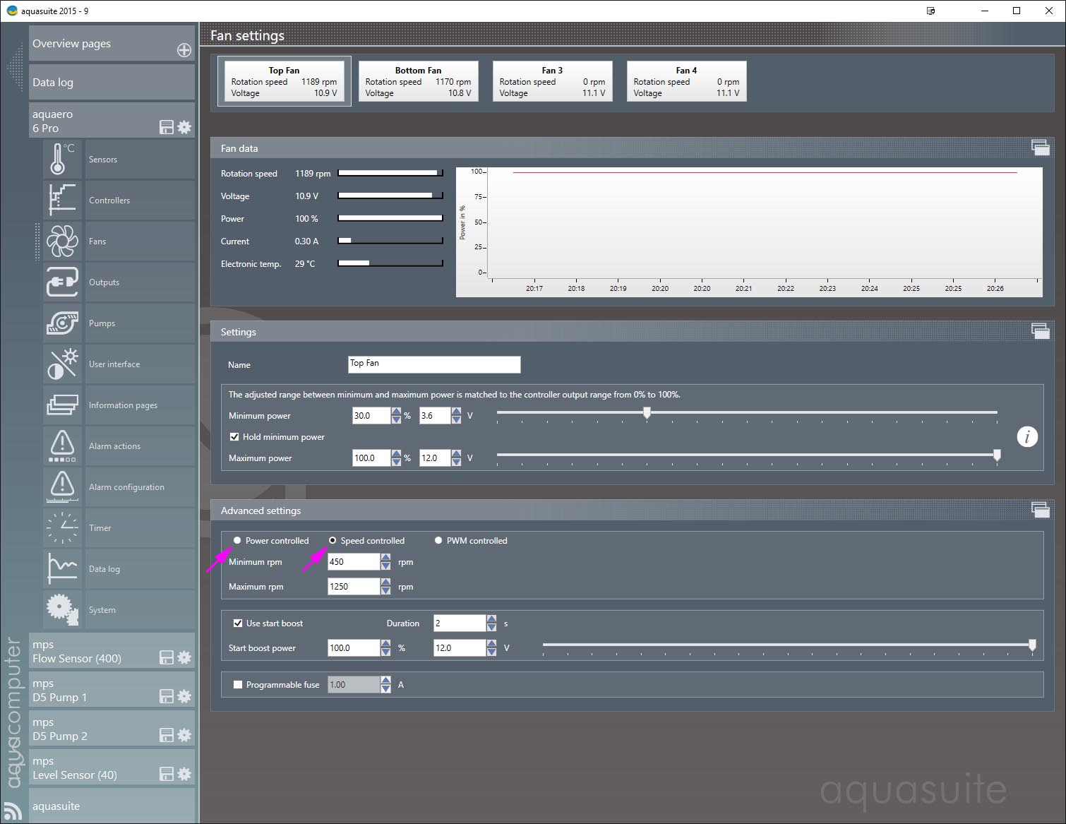

Experimentation is what this is all about, so maybe to try this:
1. Set the fan to Power controlled and probably the controller doesn't look for RPM input from the fan, it provides power per the curve.
2. Set the fan to Speed controlled and the controller will run the fan at 100% without an RPM signal.
