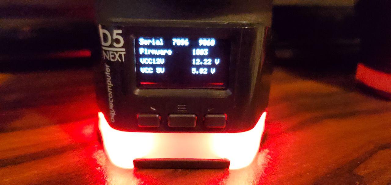

I'm about to finish my build. I have two brand new D5 Next
I was setting up a test loop, But when I turn on the PSU, i get "pump speed to low" alarm on both units
Thank you,
CoolPanda has attached the following files:
Monday, February 3rd 2020, 7:19am
I think the rotor is blocked in your top. try to runt the pump without water and a top for a few seconds.
Is the pump working?
CoolPanda
Monday, February 3rd 2020, 10:46am
Yes it works without water
Monday, February 3rd 2020, 11:18am
Have you in this condition a low rpm warning?
CoolPanda
Monday, February 3rd 2020, 4:03pm
No pump works fine without water
I think the problem is came from Singularity Reservoir Combo
The gap between Singularity pump top cover and D5 next is too tight.
Thank you for helping me Sebastian
