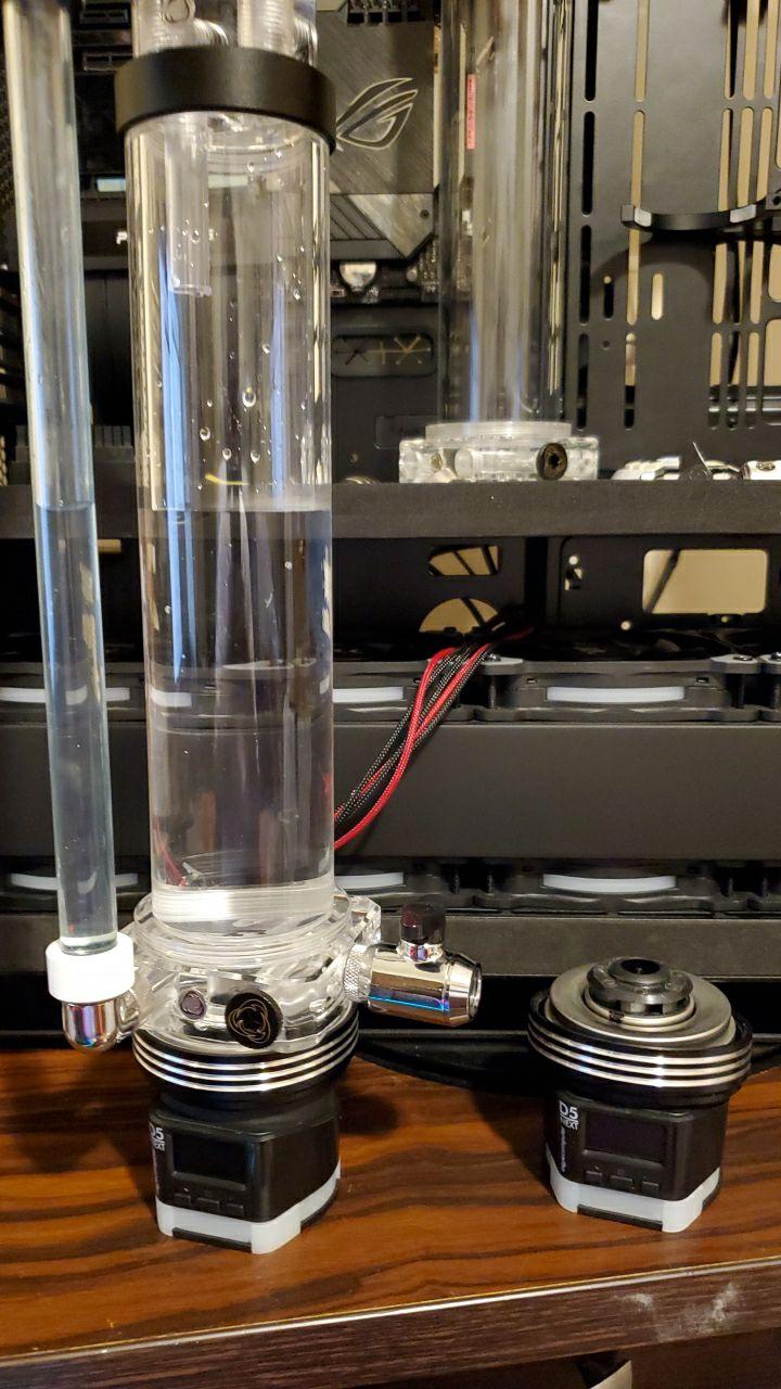

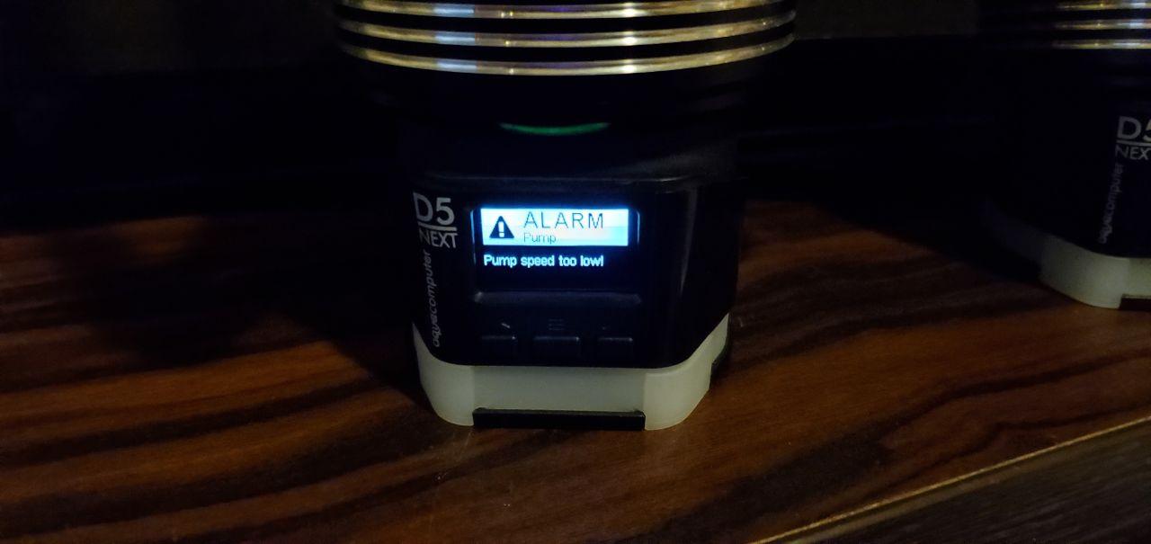

I'm about to finish my build. I have two brand new D5 Next
I was setting up a test loop, But when I turn on the PSU, i get "pump speed to low" alarm on both units

I think the rotor is blocked in your top. try to runt the pump without water and a top for a few seconds.
Is the pump working?

Yes it works without water
Montag, 3. Februar 2020, 11:18
Have you in this condition a low rpm warning?

No pump works fine without water
I think the problem is came from Singularity Reservoir Combo
The gap between Singularity pump top cover and D5 next is too tight.
Thank you for helping me Sebastian
