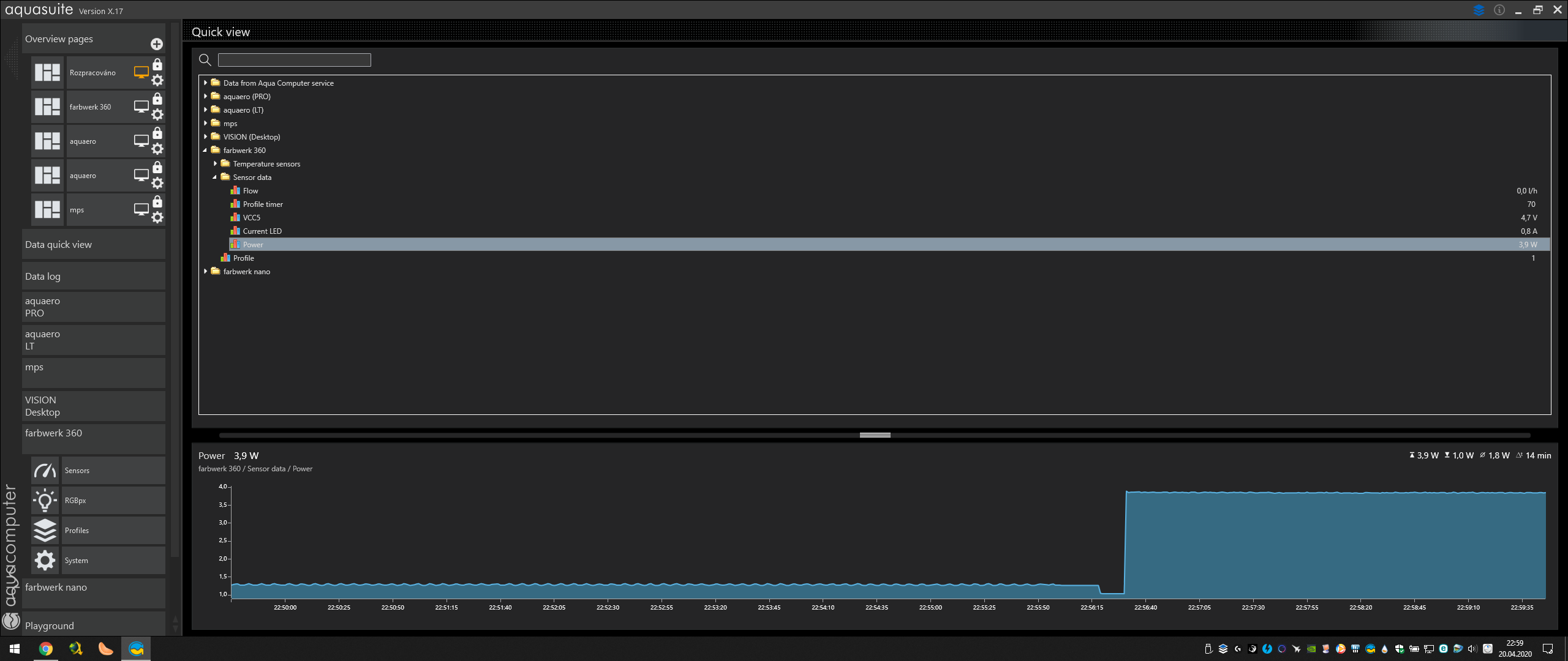

From your posted picture is vissible that your voltage is under 4 Volts only on 60 LEDs !
What do you have for power supply unit (PSU)?
Do you not use some nice non-brand extension cable for PSU with bad crimp?

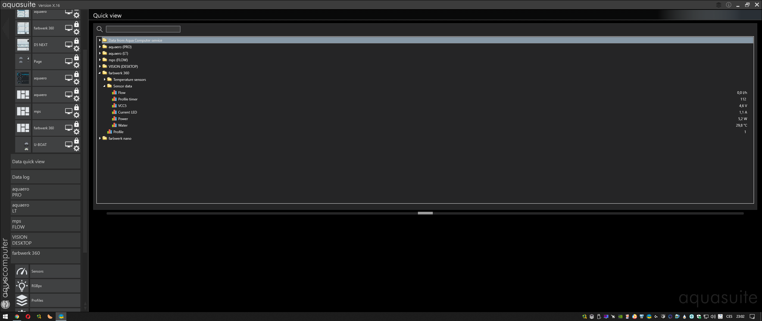

I have on full load = Brightness - 100% on 99 LEDs stable voltage 4,6 V.
Please post same picture as I in the bottom.
Definitely I think that problem is in the weak PSU or bad PSU cables, molex male or connector to PSU if you have modular PSU (especialy bad crimp).

I use Corsair RMi 1000, with custom cables but I did connect Farbwerk on separate PSU that I jump started.... 8| Here are the screenshoots you asked, is that good/bad?
This is what I get with Corasir PSU. :thumbup: 8o 3 connected strips work separately, I will try connecting them in one line to see if it will work...

Thats mean, everything work and you are RGBpx happy?
See my values in the bottom. I think that values depend on LED mode (only solid colour or effect). I think that values are OK, important is there is no error message. :)
