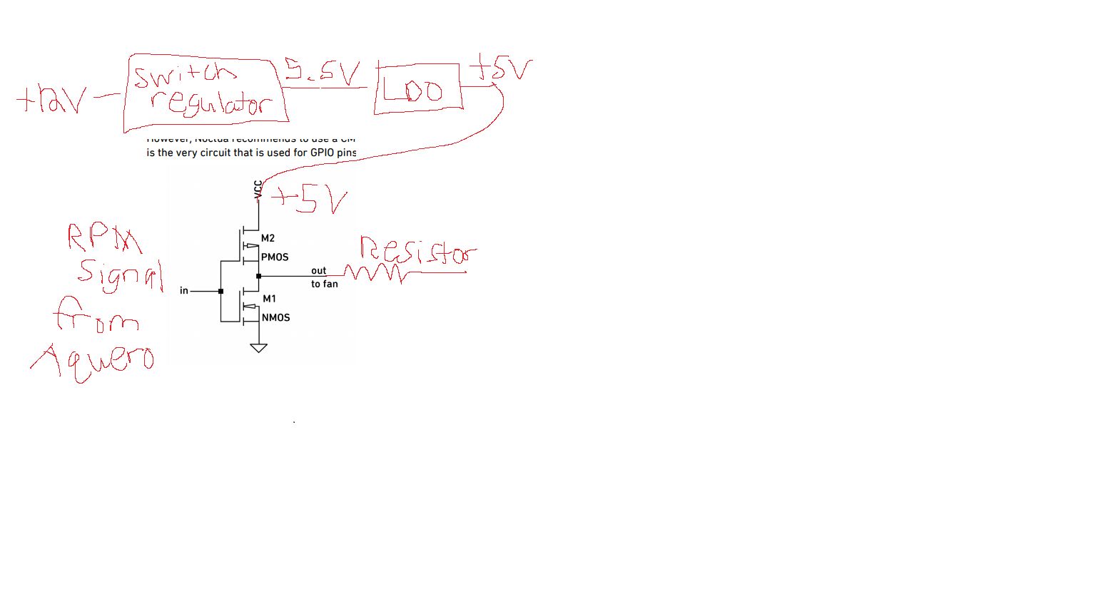

It sounds like I can just redesign my own splitty9 and add a +12V to 5.5V switching regulator and then a 5.5V to 5V LDO and this should solve the issue.

This is what I was proposing. Its a fancier solution than needed but I have spare parts laying around that are up to the task. I believe I put the resistor in the correct place that Stephan was referring to.
Keep in mind, I did not say this was a good solution or will work longterm, I just did a quick test and it seem to fix the issue.
Jibby has attached the following image:
Thank you for posting that.
I am going to have to revisit my circuit terminology and how to read schematics. It's been 20+ years since I played with this stuff.
Is there a reason you are pulling down the 12v source to 5v, instead of just using the 5v line already available to you from the PSU?
If this works well, without long term damage, you should have a small board outfit in china build a small order of a couple of hundred of them, and open a shop on Amazon or Ebay. I'd buy a few :p

I went with my own +5V just because I am familar with the hardware I was using and I like to use things I built myself previously to troubleshoot electrical problems. You could probably use the +5V rail as long as it doesn't exceed +5.25V but I have no idea what Noctua's actual limit is. I seemed to be able to apply a tightly regulated +5.0xV voltage and it seemed to be fine but I only ran it for like 5 minutes.
What the +5.25V max is referring to is the max voltage. The 0.8V just means that 0V- 0.8V range is just giving you the low threshold range (the low point range of the PWM signal). I have no idea what the threshold voltage for Noctua's fans are (the point at which the low becomes high or 0 becomes 1) but I assume that if they followed the intel spec and 3.3V is fine for a logic high, then the voltage threshold is somewhere around 2.4V-2.6V.
I attached a crappy picture again to try to illustrate what I am saying
<img src="https://forum.aquacomputer.de/index.php?page=Attachment&attachmentID=7326&h=0fa7732369f603cb7acda7e0b81df15a3108a98d" alt="index.php?page=Attachment&attachmentID=7326&h=0fa7732369f603cb7acda7e0b81df15a3108a98d" title="index.php?page=Attachment&attachmentID=7326&h=0fa7732369f603cb7acda7e0b81df15a3108a98d" style="font-size: 0.81em;" />
This is not working, the output signal is inverted and a input pull up (10K) is missed.
You could just cascade two of the CMOS inverter circuits together and that would correct the output signal. Can you draw where the input pull up resistor goes?
