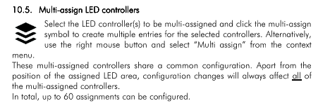

sorry I'm late to the party, but is the multi-assign button still alive in version X.53?
for the life of me I can't find it.
any help would be welcome

Yes its still in X.53. PICTURE

I think I found the problem, I was looking for this on the Octo, (the multi-assign is not even in the manuel).
Seems this function is reserved for the Fabwerk 360.
PS: found my fabwerk 360; it has multi-assign. My Octo does not.

Yeah I think Multi-assign is limited to the Farbwerk360 and the Farbwerk Nano. The RGBpx ports on the Farbwerks also support Transparency. For the Octo, Quadro, and other devices that have RGBpx ports on them, as you stack RGB effects (they call them LED Controllers), the effects higher in the stack block the effects below them. With Transparency you can allow effects lower in the stack to "bleed through" the effects higher in the stack. This is a very powerful feature that allows an LED or group of LEDs to be driven by multiple effects at the same time. This opens up a lot of possibilities.
