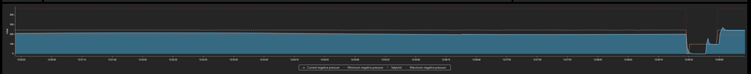

So it generally looks something like this.
Now also, though the water level is not decreasing, I notice the reported fill level is lowering substantially (is now at 66% when was 88% yesterday), but there is no leak... the pressure alarm is going off frequently tonight.
This is since I turned the computer back on from a few hours ago.
I do think there might be an air leak somewhere, but I don't know why this would change the behaviour of the Shield mode going to just above minimum pressure, instead of Set-Point
gavogavo has attached the following image:
gavogavo
Tuesday, February 15th 2022, 12:02pm
I have re-ran "measure fill level" multiple times.
I get between 72 and 60% (again, the level of liquid in the res does not appear to have to changed from yesterday when it was over 80).
Back to back measurements are giving different results, and I feel like there is a dip in pressure when shield mode is turned on and set point pressure is reached (per the screenshot above... shield mode activated.. pressure builds to around set point, then falls to near the "min" level... sits there and slowly decays until the pump activates a small amount keeping it right at the minimum level. I do not believe this is the same behaviour it was showing yesterday.

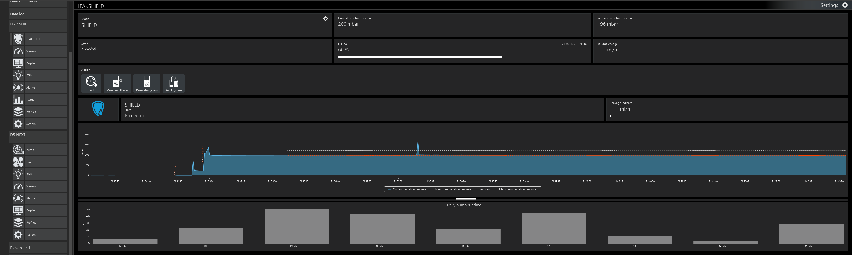

So just now this happened and I found it it interesting (attached a screenshot): I went from gaming, to mining, and switching between. I heard the leakshield turn on really quickly which I knew meant that the minimum level had been triggered and it added just enough to get over the min level (see between 12:56:15 an 12:56:40 of the picture). I went in, released the pressure, and immediately activated shield-mode. it did the level test, and activated pressure back up to the set point.
I think the condensation is not fully inhibiting it, but rather there is a software setting that, when minimum level is triggered, does not add pressure back to set point, but just tops it back over minimum. I don't understand why this would be the case but it does seem to be given I did not change any setting, and you can clearly see the pump activation taking the pressure back over minimum but not to the set point in this photo...
