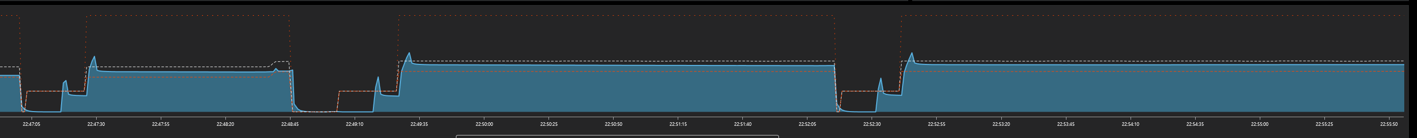

Update:
the machine was operating as expected, with release/shield cycles taking the pressure up to the set point and holding.
I powered off the machine for the first since my last cleaning update... It was off for approximately 4 hours.
On return I powered the machine on and it did cycle pressure up to maximum... I noticed this and once the software booted up (after a restart with admin and manual start of the service), it ran with lower than expected pressure (under the set point) and triggered an alarm after some minutes (frequent pressure loss). I recognised this behaviour, let the water temperature warm to operating (35 deg C, around 10 more than ambient), and redid numerous release/shield cycles. Every single time the patter is the same (see attached): it rises above set point, and falls some level below it. The calculated fill level, is again lower than expected (currently 74%).
My prediction is that if I power off the machine for some hours again, on boot, it will bring pressure up and it will fall even further below set point, closer to minimum, until eventually the original problem persists.
I am absolutely certain this has to do with condensation forming on the membrane, exacerbated by the cooling of the parts on the recent shutdown.
I really have no idea how to manage this, or if it is reflective of a faulty membrane, but it will be a difficult problem to accept, that I need to clean/dry the membrane each boot cycle.
I have emailed customer service before the weekend and am waiting on a response.
Will update when I know more
EDIT: note the change at 22:48:45 is my change of the pump from 40% to 50%, in an effort to drive up the set point and assess its impact on the behaviour of the pressure rise and fall on release/shield mode cycles.

Mittwoch, 23. Februar 2022, 01:40
So it's doing the exact same thing that it was doing in your post dated Feb 20. This is very interesting. I hope that the AQS devs take a look at this and comment.

To confirm, I have been running it since the last post... It holds pressure, but it certainly does not return the pressure back to the set point after release. Just did a release/shield mode and it's behaving exactly as I predicted: on re-pressurisation, it increases above set point and drops instantly to approx 50% between set point and minimum. It will get closer to minimum over time (release/shield cycles will drift further and further from set point).
I agree: I hope they can take a look as I am mostly sure this is software... perhaps it's membrane or solenoid but I can't speak to that... the reproducible nature of it makes me think it is software
