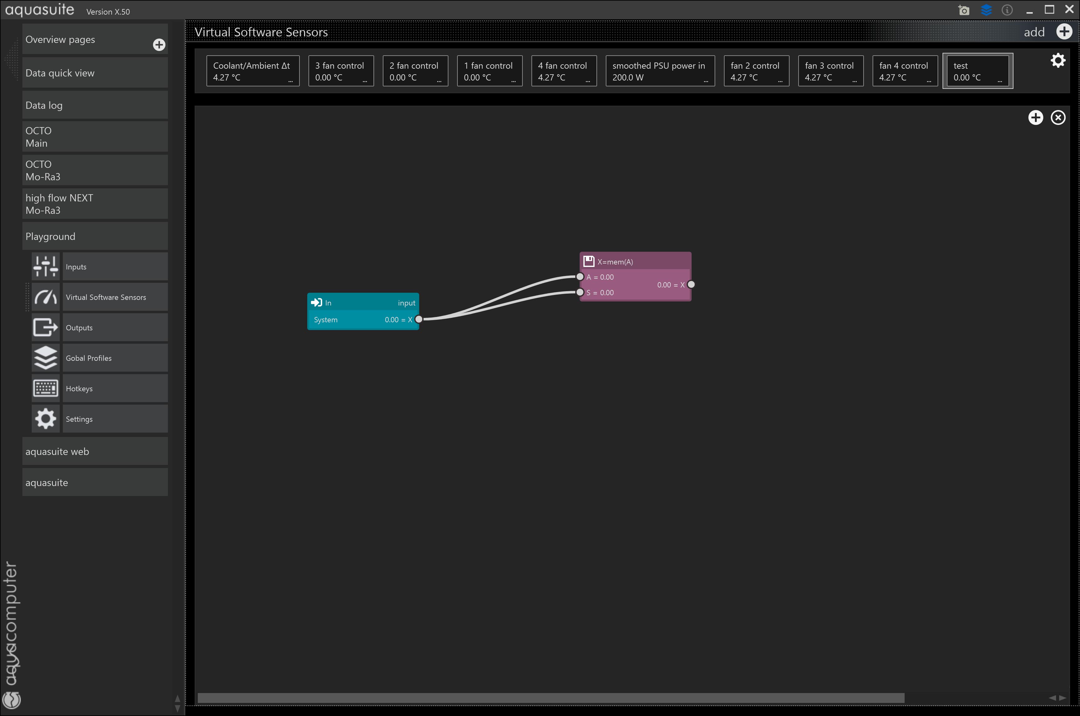

a little test
Wednesday, March 9th 2022, 11:39pm
  • one input at 1 to two X=mem(A) = result as anticipated (input1-to-2xmem.jpg)
  • one input at 0 to two X=mem(A) = result as anticipated (input0_to+2xmem.jpg)

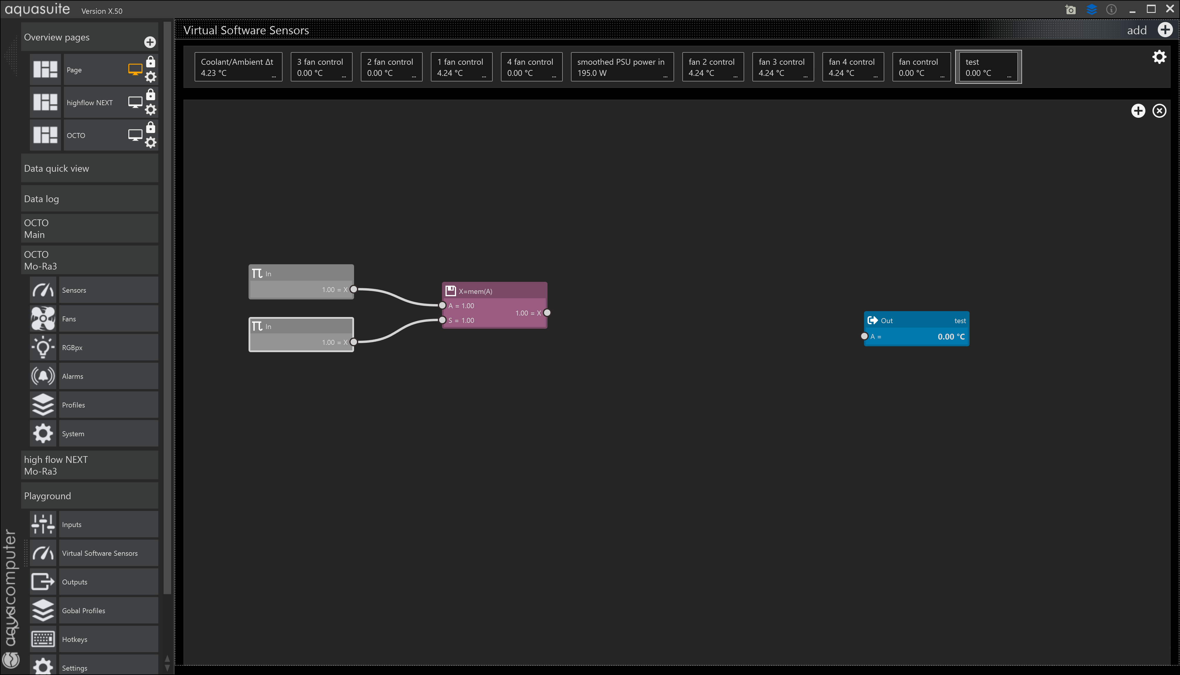

  • leave input at zero and delete one X=mem(A) = unexpected result (leave_input0_delete_1_xmem.jpg)
    the moment the 2nd X=mem(A) is deleted, the remaning X=mem(A) X value drops to 0

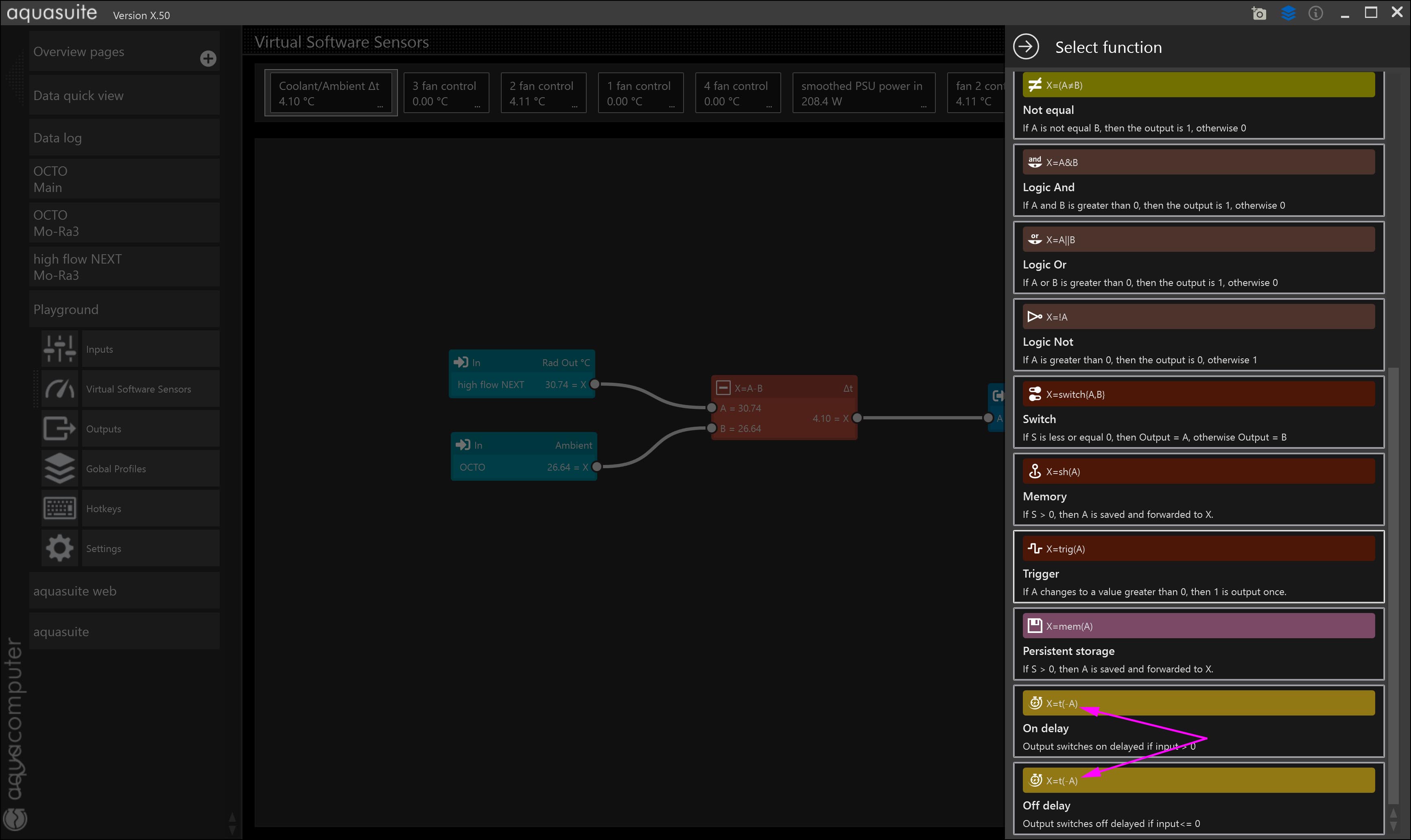

  • minor issue - both delay icons in Logic Function Selector have a (-A), one should be a (+A) (delay_icon.jpg)

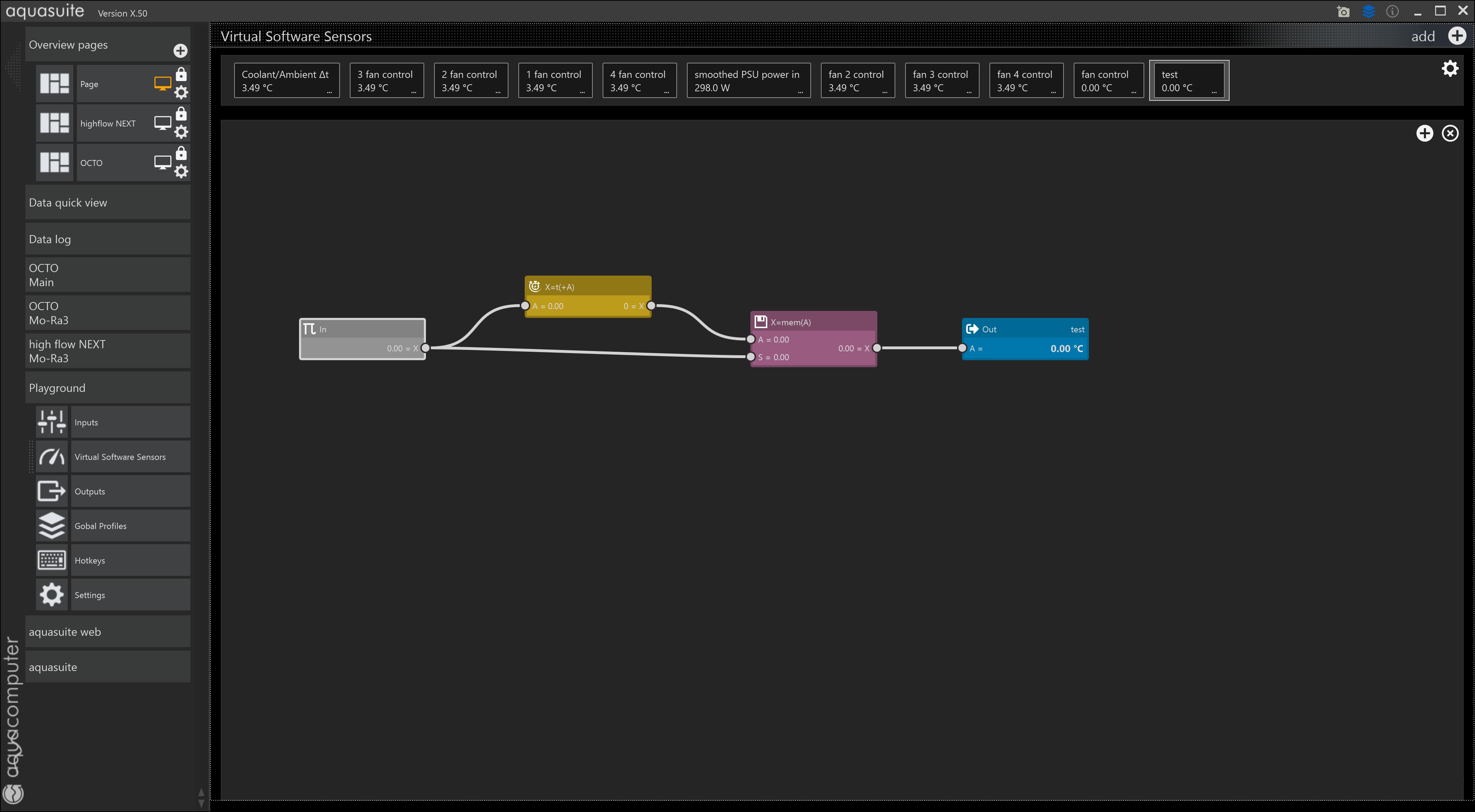

Thursday, March 10th 2022, 1:13am
I feel like I am in the twilight zone, it works sometimes and not others.
  • both inputs are 1 (1.jpg)
  • drop the S input to 0 (0.jpg) fail
Thursday, March 10th 2022, 5:05am

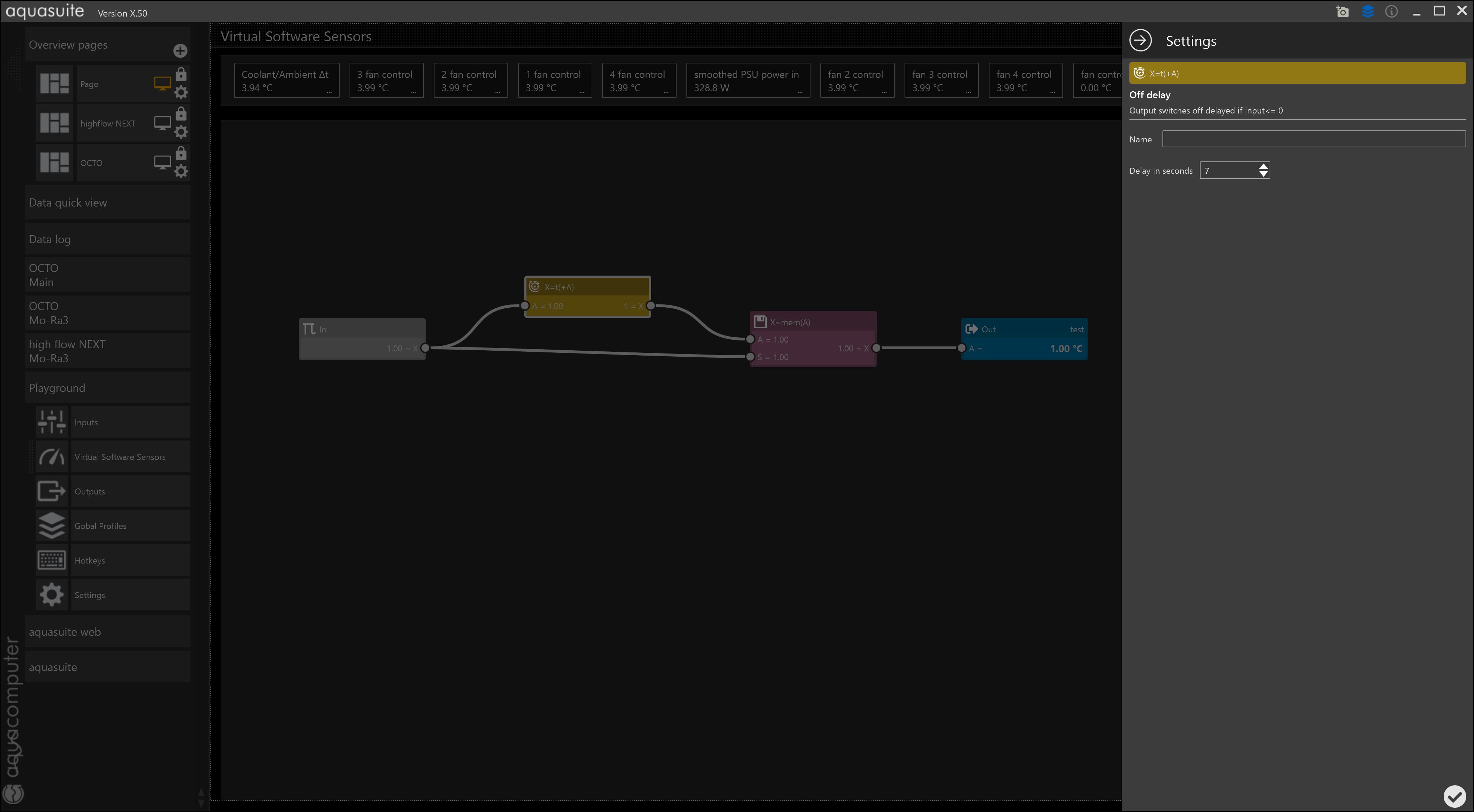

Something else I am misunderstanding: how the X=t(+A) Logic Function works.
The cheat says "Output switches off delayed if input <= to 0". Having a 7 sec delay dialed in, I expect the following:
  • (input1.jpg)
  • input is dropped from 1 to 0
  • S on function X=mem(+A) goes to 0
  • A on function X=t(+A) goes to 0, this starts a 7 second countdown
  • at the end of the 7 second countdown, A on function X=mem(A) drops to zero
  • (input0.jpg)
But what I see is S & A on the function X=mem(A), both dropping to 0 immediately

Thursday, March 10th 2022, 7:27am
When you change somthing in your flow, everything in the flow restart.
You cant test it in this way with using constants and changing it. you have to use data sources / sensor values / input values.
WinstonWoof
Thursday, March 10th 2022, 8:32am
  • ([attach]9282[/attach])
  • ([attach]9283[/attach])
For testing rather than use a constant as an Input use a Sensor input .
No need to define the source just set the Fallback value & Test Data Output values making sure the output duration is greater than your delay.
Then to test Right click on the Sensor input and select Output Test Value.
https://drive.google.com/file/d/1NAkXBZx…iew?usp=sharing
This post has been edited 1 times, last edit by "WinstonWoof" (Mar 10th 2022, 8:34am)
Thursday, March 10th 2022, 1:43pm
Aha... that is what Remayz was hinting at. I did not think changing a constant input effected the flow, but in retrospect I understand.
I'll use inputs or test as WinstonWoof suggested.

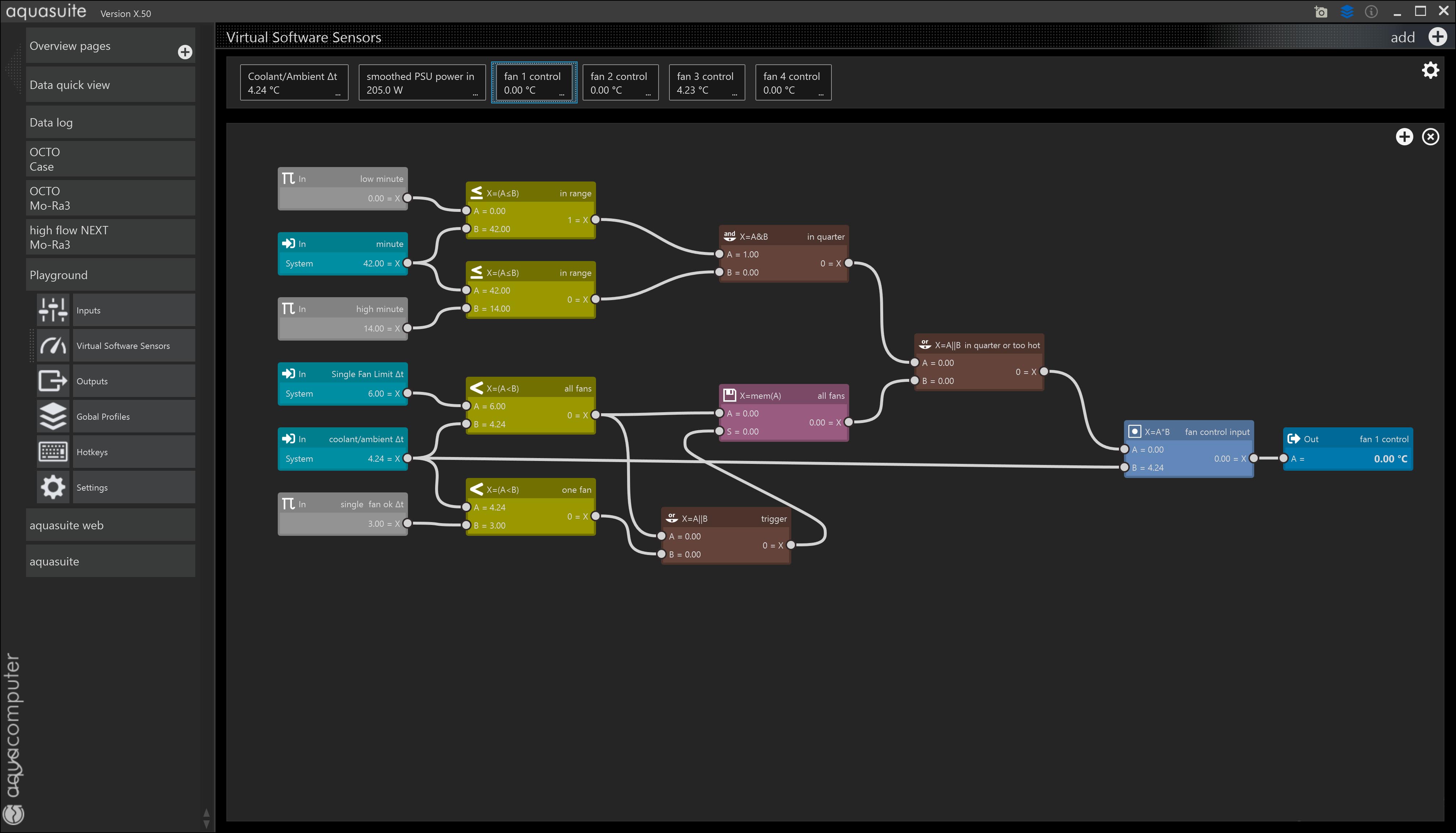

This thread contains a LOT of detailed information about how these logic functions work, and has helped me to understand some of the nuances of these functions. I still don't quite fully understand the tweaked flow that Remayz posted. I have been staring at it but think I need to build it to fully understand it. Thanks to everyone who posted diagrams. They are immensely helpful.

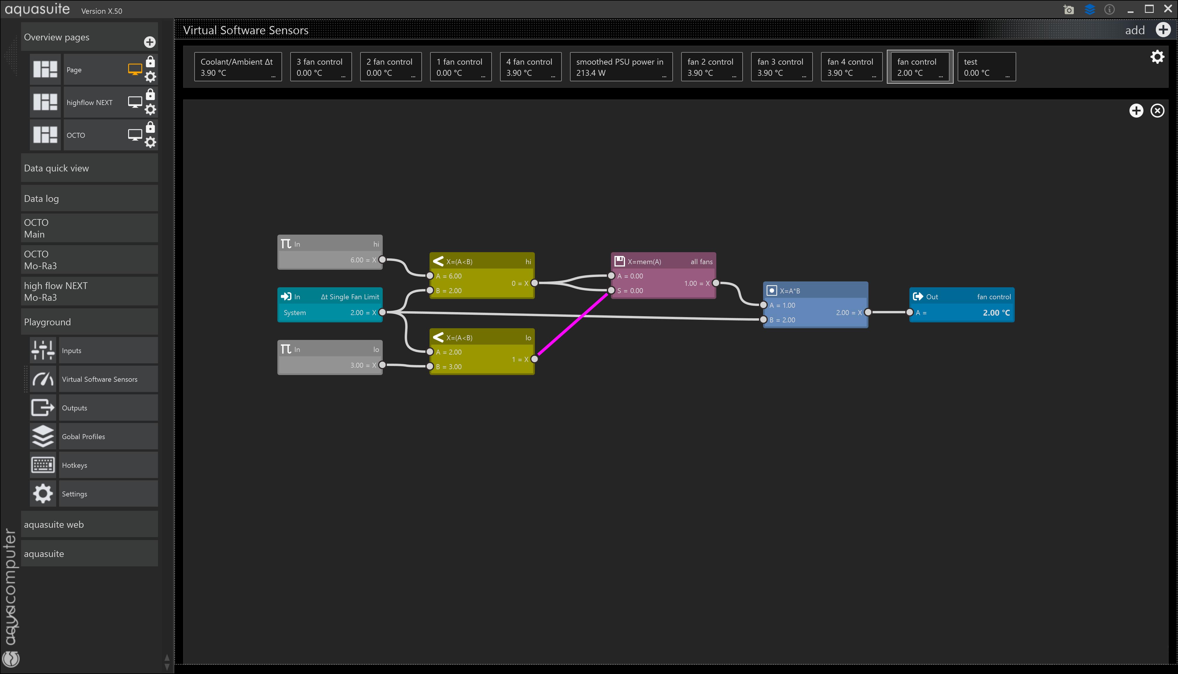

I am very pleased with the outcome. One function (memory) was all it took (excepting the dispensable OR)
Time gate at the top & temperature gate at the bottom (fan_controller.jpg)
