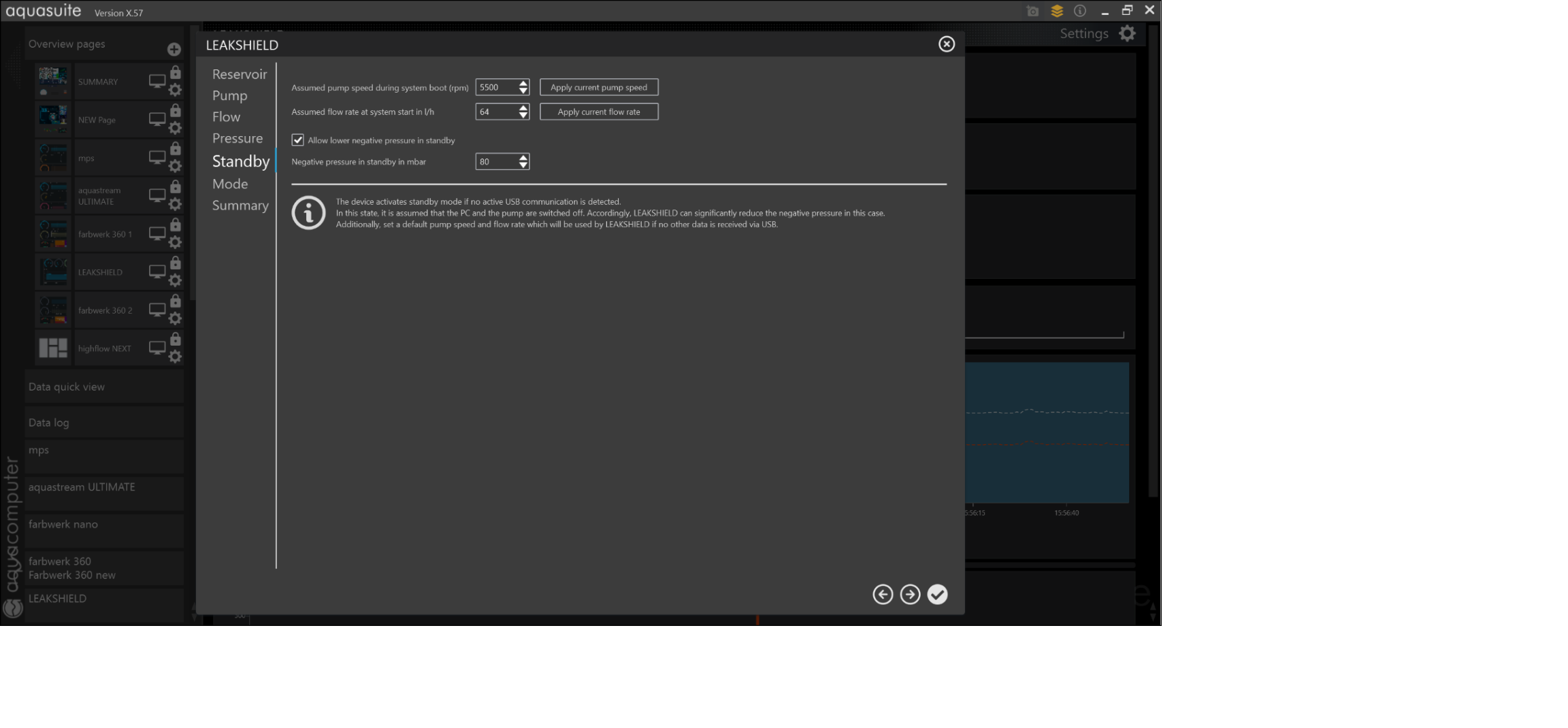

Stark
Sunday, September 4th 2022, 8:40pm
What happens when you go to Leakshield -> Settings -> Standby and uncheck the box "Allow negative pressure in standby"?
This setting will work only if the Leakshield has power while the system is in Standby. You may need to enable USB power during standby in the motherboard BIOS.
I will try an reply, but iI need to drain all the water again, dry the membrane and refill the water, which will take 3 days (. Now the Leakshield is actually not working due to the membrane again, 40+ times flooded.
Stark has attached the following image:
cptninc
Sunday, September 4th 2022, 8:59pm
This is a lot of attitude from a guy who bought a leak protection device and is now upset that it protects from the leak in his loop.
Fix your leak and the problem will go away. Good luck.
I'm out.
