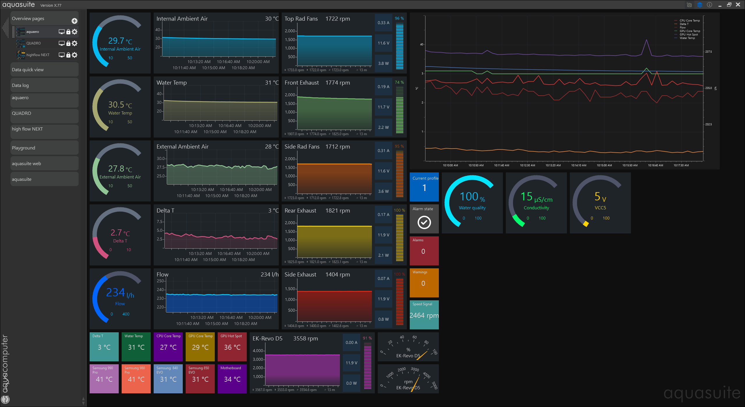

Bartdude
Sunday, February 4th 2024, 11:24am
Here's a SS of my setup with water quality etc
Bartdude has attached the following image:
Monday, February 5th 2024, 2:09am
I don't know why you are getting that low value for conductivity with Cyrofuel. Aquacomputer specs for the High Flow Next say the sensor can measure from 2 to 200uS/cm. EK specs for cryofuel says conductivity is 1.04mS/cm (1040uS/cm) +/-10% That is way beyond the maximum value that the sensor can measure. There are many ways to measure flow rate but AFAIK, there is only 1 way to measure conductivity of a fluid. A voltage is applied so current flows between 2 (or sometimes 4) electrodes that are immersed in the fluid. The sensor calculates the resistance of the fluid by measuring the voltage drop across the electrodes and applying Ohm's Law. Conductance is the reciprocal of resistance The measured value is converted to conductivity by applying a calibration curve or formula specific to the sensor. Conductivity is affected by temperature so some conductivity measurement systems also include a temperature probe and apply a compensation value based on the measured temperature of the fluid.
Attempting to measure a fluid whose conductivity is much higher than the sensor can measure can cause a saturation effect that can cause the measurement system to become miscalibrated. Perhaps that is what is happening in your case. I suspect your Cryofuel's conductivity is not 15uS/cm. If is is, that would mean that the sodium 2-ethylhexanoate in the Cryofuel has been just about completely used up. Only Aquacomputer knows exactly what conductivity sensor is in the High Flow Next. Maybe one of them will chime in here.
