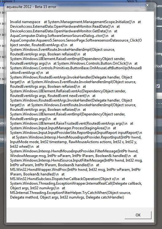

Fantastic Firmware update! this is leaps and bounds above Beta14!!
My display is finally working again. (The water flow kept jilting the screen out of sync) and the additional information pages has been long awaited.
I have one small problem however, when trying to access the software sensor data source.
I get the following error.
http://img526.imageshack.us/img526/9636/…twaresensor.jpg
I have checked the service which has started correctly, and AIDA64 WMI has been enabled. I did use Alpha 2 prior to this firmware update, but have removed it.
Hope this can get sorted.
Thanks

Agree with OC2000 above & also getting the same error message :)... Also in the "Imformation Pages Menu" I only get a choice up to 4 fans to drag across to the Show on screen menu & can only find the one Flow meter whereas before we had a choice of 3 flow monitors screens!!...

Same problem over here. It apears when I click on "select datasource".

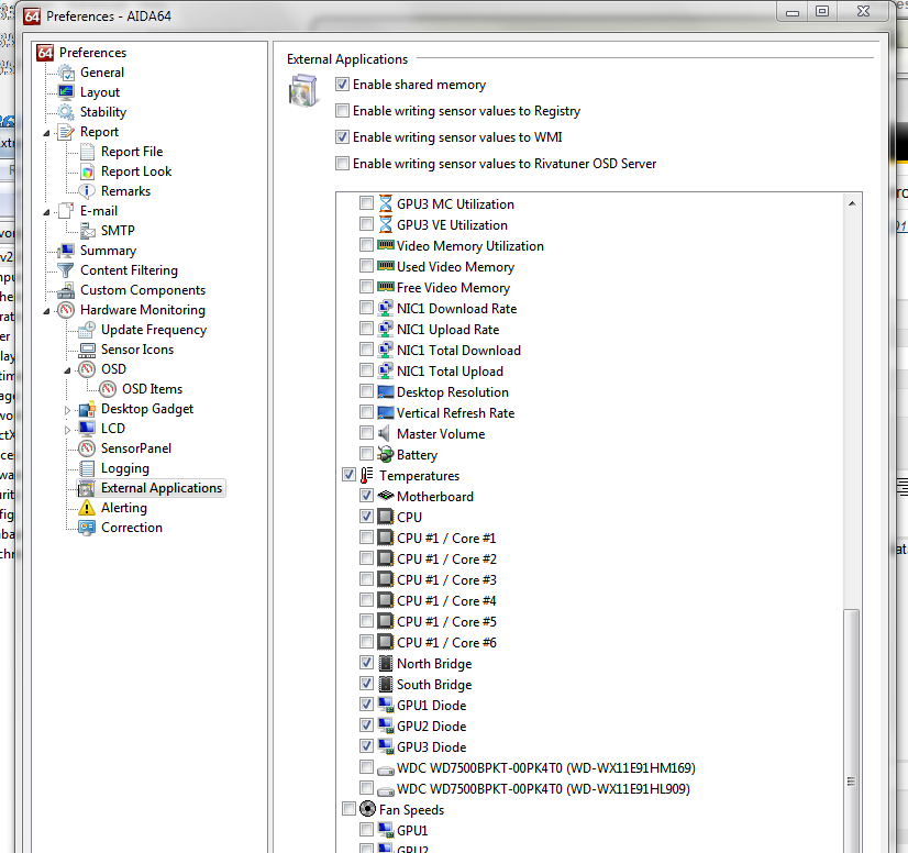

Ok, with open hardware monitor works. So the problem is with aida64.
Edit: It works now. In Preferences of aida64 | external aplications, the WMI check must be active.

Excellent firmware update, however, I have the same error message. When I press "select datasource" in software temperature sensors I get the same error message popup and aquasuite shuts down. I have WMI enabled in AIDA64. Any suggestions?

Have you also selected any sensor values to be exported via WMI?
cc01
mercredi 25 juillet 2012, 13:01
Yes, I have selected a few of the temperature sensors.

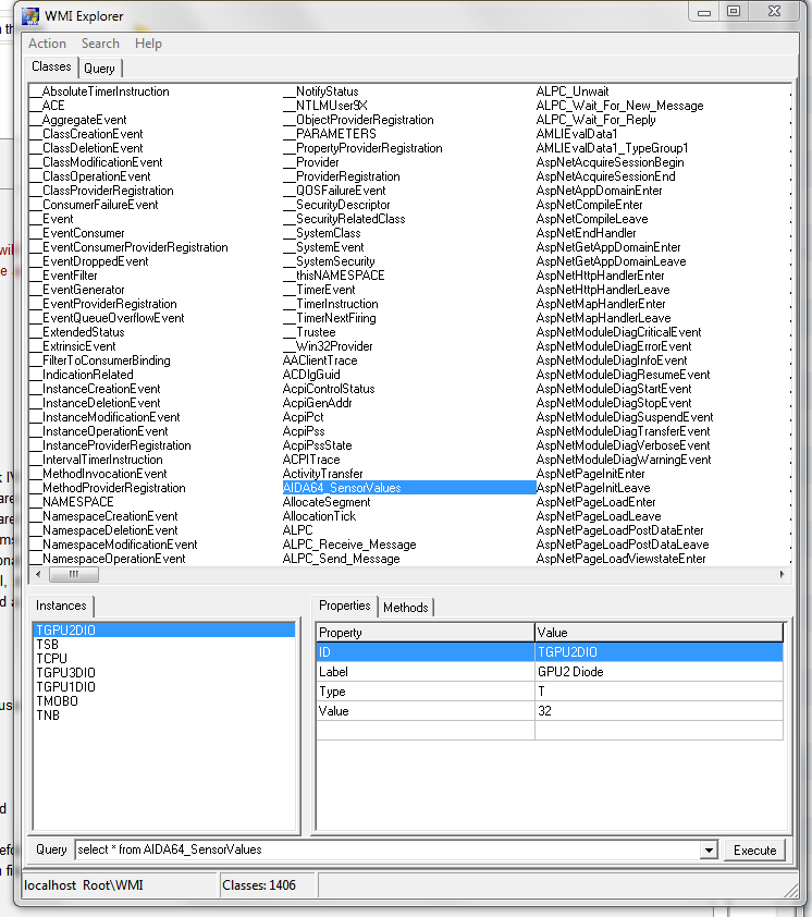

you can check the Sensor export from adida with ths tool:
WMI Explorer 1.12 from http://www.ks-soft.net/
in the namespace Root\WMI we search the aida sensor values.

Thanks, I've checked everything and still get the same error when I try to "select datasource". Anything else I should be looking for?

I've managed to get the software sensors working now. I simply shut down AIDA64 completely, including Windows startup, enabled and configured the sensors in Aquasuite, then restarted AIDA64. All is working well. :)
