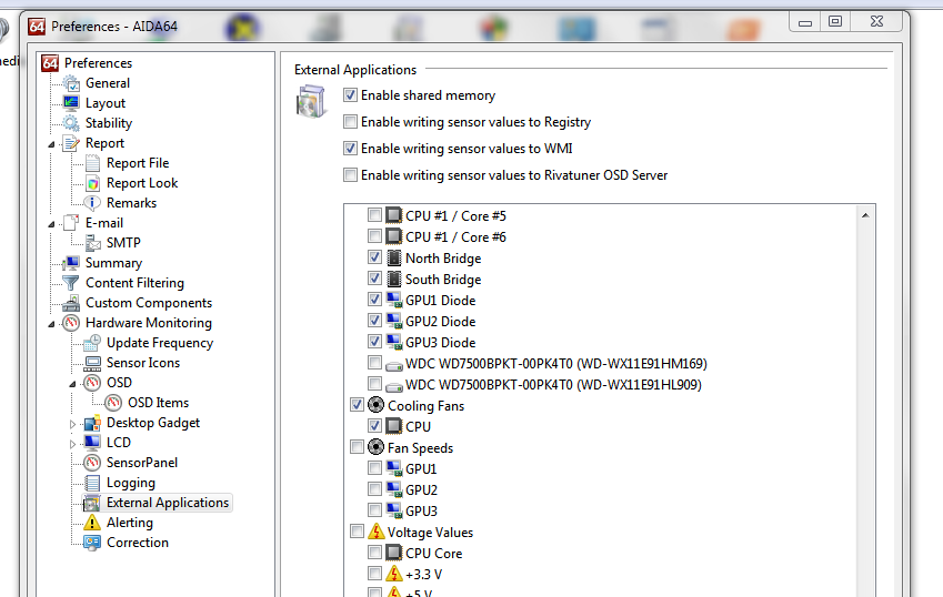

You don't need the old software sensor tool anymore and it is probably why you are getting errors. Shut down AIDA64 completely and configure the sensors in Aquasuite. Restart AIDA64 with WMI export enabled and some sensor values selected. You should then be able to "select datasource".
»cc01« hat folgendes Bild angehängt:
