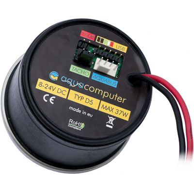

The Aquabus pumps are controlled and don't have a physical dial to change the speed. How would I change the speed if I can only have 4 plugged in?
Do you know what the standard speed will be on them?
I've attatched a pic of the pumps i'm using.
Thanks

You can only control a maximum of 4 of these pumps on one Aquaero. To control another 4 pumps I assume you would simply have to use a second Aquaero. The pumps do not have a 'standard' speed but they are set at 100% output when they are shipped. To change this connect them via USB and change the output in the Aquasuite software.
Hi mganddrea
As cc01 said really, Because you can only connect & control 4 of these pumps Via the Aquabus at any one time (the Aquaero see's these pumps as MPS devices (Multi purpose Sensors)) you'd have to either set the other 4 pumps manually Via their USB or get a second Aquaero (an LT variant would suffice for this). Also as cc01 says I believe the pumps come set as 100% from the factory...
The MPS Sensors include the Fill Level/Pressure Sensors, MPS Flow Sensors e.t.c.... So if you use up the 4 MPS slots that can be connected to the Aquaero at any one time with 4 of your 8 pumps, any other MPS devices you wanted to use would need to be connected Via USB...

I don't know whether that was just one of the quirks of Aquasuite and with a bit of restarting and resetting it might have worked? However I didn't want to mess with it any more than I had already and maybe have to reset everything back to factory.
When I changed pump 2 back to address 13 and restarted AS again both pumps were available again to add to a controller.
I can't explain it or rule anything out but that is what I saw in a quick test.
