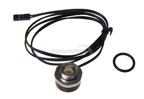

Also, I have 14 inline temperature sensors. Can they all be connected?

There is a total of 8 temperature headers per Aquaero, so two units run separately would give you 16. BUT if one of the units is an LT run as a slave, you give up almost all the functionality except for power control of the 4 fan headers of the LT. Make sure you understand what that means.....you won't have access to pwm control of the Fan 4 header of the LT, the flow meter input and all other inputs will be unavailable as well. Also the aquabus of the LT will be tied up so any periphereals like Power Adjusts have to be connected to the Master unit so that's another limitation.
