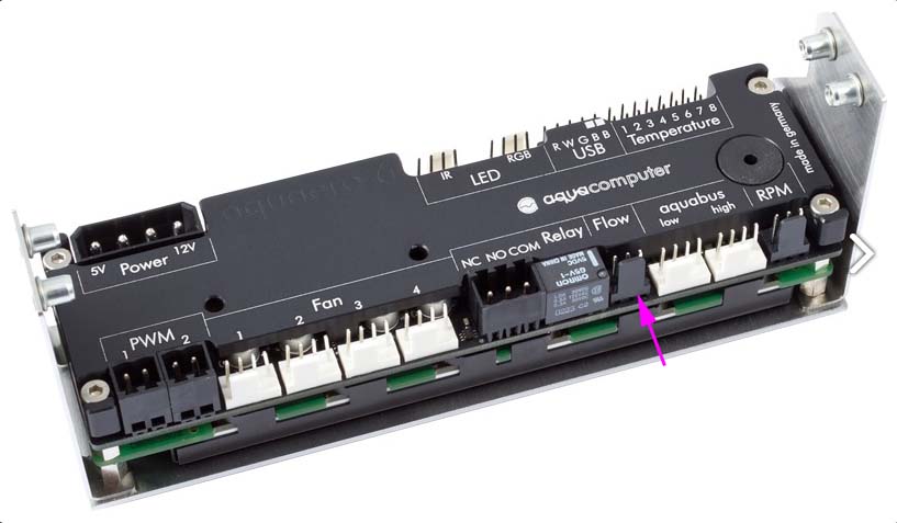

Hello again! Some time ago I bought the pumps(aquacomputer) and the aquaero 6. Now I bought EKWB's dual D5 top, I still have some things to buy but I would like to discuss the connections.
So I can connect both the pumps into one PWM output with a pwm splitter or connect them to pwms separately? Which is better? Same for the fans(4 of them)?
Also got a flow sensor(aquacomputer), it comes with a usb 5 pin cable and a 3 pin cable.
So with the 3 pin you connect it to aquaero's far right connector(RPM)? I guess the 5 pin is only if you don't have an aquaero so you connect to the mobo?

lundi 27 avril 2015, 04:26
I do not have that unit, but from what I gather reading the aquaero 6 manual, section 4 & 4.10 you connect the Flow Sensor to the Flow Port on the aquaero with the 3 pin cable.
You calibrate the aquaero for that particular sensor either in aquasuite (using the USB connection from the aquaero to the mobo), or via the infrared remote controller (sans USB connection).
The RPM port is an output that sends an artificial CPU fan RPM which can be set to zero by the alarm section. Since you are water cooled there is no CPU fan, but this simulates a fan failure for the mobo.
As to the pump connections, I will leave that to someone with PWM experience to reply.

Sorry to butt in here chaps but thought I would mention something before you connect things up and destroy something (highly likely as the Aquaero & it's relative items that connect to it are prone to something going pop if connected wrongly ;) ).... @ MP7, The AQ flow meter you linked to doesn't come with any leads as you need to buy the 3 pin flow cable for it separately (at least this was the case the last time I purchased one of these regular AQ flow meters, A good while ago now I admit, so maybe AC has changed what they send in the box with it now).
Anyway, You said you had a USB lead & 3 pin cable, that came with the flow meter, If this is the case then I think you must have bought the "USB" version of the same type flow meter!! This one USB/AQAUBUS, If this is the actual one you mean't to link too instead of the basic type one you linked too, Then, you in fact connect this USB version one to the HIGH SPEED Aquabus on the Aquaero using the 3 pin cable going from the Aquabus header on the flow meter & and not to the "Flow" connection on the Aquaero!!!, The USB cable that comes with the "USB" High Flow" Meter I think you mean't to link too, Connects to the Motherboard internal USB header....
OK... Now in case I got this all totally wrong e.t.c & I have read this all wrong :wacko: , Then please ignore this silly old fart & sorry I butted in e.t.c & hope you get it all sorted good & grand :D ...
