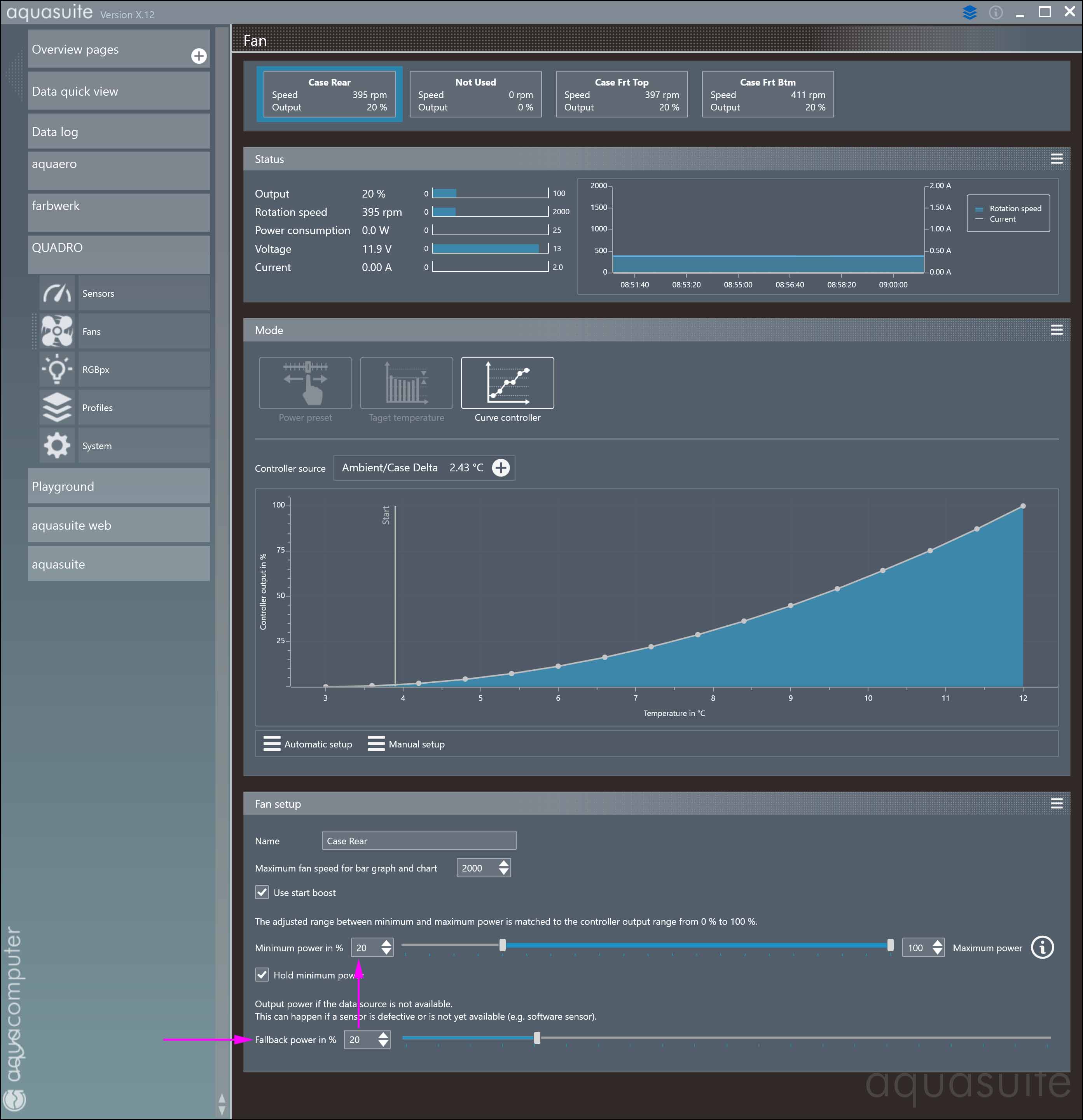

I set up my case-rear-fan on a curve with 'Minimum power' at 20%, and the fallback setting at 20% case_rear.jpg

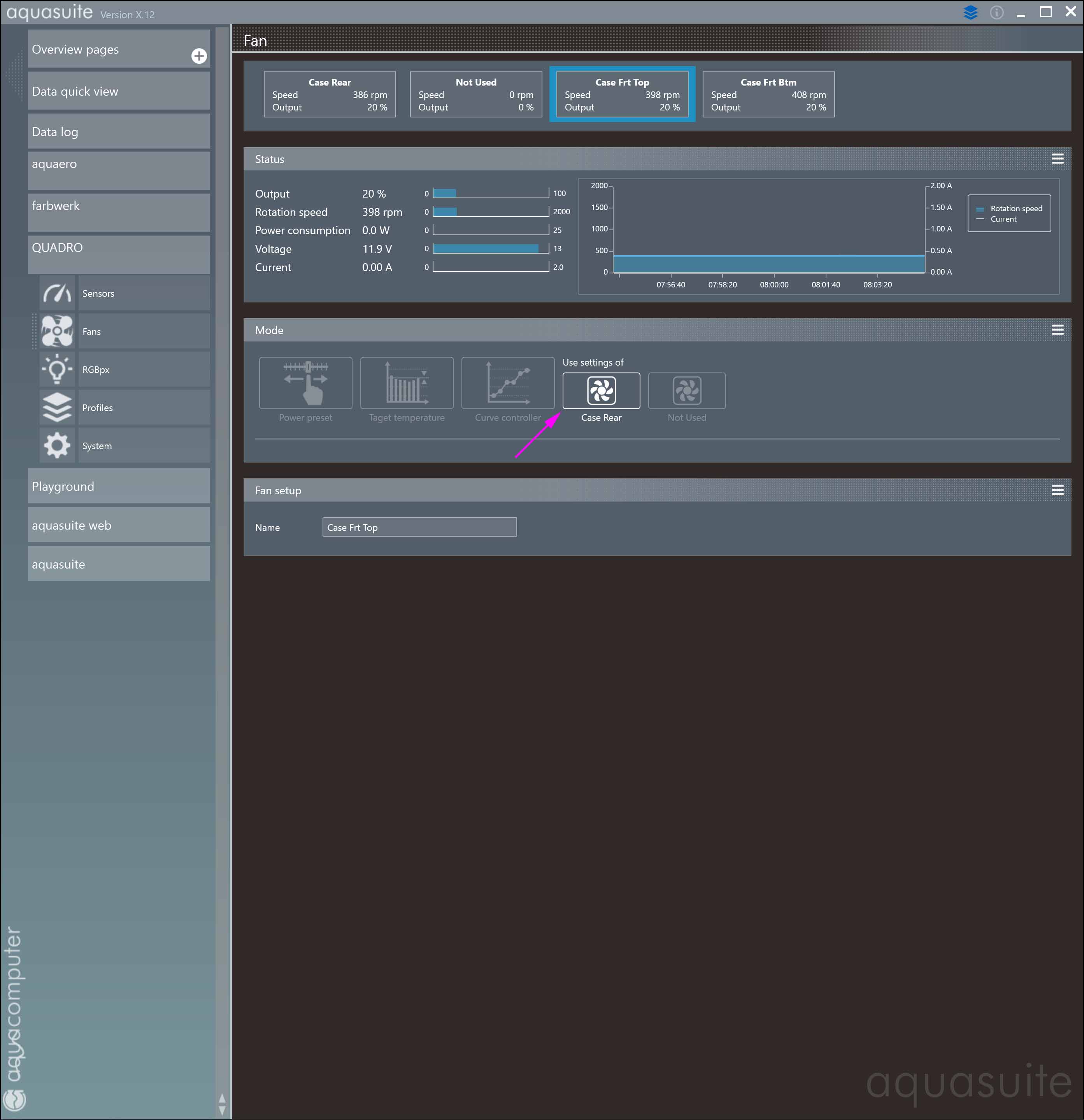

Then I 'Copy' the case-rear-fan to case-frt-top & case-frt-btm case_frt_top.jpg case_frt_btm.jpg
When I remove the input sensor, the case-rear-fan functions as expected, but the two copied fans do NOT. copy_setting_fail.jpg
It appears the 'Copy' function does not carry over the new 'Fallback' functionality.

Thanks. We will check this.
mardi 3 mars 2020, 16:38
Has been fixed in the new X.13 version available right now.
