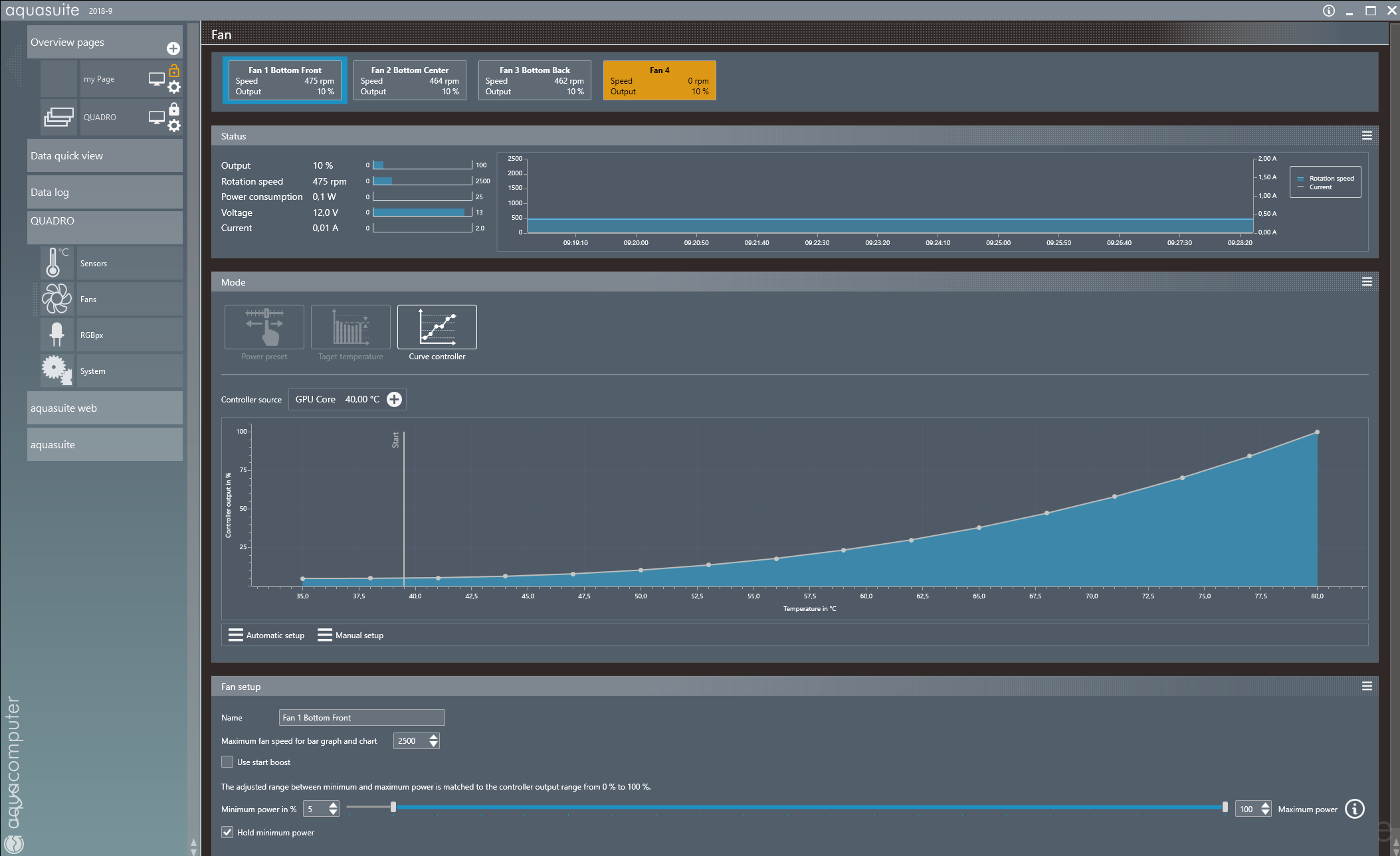

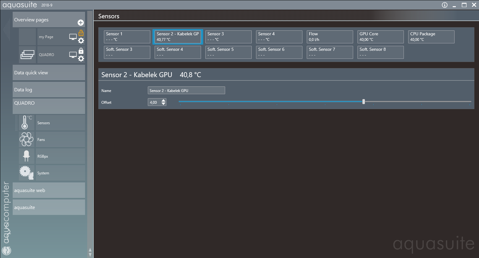

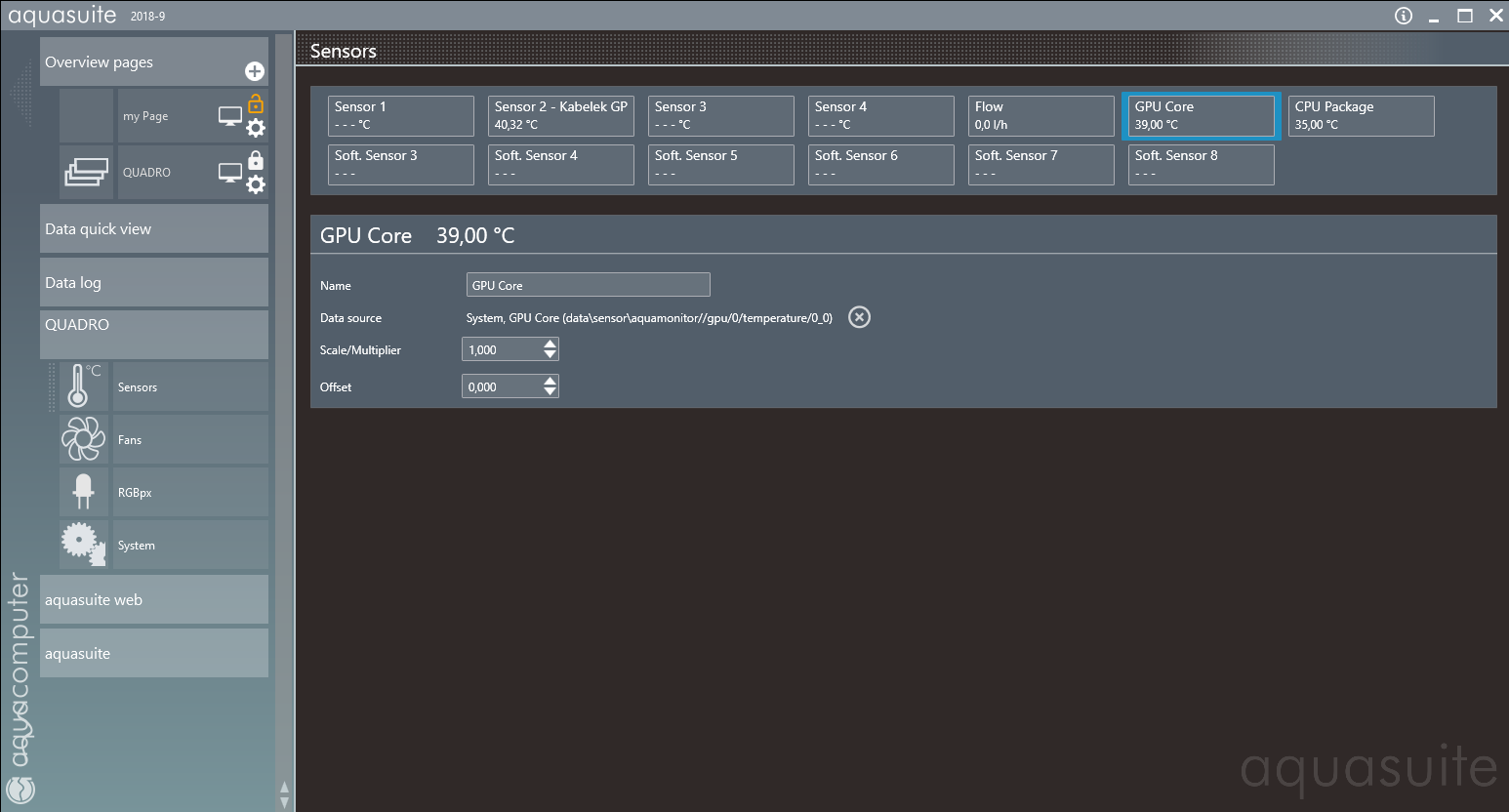

Can you provide an screenshot of the Aquasuite of the page in which you can configure the software sensors? The "farbwerk" for example is also able to have a fallback value configured. Would be suprised if the QUADRO doesnt have it, when not request the feature per mail or in the QUARDO Thread.
orkusmg
Dienstag, 8. Januar 2019, 09:35
This is how it looks (1st four sensors are the HW temp sensors, than the flow and rest of them are SW sensors, where in my case I use GPU & CPU sw sensors).
I have attached 3 screens, SW sensor options, HW sensor options and FAN setup page.

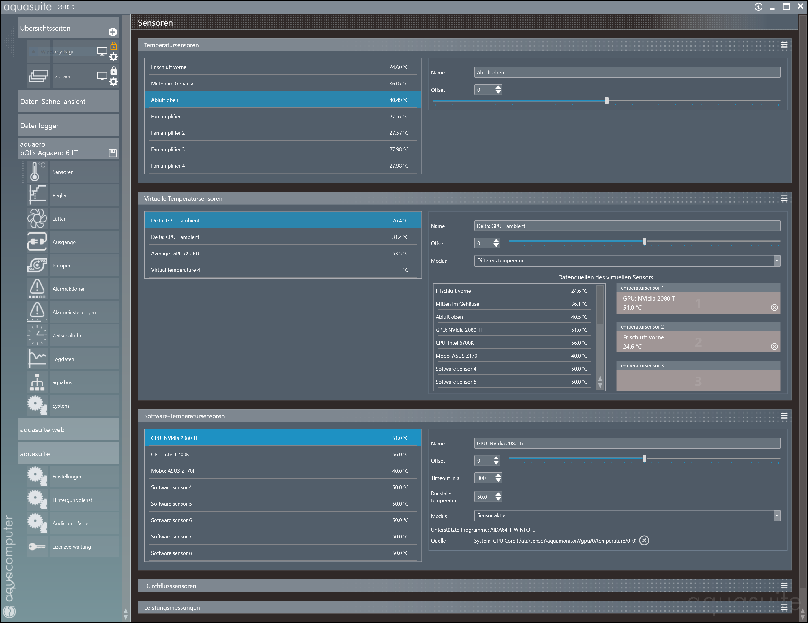

boli
Dienstag, 8. Januar 2019, 20:01
Got my Aquaero 6 LT today, and installed it next to my PC temporarily for testing, to play around with it a little bit.
Like you, I added the GPU core temperature as a software sensor, and like the manual suggested, it does have a fallback temperature (called Rückfall-temperatur in the picture).
The relevant part is the bottom right of the picture. Compared to your first picture it becomes evident that your Quadro does not have this ability, just like the manual suggested. :(
But like Chris suggested, maybe asking AC if they could add this ability might help. Or maybe there's some other solution. As a workaround you probably could just sleep your PC instead of shutting it down. :rolleyes:
But then again, based on your eventual target configuration it won't really be an issue anyway.
»boli« hat folgendes Bild angehängt:
Dieser Beitrag wurde bereits 2 mal editiert, zuletzt von »boli« (8. Januar 2019, 20:10)

DaDoBaag
Sonntag, 19. Februar 2023, 17:12
I must be doing something wrong then. As you can see in the image below I have set the fallback power of my fans to 10% but on startup they still blast at 100% for a few seconds.
But I shouldn't even need a fallback value in the first place because the fan curve is based on a temperature sensor that's directly plugged into the Quadro, not a software sensor.
So why are they still going to max speed on startup?
Remayz
Montag, 20. Februar 2023, 16:12
weird. Mines don't.
I have "hold minimum power" un-ticked though.
can you show a screenshot of the whole fan channel window, to see the fan curve you got?
