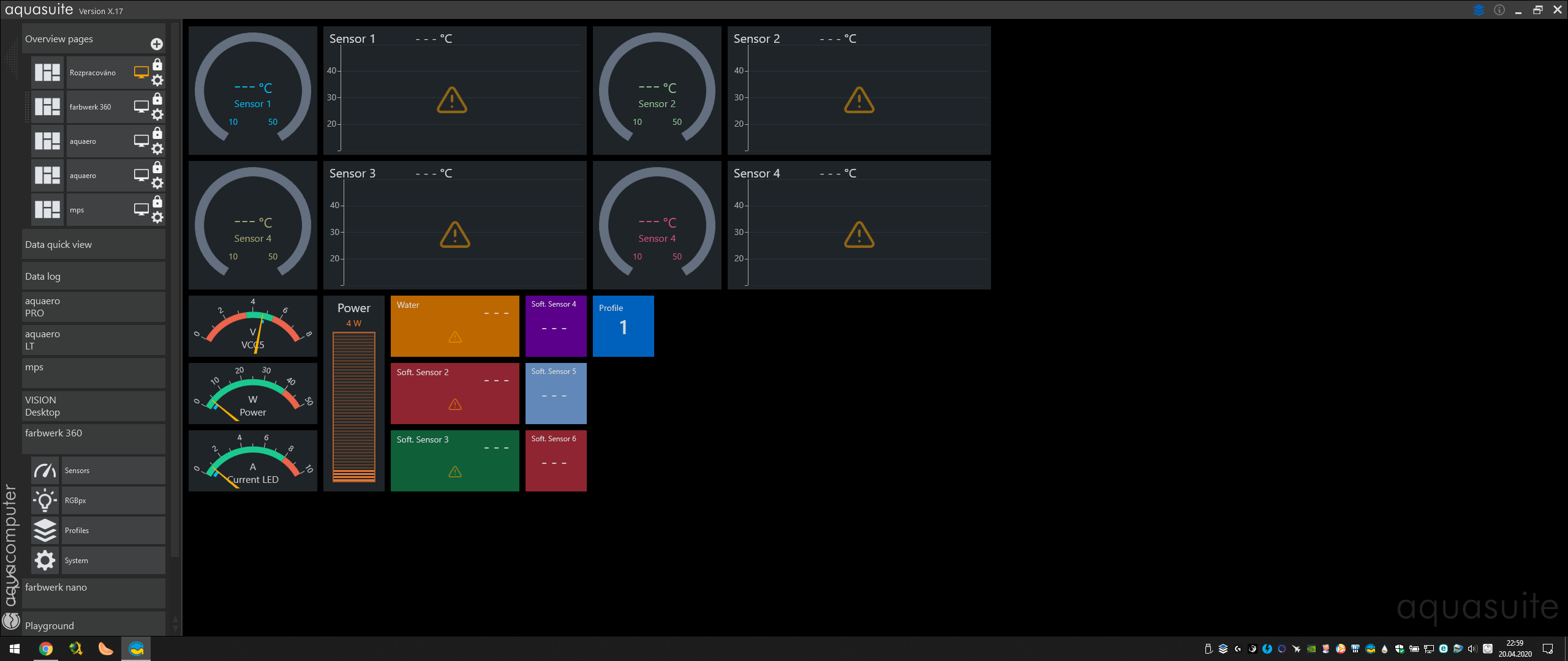

Yesterday I received almost all AC shipment and today I ve stared unpacking and connecting everything, so I decided to start with Farbwerk 360, out of 4 LED strips two wont light up and one have defective last LED light (its just blinking),when I tried to change colors, it gave mi this error... Nothing seams broken of flimsy on the connectors... Does anyone have any idea on what to do? try? ?(

Please see attached pictures and post same ones.
I think that best way is to connect only one strip and test each channel separate.

Can you please post same images as me. Important is 5V voltage.
There was an error message- voltage out of range, visible on your post.

It seems that posted page is with farbwerk 360 without load. Voltage is OK. If you light up all strips (1 per chanell) what is visual of this page of farbwerk 360?
Please post photo of connection strip to strip, important is that strip has IN and OUT and connection cable between strips is twisted, not in the line.
