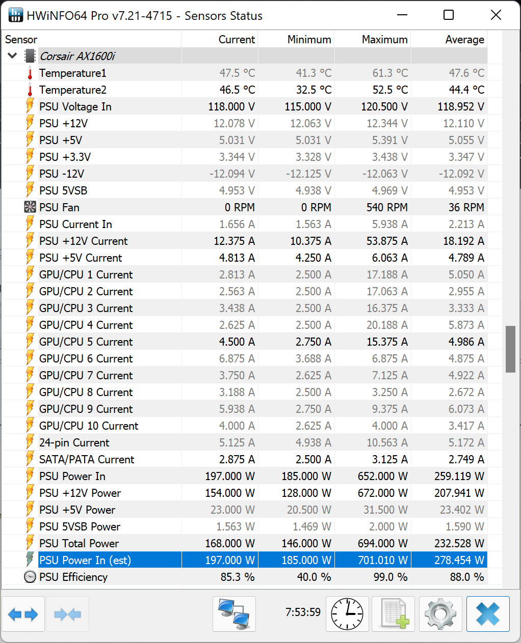

Yes, am currently triggering all fans when the PSU puts out more than 350 Watts. (psu.jpg)
Still would like to take it to temp sense, not giving up yet.

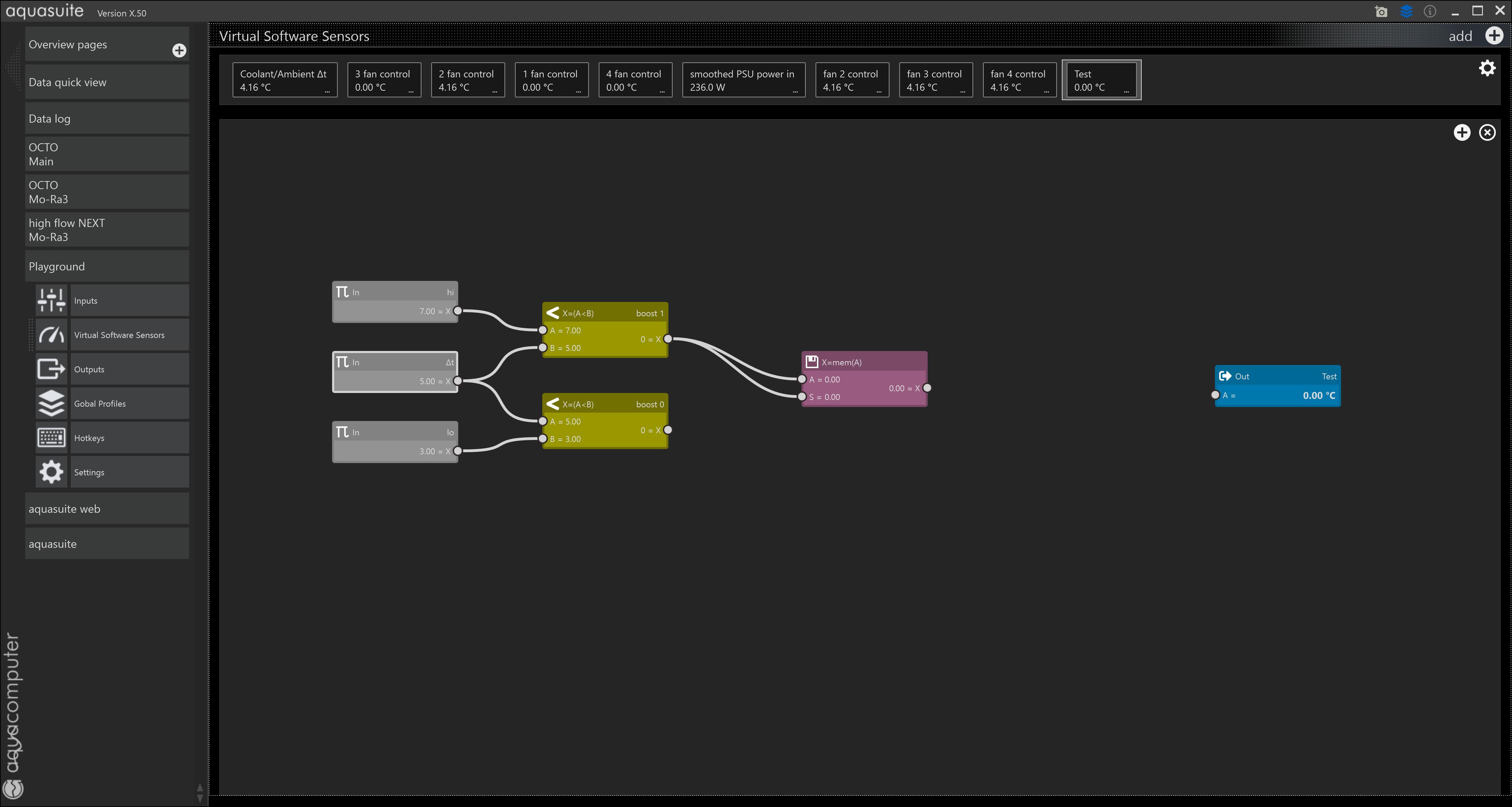

mercredi 9 mars 2022, 14:44
Interesting solutions.
I would not be averse to the authors posting an exported virtual sensor.
I know the sources would require updating, but it would help sight challenged folks like me. :)
Note to aquasuite developers.
The "X=mem(A) function appears to have a bug.
  • it passes A to X properly when S = 1 (hi.jpg)
  • but when S drops to zero, it still passes the A value to X (ok.jpg)
  • if we can get that corrected AND (please) allow multiple sources to trigger the S, I believe the function would be more useful (lo.jpg)
Ce message a été modifié 1 fois. Dernière modification effectuée par "InfoSeeker" (9 mars 2022, 14:46)
  • it passes A to X properly when S = 1 ([attach]9270[/attach])
  • but when S drops to zero, it still passes the A value to X ([attach]9271[/attach])
  • if we can get that corrected AND (please) allow multiple sources to trigger the S, I believe the function would be more useful ([attach]9272[/attach])
is it a bug ??
the descriptions says :
Persistent Storage
If S >0, then A is Saved and forwarded to X
To me it's working as described.
The key words are "Persistent" and "Saved"
Doesn't go on to say
"If S = 0, then X is reset to 0"
Ce message a été modifié 1 fois. Dernière modification effectuée par "WinstonWoof" (9 mars 2022, 15:17)
mercredi 9 mars 2022, 15:33
is it a bug ??
Persistent Storage
It may be my interpretation is incorrect.
To me persistent remains until changed.
If S is 1, A is passed to X.
If S is zero, A can change, but X remains as it was until S switches to >0 again.
What I see happening is when S goes to zero, X goes to zero.
I see that more as following than persistent.
