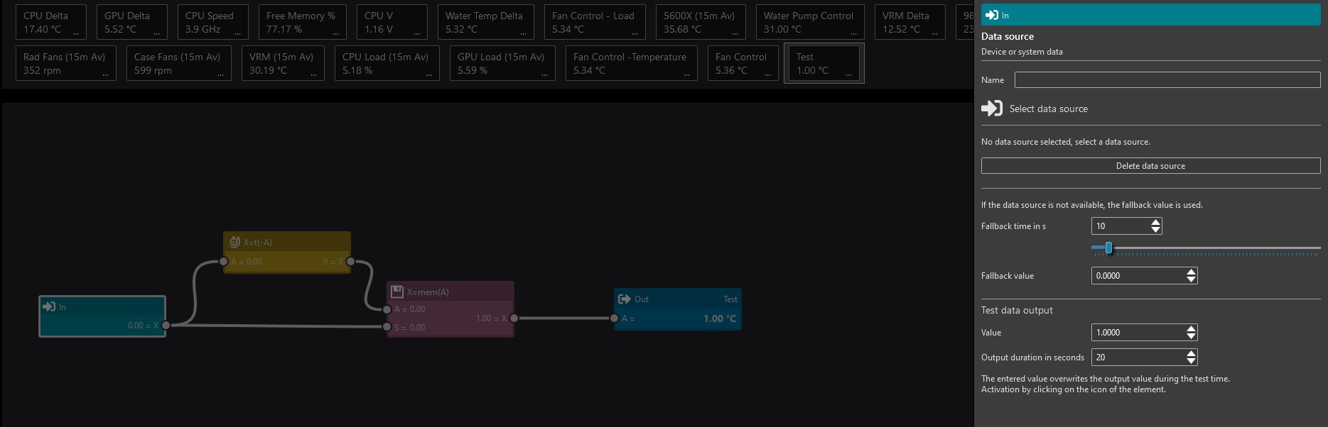

  • both inputs are 1 (1.jpg)
  • drop the S input to 0 (0.jpg) fail
jeudi 10 mars 2022, 05:05
Something else I am misunderstanding: how the X=t(+A) Logic Function works.
The cheat says "Output switches off delayed if input <= to 0". Having a 7 sec delay dialed in, I expect the following:
  • (input1.jpg)
  • input is dropped from 1 to 0
  • S on function X=mem(+A) goes to 0
  • A on function X=t(+A) goes to 0, this starts a 7 second countdown
  • at the end of the 7 second countdown, A on function X=mem(A) drops to zero
  • (input0.jpg)
But what I see is S & A on the function X=mem(A), both dropping to 0 immediately

jeudi 10 mars 2022, 07:27
When you change somthing in your flow, everything in the flow restart.
You cant test it in this way with using constants and changing it. you have to use data sources / sensor values / input values.

For testing rather than use a constant as an Input use a Sensor input .
No need to define the source just set the Fallback value & Test Data Output values making sure the output duration is greater than your delay.
Then to test Right click on the Sensor input and select Output Test Value.
Aha... that is what Remayz was hinting at. I did not think changing a constant input effected the flow, but in retrospect I understand.
I'll use inputs or test as WinstonWoof suggested.
