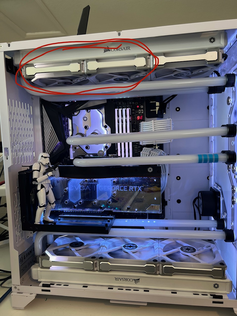

Hello! I hope this community can help me out with my build!
I have a Lian Li 011 Dynamic XL water-cooled build with the following components I need help with:
I will specify details about the build that are pertinent to my challenge in parentheses ()
  • EK Quantum Momentum Monoblock (w/ rgb)
  • EK Quantum Reflection Distro plate (w/ D5) (w/rgb)
  • Alphacool 17363 Eiszapfen Temperature Sensor
  • QTY: 6 Lian Li SL120 uni fans (in two "clusters" <- this makes sense if you're familiar with these fans I hope)
  • Aorus x570 Master MB that has (6 Fan headers, 2 RGB headers, 2 ARGB headers, two temperature headers)
Everything is "working" except I am having issues with the RGB on two of the Lian Li SL120 fans (the last two of cluster one)
I am going to ditch the Lian Li Hub and have purchased the:
  • OCTO
  • FARBWEK 360
  • Cables and adapters to convert the proprietary Lian Li Uni Fan cables to RGBpx
As I understood it, the OCTO can only handle a certain number of LEDs per channel, (90?) but is that per plug or for the whole device? The Lian Li fans have 16 LEDs per fan for a total of 48 per "cluster".
  • Can the OCTO drive all 96 LED's if I only connect 48 LEDs per plug?
  • What is the best way to connect all of this together??
OTHER QUESTIONS:
Is there a way to "daisy-chain" the FARBWERK and the OCTO, or are they 2 independent devices require their own Molex and USB headers?
inetwebguy a envoyé le fichier suivant :
  • PC.jpg (342,53 kB - téléchargé 250 fois - Dernier téléchargement : Hier, 12:25)
