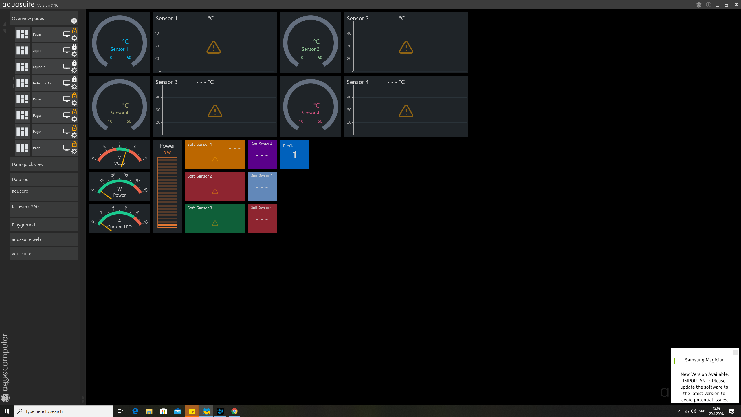

Maki911
dimanche 12 avril 2020, 21:16
Now just one LED strip work with all channels..
AE5probigNGslave
dimanche 12 avril 2020, 21:24
Can you please post same images as me. Important is 5V voltage.
There was an error message- voltage out of range, visible on your post.
Maki911
lundi 13 avril 2020, 20:28
Sorry, I totally forgot to take a screenshot....

AE5probigNGslave
mardi 14 avril 2020, 17:17
It seems that posted page is with farbwerk 360 without load. Voltage is OK. If you light up all strips (1 per chanell) what is visual of this page of farbwerk 360?
Please post photo of connection strip to strip, important is that strip has IN and OUT and connection cable between strips is twisted, not in the line.
