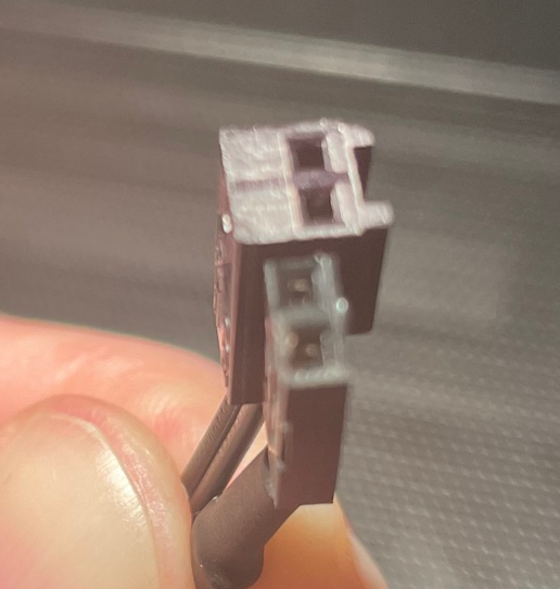

The temp sensors that come with the Commander Pro will work with the Octo but the 2-pin connector is much thicker than the connector on Aquacomputer temp sensors. Because the 4 temp sensor headers on the Octo are very close together, the Corsair temp sensor plugs will only fit in Octo temp sensor header #1 and #4. Its too thick to plug into temp sensor header #2 or #3. You get 1 Aquacomputer temp sensor #53026with the Octo. I have attached some photos that show a Corsair temp sensor 2-pin connector and an Aquacomputer 2-pin temp sensor connector. You can see how much thicker the Corsair one is. If you need to buy more temp sensors, the Phobya #71222 has a very thin 2-pin connector that will fit fine on any temp sensor header on the Octo.

[attach]9489[/attach]
[attach]9490[/attach]
[attach]9491[/attach]
Very nice and important information not to mistake! I have never gotten any idea about that...
I may need one additional sensor for ambient air temp. #53026 or #71222 will work for me.
Thank you, Speedy-VI
