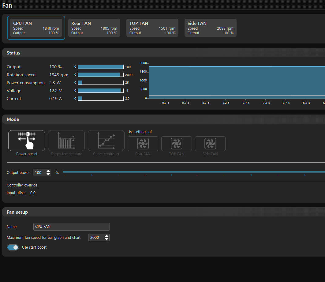

I recently purchased a QUADRO directly from Aqua Computer, but it is showing some strange behavior. One of the main advantages of the QUADRO — not having to worry about the stress of high fan RPM during system startup — has unfortunately disappeared.
Symptoms
  1. When I start the system, all four fans connected to the QUADRO run at 100%. The fans also briefly ramp up to 100% when shutting down the system.
  2. At first, I suspected this might be related to a virtual sensor, so I changed the control sensor to the QUADRO's actual physical Sensor 1. However, the same issue occurs.
  3. The fans only return to the fan curve I configured after I manually load the saved profile in aquasuite. However, I have to repeat this every time I start the system.
  4. Interestingly, when I restart the system rather than performing a full shutdown and startup, the fan settings are applied correctly without having to manually load the profile.
Things I have tried
  1. Reconnected the USB cable between the motherboard and the QUADRO.
  2. Reinstalled the latest version of aquasuite.
  3. Reset the QUADRO to its factory/default settings.
  4. Set Fallback Power In to 30%, but this did not resolve the issue.
At this point, I am not sure whether there is something wrong with the QUADRO I received or whether this is a software-related issue.
I have also contacted Aqua Computer by email, but I have not received a response yet.
I found a forum post from another user whose situation seems very similar to mine. However, I currently cannot tell how they solved the problem, if they were able to solve it at all.
Fans stuck at 100%
Has anyone experienced a similar issue or have any suggestions on what might be causing this?
(When system started, I just meet this aquadsuite quadro page. The “Use start boost” option is always enabled again when I start the system, even if I disable it before shutting down.)
