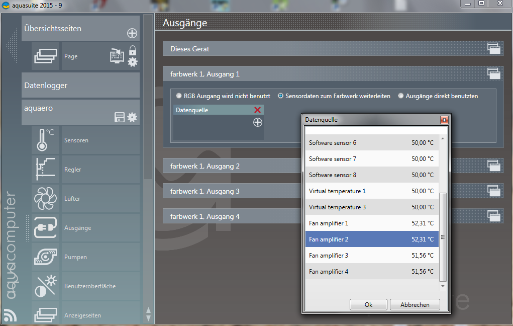

You can transmit an temperatur sensor as Software temperature sensor to the farbwerk from the aquaero to the farbwerk.
* You have to connect the aquabus to the aquaero.
* You have to unchek that the from the aquaero used sensor is used by Service in the farbwerk (usb) settings
[attach]5503[/attach]
Ok. So I understand this, can I use a physical temp sensor whether it be a air temp sensor or a water temp sensor to the AQ6 and than use the software and set it as a Software Temp Sensor and use that for control on LEDs?
Mittwoch, 2. Dezember 2015, 09:03
More or less...
In the aquaero you have to select the sensor that should be transfered to the farbwerk in the outputs tab.
In the farbwerk you have to disable the option to use the Aqua Computer service for this forwarded sensor because otherwise you will have a conflict where two devices try to access the data.
