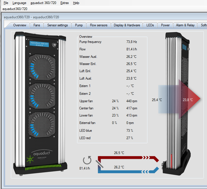

The progress is that the Aquasuite software runs fine, as long as I use it for a short time, say one minute or less. No matter how long the PC is on, at startup of the Aquasuite software my Aquaduct 360 XT is recognised just fine. So, conclusion, no problem between the Aquaduct and the PC. But there is this one thing that is strange...... the temperature of the air going in is higher than the temperature of the air going out, just take a look at the attachment for a screenprint. And that can't be right, right? So maybe the sensors are mixed up and the readings will cause a crash of the Aquasuite software. The temperature in the room is normal.
Arrrgh, forget the story above, the temperatures are allright but the arrow is pointing in the wrong direction, the warm air comes out at the back but the arrow points blue to red to the front. That was already the case in a previous version of the software as it is the same on the screenshot on the site of Aquacomputer. http://aquacomputer.de/aquaduct-xt.html
Can somebody fix that?
And is there anyone with a good solution for the crashing Aquasuite software???????
