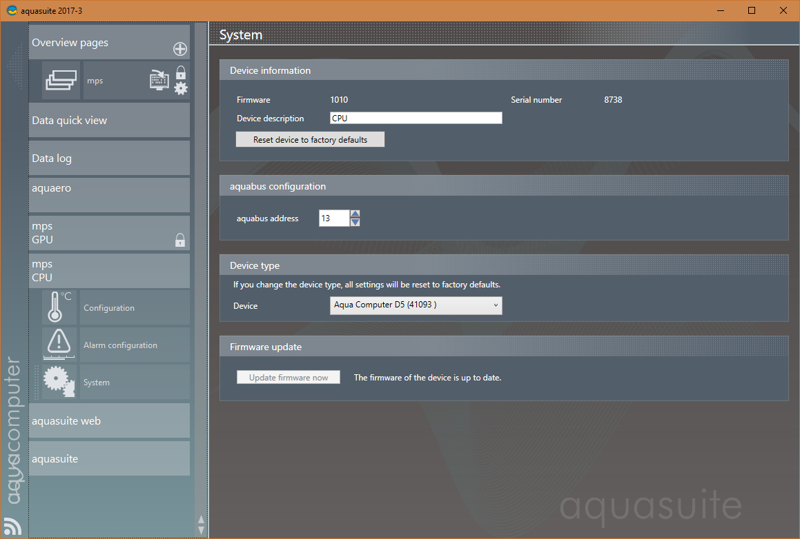

Still not working... :(
All firmware is updated (usb connection for both pumps works fine). I've tried all the following for the aquabus connection:
- Connect both pumps (using a splitter. Pump 1 on address 12, pump 2 on 13);
- Connect pump 1 with single cable
- Connect pump 2 with single cable
Using different cables, always shutting down the computer and disconnecting the PSU.
Really need help, guys! Any thoughts??
So you see the two pumps in the aquasuite tabs, but you do not see the pumps in the pumps tab under the aquaero?
A screenshot may be helpful.

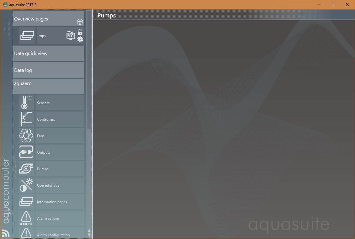

Exactly! Both pumps are available as mps, but under the aquaero "Pumps" it's empty. Screenshots attached, and thanks for the reply! :)

Sunday, November 5th 2017, 8:25am
are your 2 mps pumps listet as mps under aquabus tab?
Reset your 2 mps to factory defaults, switch the device type (system tab) to a other device and switch it back.
Select the bus address.
Save the settings (disk symbol).
When everything is correct you see the both pumps in the aquaero tab and see the mps devices in the aquabus tab.

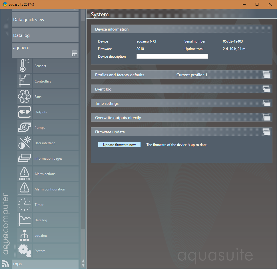

Agree! Is there any chance I can get previous firmware/aquasuite version to test my devices?? Still not working here. Spent the day rebuilding cables, changing connectors, shutting down, reset, rinse and repeat :(
I've noted another weird behavior under the aquaero tab: The "Update firmware now" (aquaero > system > Firmware update) is always enabled - see attachment. Even after updating, I can do the whole process again... Can you confirm if Firmware 2010 is the last release?? And do you guys have any other idea that I can try? Please??? ?(
