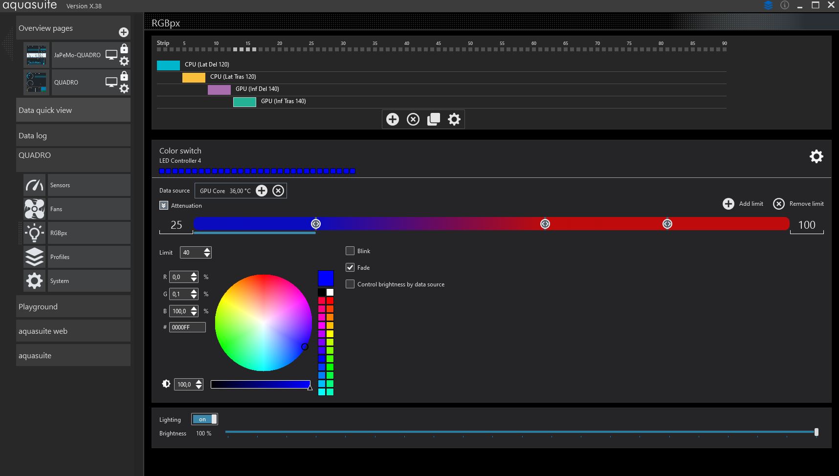

I'm having trouble setting up RGBx with QUADRO and SPLITTY 4.
I explain.
I have 4 Corsair ML120PRO RGB fans connected directly to QUADRO for power and SPLITTER 4 for RGB channels 1, 2, 3 and 4.
My intention is to configure them to give a range of colors depending on the temperature, 2 for the CPU and 2 for the GPU.
Being cold the color blue and hot red.
I attach a screenshot of how I have it configured.
Since I can't see the fan channels, I don't know if I'm doing it correctly ...
Thanks a lot.
Kind regards!!!!

Dienstag, 23. März 2021, 07:33
You can freely arrange the controllers.
Do the LEDs light up? If not, please describe your wiring.
japemo
Dienstag, 23. März 2021, 09:46
Hi Sebastian!!!
This is my wiring diagram
You can see that in Quadro I have each fan in a channel and this I can see in QUADRO/FANS
But In RGBpx I can see each fan channel to control RGB
Only I see strip and this is my doubt, I dont know and found how configure this part.
Noy my fans are iluminated but all same colors, but I want 1, 2 for CPU CPU and 3, 4 for GPU temp.
Do you understand me?
thanks!!!!
k2viper
Dienstag, 23. März 2021, 10:00
You need to know exact number of leds in each connected fan, and thus create a separate LED controller in Aquasuite for each fan connected, first controller for first fan from 1 to N LEDs, second from N+1 to 2N leds, third accordingly etc.
Meaning you have correctly connected all fans RGB to Splitty4 and it is connected from QUADRO RGBpx.

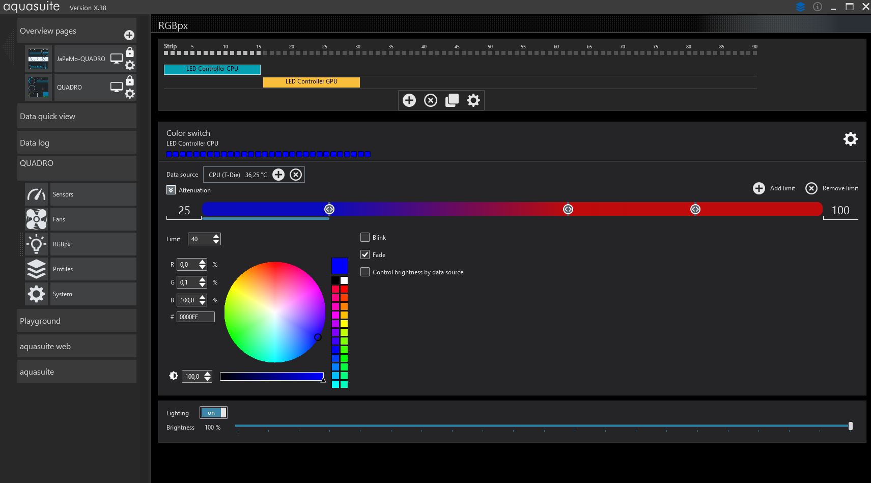

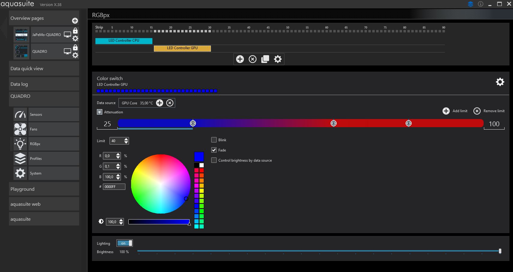

japemo
Dienstag, 23. März 2021, 10:17
I understand...
So the correct configuration would be like this ...
THX
k2viper
Dienstag, 23. März 2021, 10:40
japemo
Yes.
japemo
Dienstag, 23. März 2021, 10:44
japemo
Yes.
Thanks!!!!" :thumbup:
