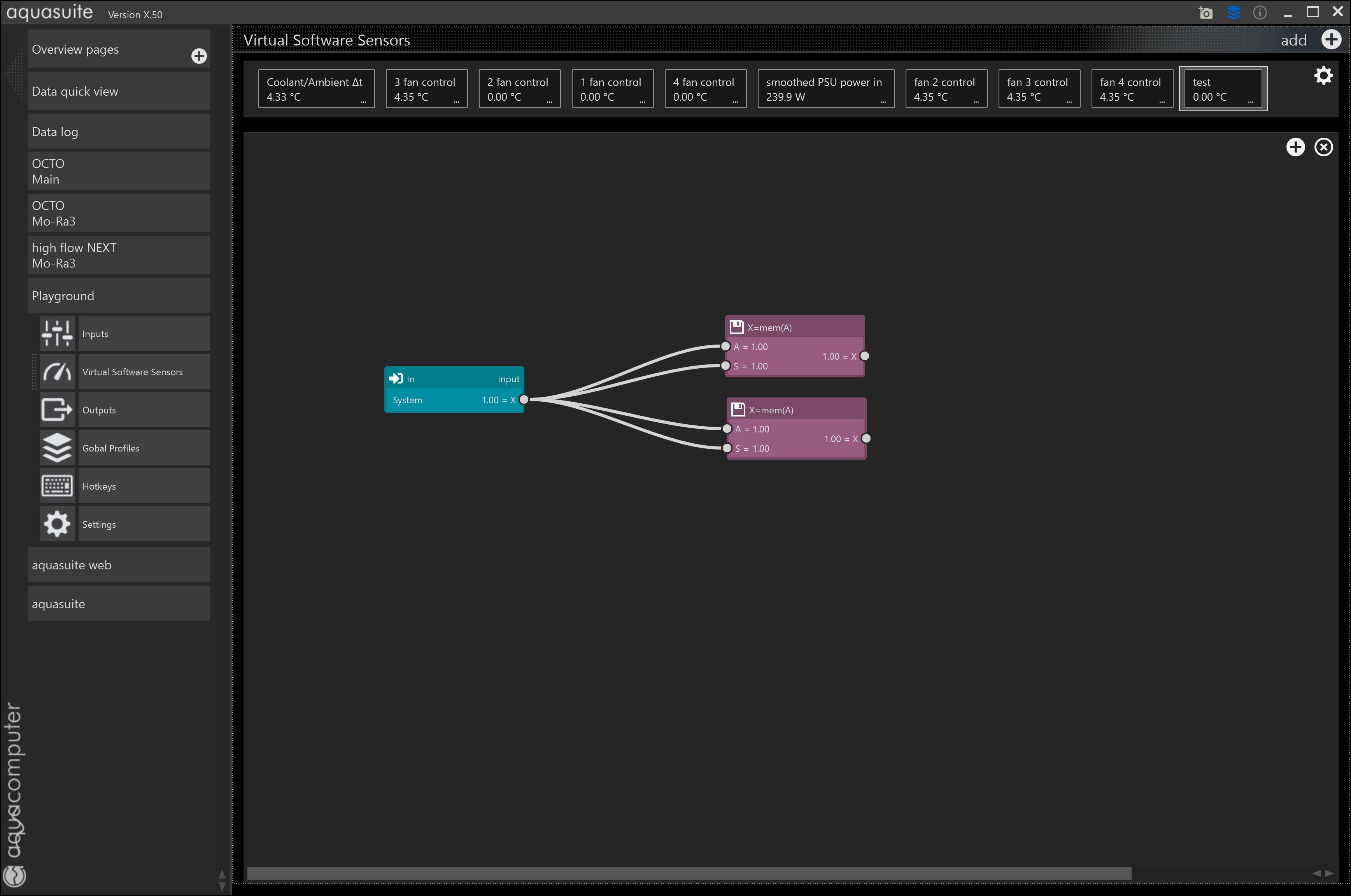

a little test
Mittwoch, 9. März 2022, 23:39
  • one input at 1 to two X=mem(A) = result as anticipated (input1-to-2xmem.jpg)
  • one input at 0 to two X=mem(A) = result as anticipated (input0_to+2xmem.jpg)
  • leave input at zero and delete one X=mem(A) = unexpected result (leave_input0_delete_1_xmem.jpg)
    the moment the 2nd X=mem(A) is deleted, the remaning X=mem(A) X value drops to 0
  • solution, add X=t(+A) to spoof the X=mem(A) to function as desired (delay_spoof.jpg)
  • minor issue - both delay icons in Logic Function Selector have a (-A), one should be a (+A) (delay_icon.jpg)

Donnerstag, 10. März 2022, 01:13
I feel like I am in the twilight zone, it works sometimes and not others.
  • both inputs are 1 (1.jpg)
  • drop the S input to 0 (0.jpg) fail
Donnerstag, 10. März 2022, 05:05
Something else I am misunderstanding: how the X=t(+A) Logic Function works.
The cheat says "Output switches off delayed if input <= to 0". Having a 7 sec delay dialed in, I expect the following:
  • (input1.jpg)
  • input is dropped from 1 to 0
  • S on function X=mem(+A) goes to 0
  • A on function X=t(+A) goes to 0, this starts a 7 second countdown
  • at the end of the 7 second countdown, A on function X=mem(A) drops to zero
  • (input0.jpg)
But what I see is S & A on the function X=mem(A), both dropping to 0 immediately

Donnerstag, 10. März 2022, 07:27
When you change somthing in your flow, everything in the flow restart.
You cant test it in this way with using constants and changing it. you have to use data sources / sensor values / input values.

Donnerstag, 10. März 2022, 13:43
Aha... that is what Remayz was hinting at. I did not think changing a constant input effected the flow, but in retrospect I understand.
I'll use inputs or test as WinstonWoof suggested.

Freitag, 11. März 2022, 22:51
Yes, the "Twilight Zone" was a result of having changed a variable using Input (worked) and modifying a constant (fail).
Currently I have not experienced what the difference is between the two memory functions.
If it is as Remayz opined, one is curious how to recall the value.
I am very pleased with the outcome. One function (memory) was all it took (excepting the dispensable OR)
