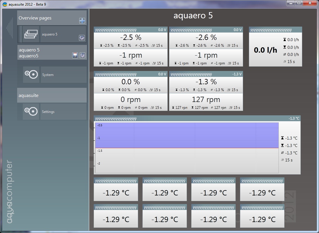

I'm building a new system with an aquaero 5 LT and I've set up the software. When I open the software and go to the settings, it does see the aquaero 5 LT, firmware 1010.
When I add the default page view, all of the sensor data shows nonsensical data, with each view showin 'yyyyyyyy' at the top / headers. Can't seem to adjust anything.
Also, in trying to update the firmware to 1018, it fails.

The data view once aquaero is started (cannot change any of the graphs, and they don't update):
-data.jpg below

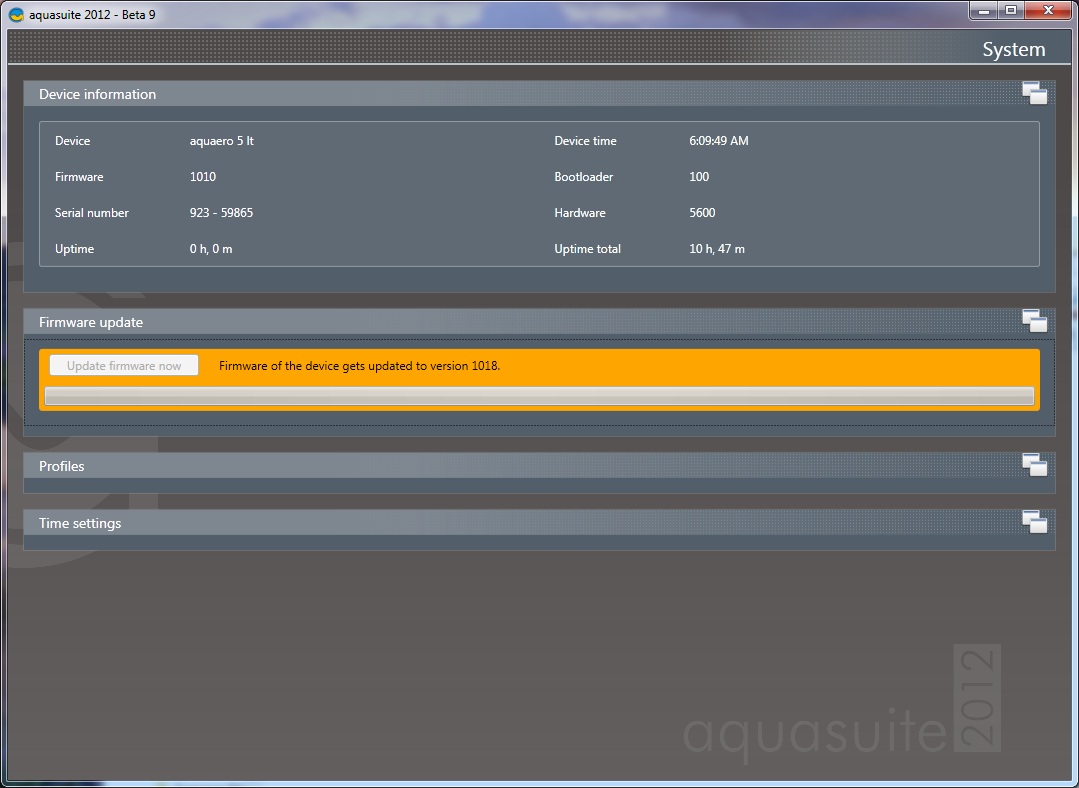

The aquaero 5 LT info. When I try the firmware update it appears to start but then just sits there without any change. I've tried running aquasuite with UAC disabled and with explicit administration prvileges:
-info.jpg below

I tried Shoggy's method for full firmware erase/restore and it has worked. I have the readings now, just struggling on getting the fan control to work the way I want it to...
To do a full reset follow these steps:
1.) Turn off the PC and remove the standby power if you are using it.
2.) Remove all sensors from the aquaero.
3.) Place four jumpers on the temperature sensor connectors 5 to 8.
4.) Power on the system and after a few seconds you should see a recovery mode screen in the aquaero display.
6.) Turn the PC off and remove the jumpers from the aquaero.
7.) Start the PC and use the latest aquasuite 2012 software to flash the firmware onto the aquaero. It should perform a restart afterwards so you should see the regular screens now.
8.) Turn off the PC, connect all sensors etc. again and start the PC.
