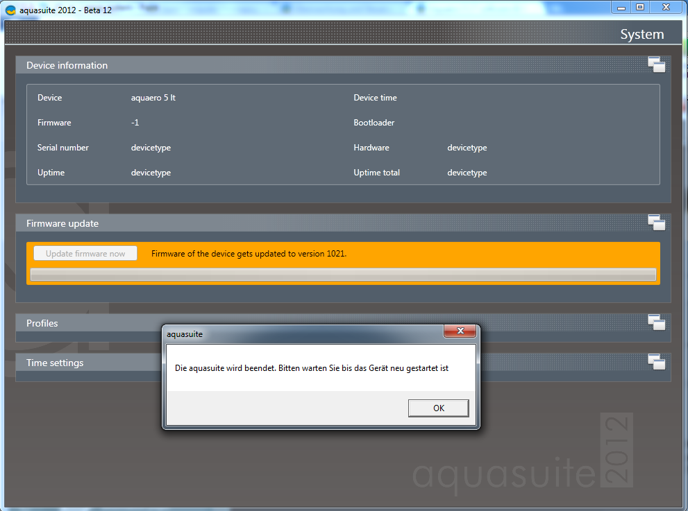

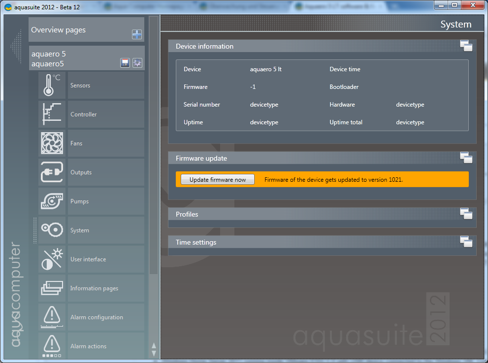

  • when i go to the System subpage, it says Device "aquaero 5 lt", Firmware "-1" and the following items are filled with devicetype : Serial number, Hardware, Uptime, Uptime local.
  • when i press the "Update firmware now" button (next to it is the label "Firmware of the device gets updated to version 1021.") only the following thing happen - a empty progressbar show up and a popup dialog which says "Die aquasuite wird beendet. Bitten warten Sie bis das Gerat neu gestartet ist". It happens even if i start aquasuite as Administrator.

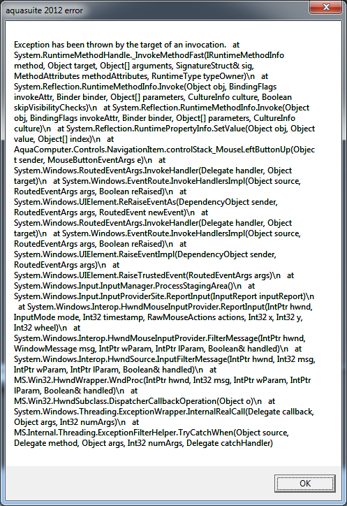

  • even before and even after pressing the Update firmware button all i get from the Sensors and Fans pages are .NET crashes. All other functionality to these two things (fans and sensors) on other pages results in crashes as well.,

After booting in recovery mode :

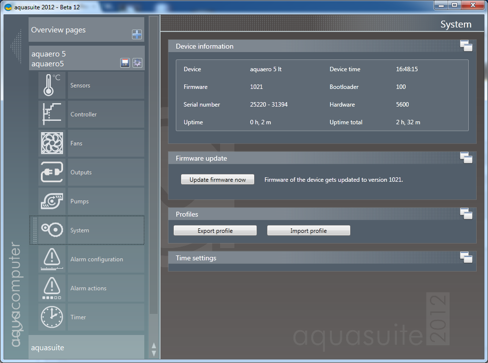

After following restart :
And seems like it works well (it shows fans speeds etc).
