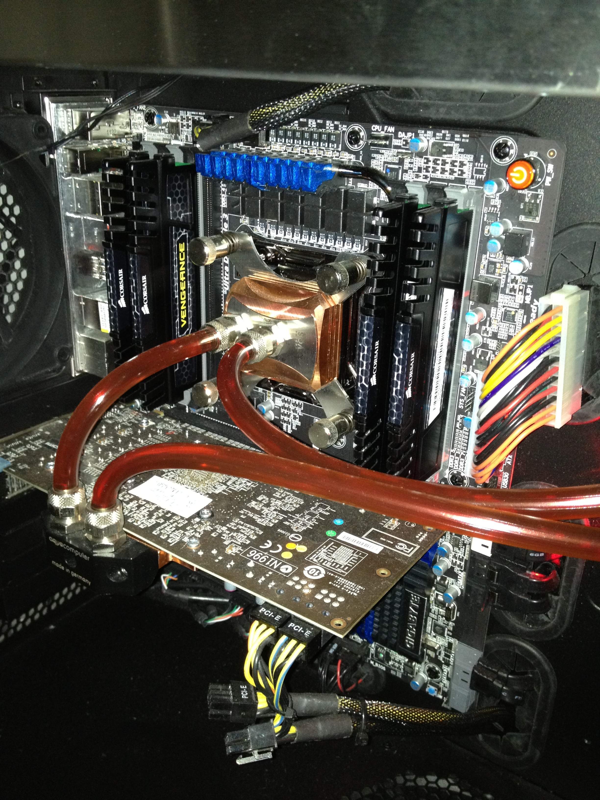

Hi all.
Could one of you gurus tell me if the following watertemp is normal?
My setup is the following:
- Gigabyte X79-UD5 with an LGA2011 i73930k running at 4.3 GHz
- MSI 6870 GPU Watercooled
- 32GB Corsair DDR3 Mem
- Aquero 5XT watercooled
- Airplex modularity system 360 to cool the CPU, GPU and the Aquero 5 XT
- Build in an Corsair 800D case running OS X Mountain Lion
I have set the rig up as follow. Radiator -> Cpu -> GPU -> Aquero 5 XT -> Radiator The fans are on top of the Airplex sucking the air out on top.
All is working well i think (hope).
My question is: The Ambient temp in the room is 29c and i'm doing some video converting and watching my watertemp reaching 53c!! Is this ok or should i be worried?
System feels stable and i can do other things while converting no problems till now. But i would really like to now if this is normal.
»FreshWater« hat folgende Bilder angehängt:
Dieser Beitrag wurde bereits 1 mal editiert, zuletzt von »FreshWater« (24. August 2012, 23:11)

First take a look at my build see the 2 pics. Sorry for the quality.
Pretty simple and straight forward i think.
I'm now gonna try and run the systems without the side cover see if that makes a diff.
Will report the result.
Flow rate is round 106 l/h
tubing is 11/8 mm

Today i took the systems apart to turn the fan to blow outside in. I even replaced 2 connectors with elbows just to be sure i had no bind in the tube. Well sad to say my fear came true. The inside temp got so high that the front of the Aquero 5xt came off. The glue heated up. Man i'm going nuts here. My water temp is around 52.5c and the inside air was on its way to 45c when i removed front and side panels. It looks to me like the 800D is very airtight or something like that. I just don't have enough airflow to use my setup like this blowing outside in. My flowrate has dropped from around 106 l/h to around 76 l/h but i guess that has to do with the 2 elbow connectors. They r coming out. Anyone ideas to help me out?
Regards

Update.
What have i done today?
- I turned the fans to pull hot air from the radiator outside the case. Blowing inside the case was way worse for me.
- I added 3 Noctua NF-P12 in a push / pull combination.
- I applied Gelid GC-Extreme Thermal Compound to the CPU.
- I replaced to systems outlet fan with an Noctua NF-P14 FLX and it is an inlet together with the bottom fan now. So all the hot air is leaving the case via the radiator.
- Had the system on the side running as suggested in this post. I did see a few bubbles
The above actions resulted in my cpu dropping from 72c to 68c and my water temp from (the highest i got was 55c) to 48.6
My next step will be to contact shoggy when he's back to talk about my pump. Reading all the feedback i got i'm starting to think something is wrong with my pump. I do hear it. I do see the readout of the flowmeter and i dit see the fluid running (or is it crawling) through the tubes. But according to the feedback my flowrate isn't good enough.
Thanks so far for the feedback and advises. They've been a great help. Please keep them coming.
I will let you guys know how this all ends.
Regards
