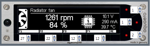

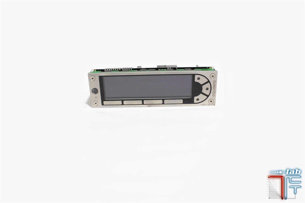

Hello to all,
I have aquaero 5 XT, but I always had problems with sensitivity touch screen buttons.
Especially the enter button, even if set to 1 sensitivity is too sensitive and sometimes turns on without touching it.
In a review of Italian I saw a new front panel with aluminum plates that avoid the problems of sensitivity buttons.
http://www.coolingtechnique.com/recensio….html?showall=1
I ask if you know something, I have not found the new panel in the Aquacomputer.de site. I would like to buy it.
Thanks
Fabrizio

My PSU is a new Enermax Platimax 80Plus Platinum - 1000 Watts, and should be fine. I therefore ask if ordering a new face plate as indicated by Jakusonfire, I get the new version with the aluminum plates, because in the picture of 'address
http://shop.aquacomputer.de/product_info…roducts_id=2893
the face plate is smooth without plates, and equal to what I already have.

That article you linked to is pretty old now, I guess they might have put the aluminium plates on the old front panel as a temporary measure til they worked out a fix. The new panels do not have plates on the buttons.

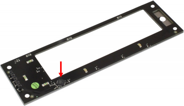

jonny12
Mittwoch, 10. Juli 2013, 17:47
I solved with the new panel that mounts the chip 121. My panel was an older version with chip 084.
The chip of which I speak is what you see in the picture.
Fabrizio

lapoune
Donnerstag, 11. Juli 2013, 16:47
I contacted aquacomputer about this and they're sending me the new front panel assembly free of charge even though my unit is well out of warranty (I have one of the first batch).
So major props to them and the great service. :thumbup:
