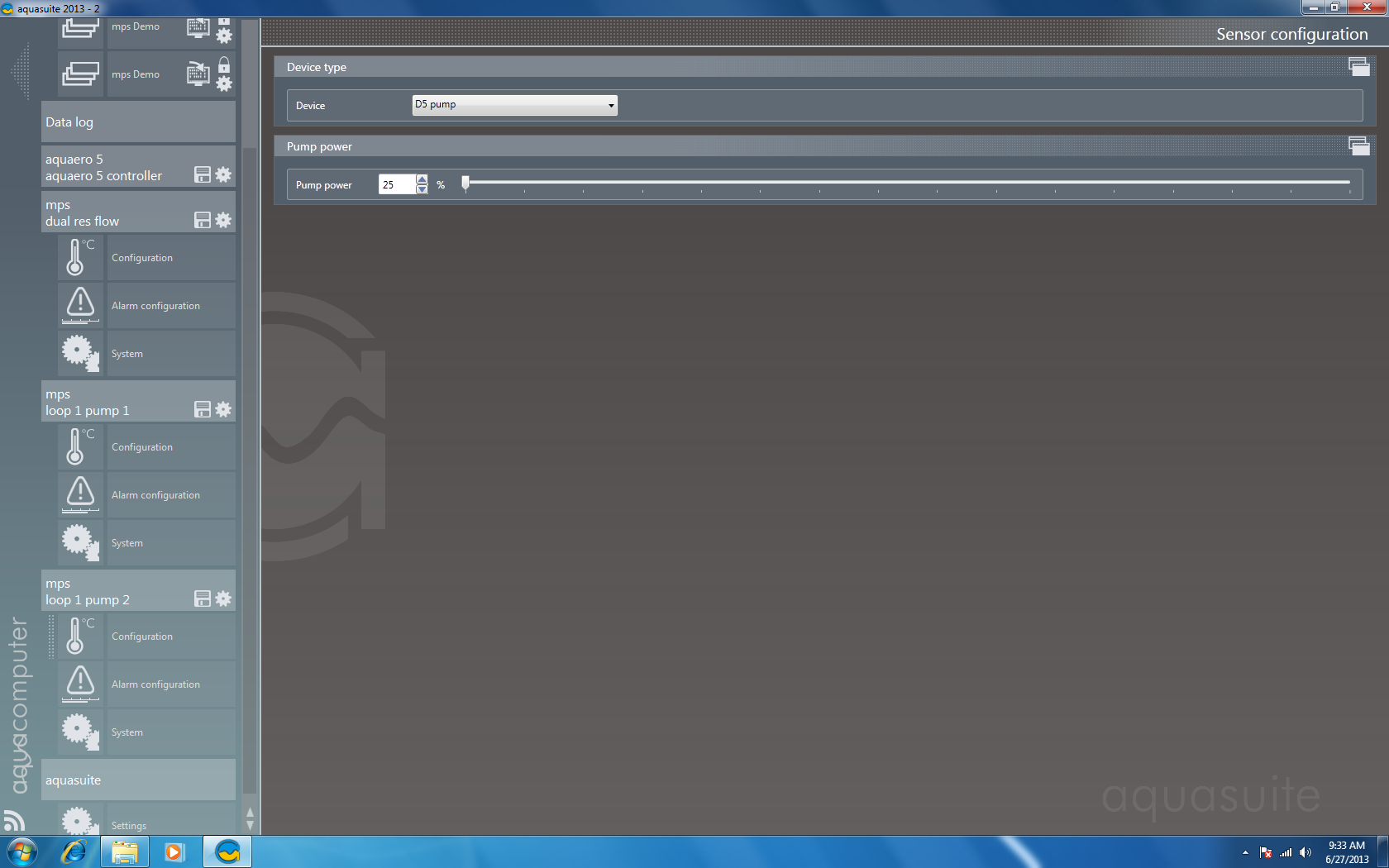

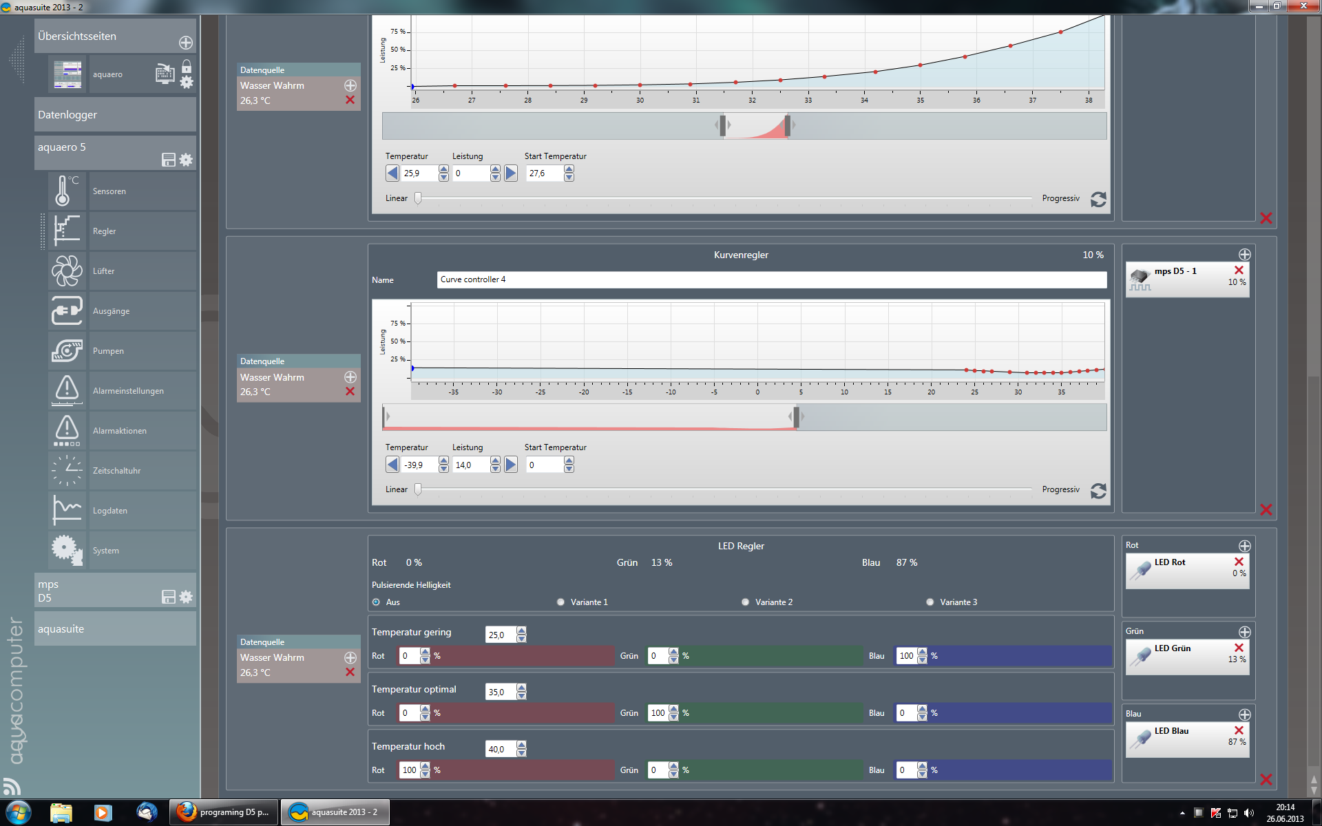

Just noticed your picture that you had one d5 pump there witch in the curve was labeled d5 - 1. When I created my curve I also had d5-1 but also some wierd number like d5-14 I believe but I only had 2 options in the output curve to choose from. Looking at the pumps while they still conected to usb cause I don't belive you can look at alarm settings without usb connected. But one d5 pump would show a lower rpm while other was maxed making me belive there is a problem or one pump isn't controling or isn't in the curve.

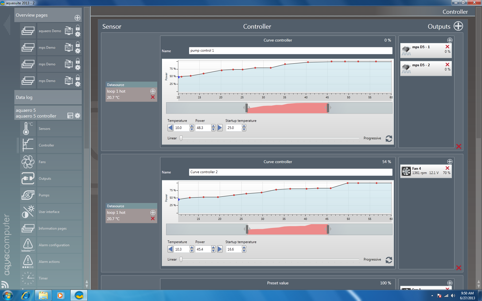

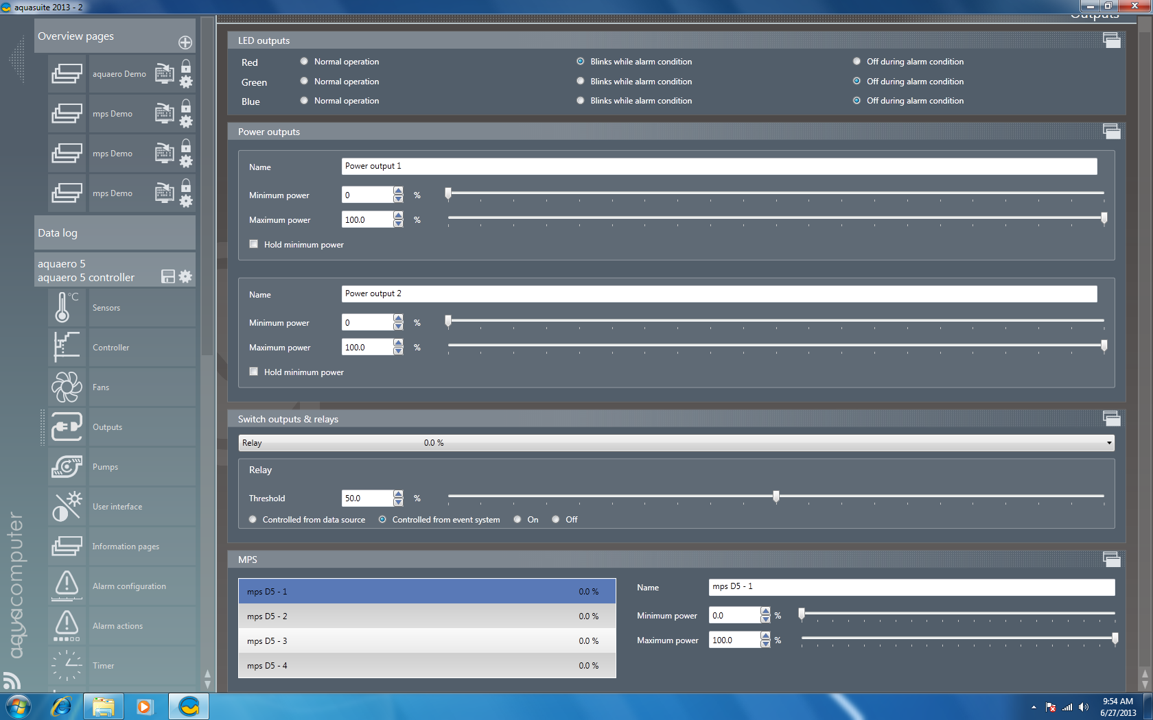

here are some pics of my problem. everything seems set up right but as you can see the controler curve isnt showing any output to the pumps. only 0% unless i go into the outputs tab and increase the minimum output of both pu8mps manually witch with the curve iwouldnt think i need to do. am imissing something?

cpachris
Donnerstag, 27. Juni 2013, 17:39
The start-up temperature on your curve controller is set to 25c. No power will be supplied to pumps until temperature exceeds 25c. Lower this.

opie12
Samstag, 29. Juni 2013, 02:14
I changed the startup temp and it started controling. Thx for the help
cpachris
Samstag, 29. Juni 2013, 18:02
you bet. that setting is most useful if you want it to cool to a certain temperature, and then stay off until temps rise back above a certain level.
