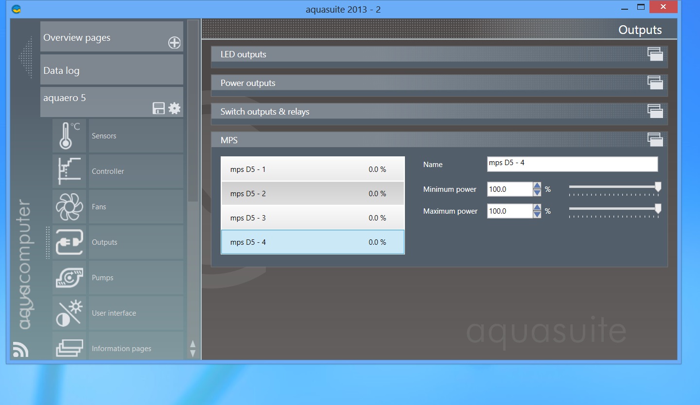

first pic after connected USB Pump to Motherboard.... Can't see "MPS" on main menu tab.

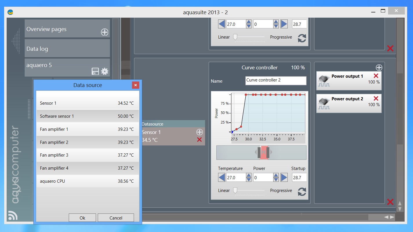

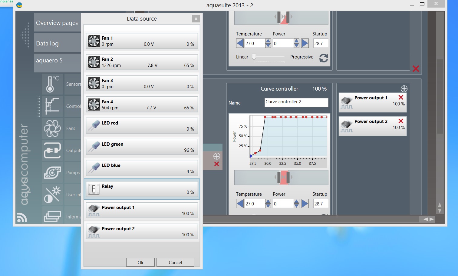

Then connected aquabus between pump to aquro 5 XT (aquabus High port).. I can see as pic below it's show 4 MPS! but 0% power use. I have adjust the power min & max to 100% all MPS.
and then go to aquro control, I try to add MPS in data source but can't find it as below pic..
.....meaning my USB pump already gone ???

I see what you mean..... Your not getting anything of the D5 showing up?........ The only thing I can think of maybe to double check (although I suspect you have already done this) is to double check you have the USB cable connected the correct way around on the pins especially on the motherboard end (some people have had the USB the wrong way around on the motherboard).....
BUT!!!!.... Looking at your screen shots, It does look as though, for what ever reason your pump just isn't communicating with the Aquasuite or Aquaero 5?..... I think you may need to contact Aquacomputers Via their web site for either further advice or set up an RMA for the pump, Because it looks to me as though something is very wrong somewhere & Suspect it may well be a faulty PC board in the pump....
I think you said earlier that the pump does work (as in, it is pumping when you power it up...... You just don't seem to have any communication between the pump PC Board & either the USB or Aquabus!!!.... & provided you have everything connected correctly it should communicate through one or the other of those..... & as it's not I suspect there is a fault I'm afraid :( ...

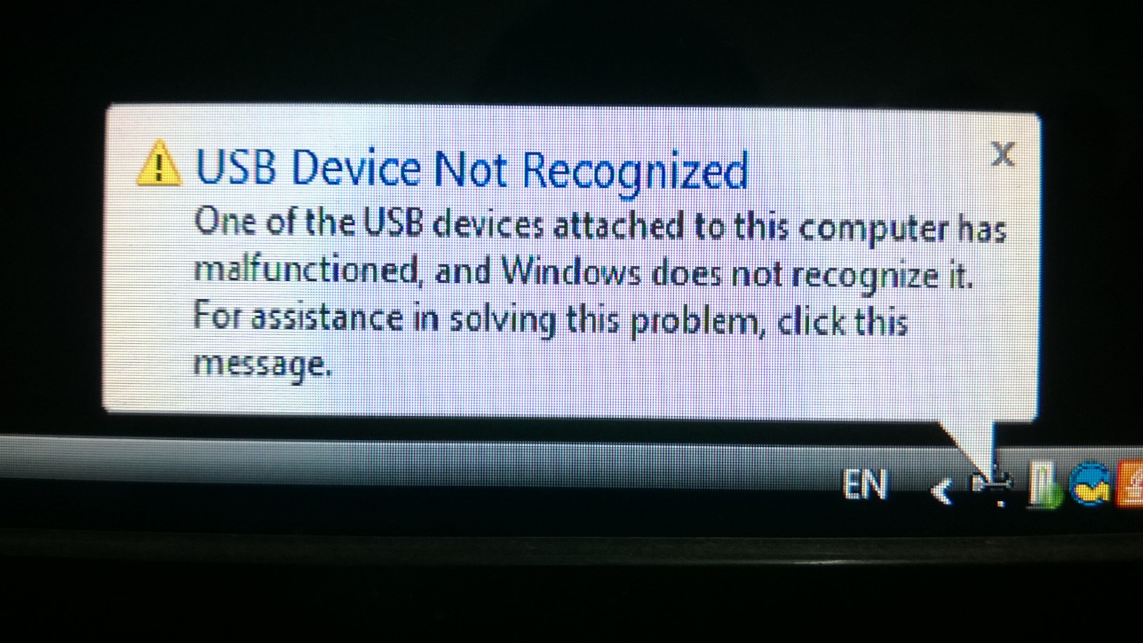

Hello Namron,
Some update... look like not good ;( ;(
i try connect the USB cable between Pump and Motherboard..... then i saw this popup (as picture)
this popup can prove usb pump not working ??
however many thanks for you help....
