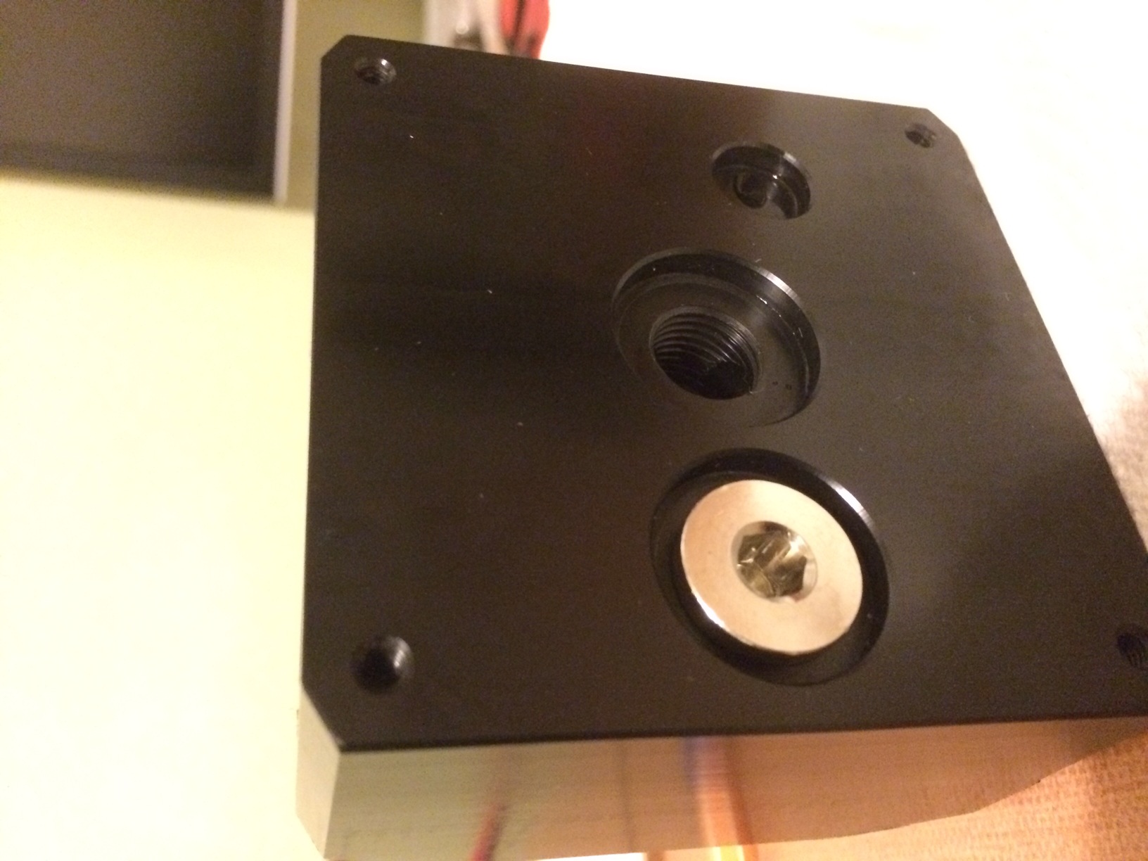

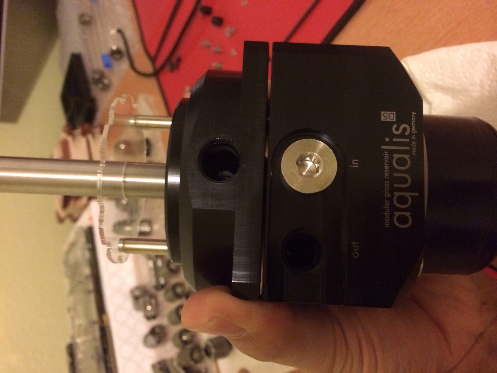

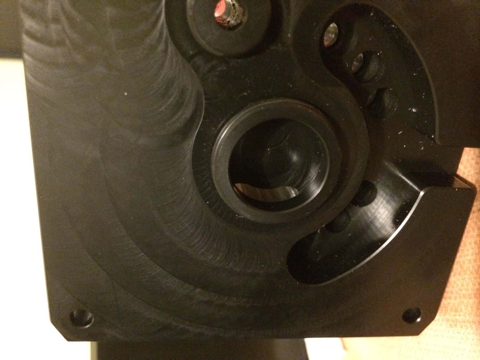

Siopao
Mittwoch, 12. Februar 2014, 03:47
Here is a photo under the base for the pump adapter. You can see here the opening to the reservoir.
This is a photo of the pump top adapter that holds the D5 pump. You would just need to plug the hole I have plugged here.
This is with both the res base and the pump top adapter. I didn't bolt them together but you get the idea. You need to just plug the IN port on the D5 pump top and use the top inlet. You can use the normal OUT port on the aqualis D5 pump adapter.
Hope this helps out!

Shizbazki
Mittwoch, 12. Februar 2014, 03:52
Finally thanks for your help, in trying to explain things
So let me get this right.
In the third photo the water enters the top port above the tops IN port (blocked off with silver plug), water goes up fountain pipe and cascades down into a hole at the bottom of the reservoir which then goes into the pump which then kicks it out the out port.
Dieser Beitrag wurde bereits 1 mal editiert, zuletzt von »Shizbazki« (12. Februar 2014, 03:55)
Siopao
Mittwoch, 12. Februar 2014, 15:26
Exactly! :thumbup:
