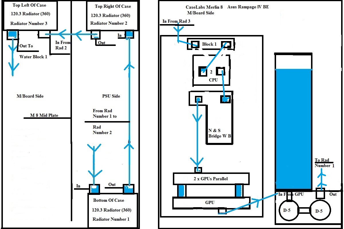

Did a quick sketch up thought this might help
»Larry L« hat folgendes Bild angehängt:

I have a similar layout. You are going to use the Aqua Suite software, for hardware temp monitoring I would use HardwareInfo64, this gives you all the chip and board temps.
Temp sensors on the rad inlets and outlets. I use these .
"Can I run the two pumps and 17 fans direct from the Pro 6 using fan
spliters ? If yes do I need to use the water block on the Pro 6?"
Yes, run the pumps with Aquabus/usb, 17 fans across 4 fan headers is fine. Don't think you'll need the water block but those high ambient temps are a monkey wrench on predicting what you are going to see for loop temps. My loop seldom reaches 32C, that takes 100% load for a half hour or more.
"How do you connect 2 x D-5 Pumps with USB to the Pro 6 it has one USB? "
I use a nzxt IU01 usb board. Using USB assign a address to each pump and then run with Aquabus. Use a Y cable for connecting the 2 pumps to thwe Aquabus header on the AQ6, or add the AQ RealTimeClock module that gives you 2 Aquabus headers.
"will push pull fan configuration be required on the radiators?"
With those high ambient temps it sure wouldn't hurt. I'd work at getting ambients down to 25-28C max. 20-23 is even better.
"Trying to keep the build quite will the 1400 RPM fans be ok in a push configuration?"
With those hig ambients I don't know, if you are 22-23C you can run fans under 800 rpm and have great cooling.
"Does 120mm x 25mm fan shrouds help that much?"
I've never seen much.
"Is two D-5 Pumps in series necessary for this loop with one AquaComputer
Qualis Reservoir? The reason for 2 pumps in series in case of pump
failure and increased volume and pump pressure running the pumps at a
lower RPM to equal the same pump pressure with one D-5 pump. "
I would run 2 pumps, better flow rate and redundancy.

The AQ 6 will control the speed of the pump if the PWM connector is wired up the same as this DDC PWM PUMP I'm using at present to test e.t.c.... IE: If you notice, this DDC Pump has two wires going to the PWM connector 1 x RPM Speed the other is for PWM Speed Control....
Not sure why or how you would connect fans to a USB Expansion Board?? (that you linked to?)...... Fans don't run off a USB???
Also that NZXT USB Expansion Board (you linked to) is supposed to be powered Via the PSU & not the AQ 6???...
All 3 pin fans are voltage controlled (Only 4 pin Fans can have the PWM function only.... So you connect the fans to the AQ 6's fan headers (I use multiple 3 pin fan cable splitters to connect multiple fans to a single AQ fan header) & the Aquaero/Aquasuite then controls the speed of the fans Via the voltage..) This has always been the way with 3 pin fans??.... The Aquaero reads the fans speed direct from the fans not the Motherboard Bios??? (unless you have fans connected through the Motherboard headers??)...
Unless I'm miss understanding what you mean or are trying to say?.... But that's how I read it ;)
N.

Hiya Larry.. No worries it's easy to get confused with it all & your eager to get things moving along :) ...I would say though...Take a step back & Take a deep breath, relax but most importantly take you time....
You have linked to a DDC pump top... But say you are going to use D5 pumps??...... DDC & D5 pumps are very different pumps to each other mate..... So that pump top you linked to is for the Laing DDC series pumps & not for D5 series pumps...
So if your actually going to be using the D5 pumps (great pumps & ones I would recommend) you will need to get a top that is for the D5 pump.. OK.. :thumbsup:
1 & 2. Which ever pumps & tops you go for you should get all the mounting equipment you require :)
3 & 4. Yep the pumps are mounted on the back & if you look closely those wires your talking about are from the two DDC pumps they have attached from that link picture...
Also the Aquabox you linked to is a bay mounted Reservoir...
1. This Aquabox is for one loop & you just connect your tubing from the Aquabox to your Pump (or pumps) your tubing then goes to the various blocks & radiators you have in your loop, Your tubing then returns back to the Reservoir....
2. They are probably running two loops??... (I haven't watched the video myself but that's the only reason to have two reservoirs)..
No idea about the filters I'm afraid.... I've never used any filters & never seen a need for filters in a PC cooling link.... but that's just my personal view on it ;)
NO MPS DEVICE (pumps, fill level sensors, Flow sensors e.t.c) Connect Via there USB to the Aquaero...... All USB connection are for that Device to be connected to the Motherboard USB Headers!!!...
The Power Adjust's only have one USB connection not two & these also connect to the Mother board USB headers..... although I don't think you will have any need for using the power adjusts at all...
1. The USB D5 pumps connect to the PSU for power & connect to the Aquaero through the Aquabus connection...
You have no need for a Multi switch from what I can gather or the power adjusts... Save your money... I've never used or had any need to use a Multi switch... But it's up to you what you buy, but I have no experience with those Multi switches at all I'm afraid...
Have a look HERE I've done a couple of reviews & guides for the Aquaero 5 but most of the setting up with the AQ 6 is the same, So give my guides a good read & you should soon begin to pick it up of how to connect what & where e.t.c....
I think I've just about covered what you have asked about here for now & have to go to work now (am already running late ;) )..... But any way give my quick guides a good read which should & will hopefully help you out with any further queries you may have..... :thumbsup:
Take your time.....
All the best
Norman

DDC pump top correct was curious about that particular pump top and pump performance compared to the D-5s. The last two builds had the same pair of D-5s ran 5 + years 24/7 never failed. Time to replace them still running strong and silent. Getting close to the 50,000 hour mark if not over. Did not run a fan controller and connected the PWM from the pumps to the CPU headers then power from the PSU.
Correct thinking they running two loops. Decided to use a Tube Res and keep the res out of the 5.25 bays. On a single loop with a mod top only and 2 x D-5s only need one res.
will read the forums and your reviews :thumbsup: that is my understanding the 5 & 6 have pretty much the same connections.
Hard not to just place the order do not like throwing money down the toilet sort of speak by purchasing hardware not required need to Keep It simple Stupid. :rolleyes: some times that is easier said than done LOL.
